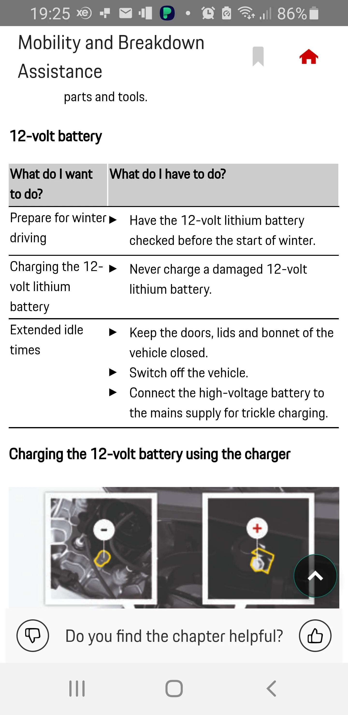

12V also runs all the electronics, including remote app access, probably some parts of battery cooling/heating system, and dashcams. The question is what if 12V needs topping off and you are not pre-heating.
11,078
6,858
Yes indeed but in the context of preheating.
Same answer. If connected to an EVSE it will trickle charge should the 12v start to drop.
I think there is a reference in the manual:
Porsche Taycan Pre-heating function will drain battery? Screenshot_20221205-192518_Porsche Good to kno
