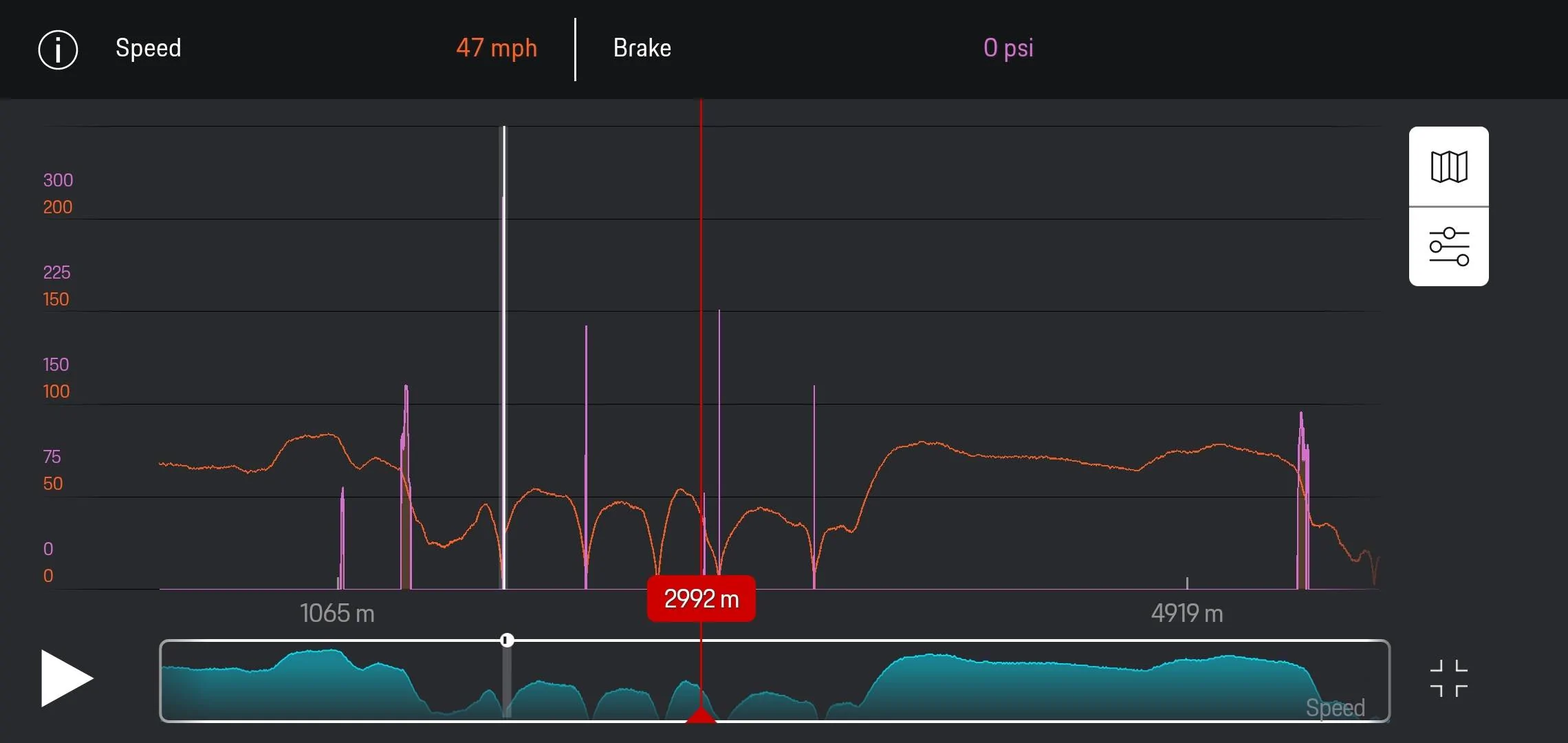

Dave this might provide you some insight into how this system works in preparation for your lunch. It's involved way more than I think you're aware of.
This is a quick 6 minute drive I just went on- onto the freeway, braking in traffic a bit, and off the freeway. 5 or 6 braking system pressure events (mechanical braking by your own acknowledgment) within 6 minutes, none of which were anywhere near threshold braking, and only one of which I believe maxed the regen.
I tried to tie video to it too so we could see the dash with speed and regen but it's kinda clunky unless your car is set up better.
You wanted data....... there's your data.
Porsche Taycan PSCB Brakes Screenshot_20220604-121500_Track Precision
That graph would mean a lot more if it also showed longitudinal acceleration since power is a function of v and a.
If you really want to reverse engineer the peak regen you can calculate the power just before the hydraulic system builds pressure by P=mass*accel*velocity.
You will find that the regen power varies alot before the friction brakes start building pressure. So you are right. You could also see the difference between a jab of the brakes, where the friction brakes are engaged immediately, or gradual application where regen is maximized. So many factors, as Dave’s post also pointed out.
*edit* It should also be pointed out that max regen of 265kW can only be achieved at speeds greater than 67mph, assuming they've designed it to peak at 0.38g deceleration. I think I saw that quoted that "up to 0.38g" can be attributed to regen. At lower speeds to reach that peak regen power the deceleration by motor only would have to be much higher. This would explain why it's hard or impossible to max out the regen meter on the dash at lower speeds (also assuming the regen meter scale is fixed at 265kW max).
Am I interpreting this graph correctly as follows? You did six full stops, and in four cases all of the braking was regen except for the very end of the stop, which was friction braking. In the other two, it was entirely regen.
Then you had three other braking events, all of which were very brief and the friction brakes engaged for a very short time.
