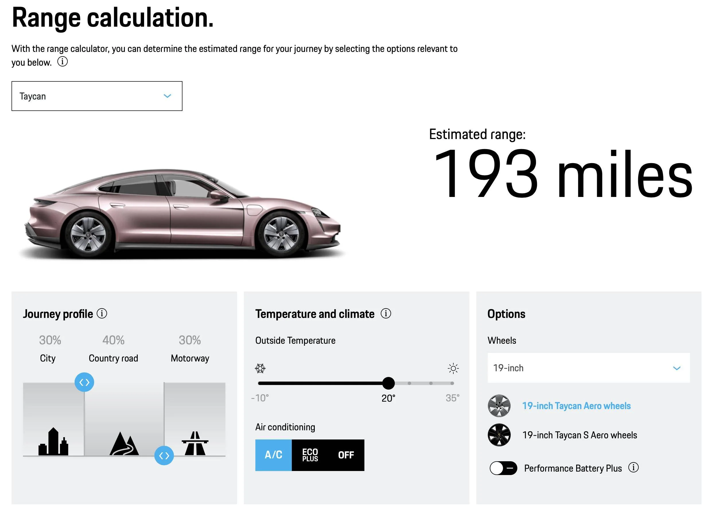

Gru
Aug 21, 2022
424
585
Taycan Sport Turismo - 20"
range
You'll find all parameters on that link: model, wheels, outside temp, AC, highway, PB+ or not, etc.
the estimated range is pretty accurate
Porsche Taycan Range issues Screenshot 2023-11-02 at 12.47.55
