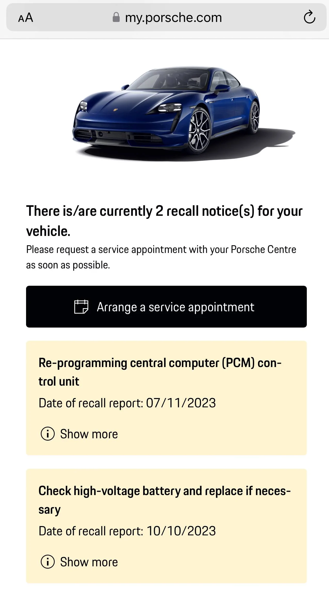

Anyone have the detail on this please

It is likely the WPN8 recall update that appears to be PCM bug fixes like the black spinning cursor of death and navigation hang ups. There are lots of threads elsewhere about the details.
I booked my Taycan in to RPG Reading for this and the APB2 HV battery seal recall yesterday and was given a date towards the end of January as the first possible date with replacement transport for this 2 day session (assuming it doesn’t actually need a replacement HV battery). Seems like neither are safety critical And I guess PRG Reading are kind of busy in the service department right now.

I was waiting until I got the UK version of “free HV heater replacement” our cousins over the pond are getting.
Then I could call ‘bingo’ 🎫
….still 2 out of 3 ain’t bad 🤣

There is a recall for 22k taycans from 2020to 2023 for pcm / blue spinning wheel and pcm going blank on the screens. Had my done this Monday on my 2023 ct4s

Interestingly I’ve just got the WPN8 PCM recall come up on my less than 1 month old MY24 GTS ST.

Same foe me, just waiting for Preston Porsche to confirm booking. Online app gives 1.5hr time slot - gives me a bit of coffee time and chance to look around the dealership owners collection of 911’s…………
How long did it take?
Maybe useful for others booking cars in now.

Took About 1 . 5 hours . I left car there and they gave me a loner car. I was the first recall they did. So far it is working properly.
Mad that I've some dealers saying they need the car for 2 days...and yours is the first one they do and it only takes 1.5 hours.
