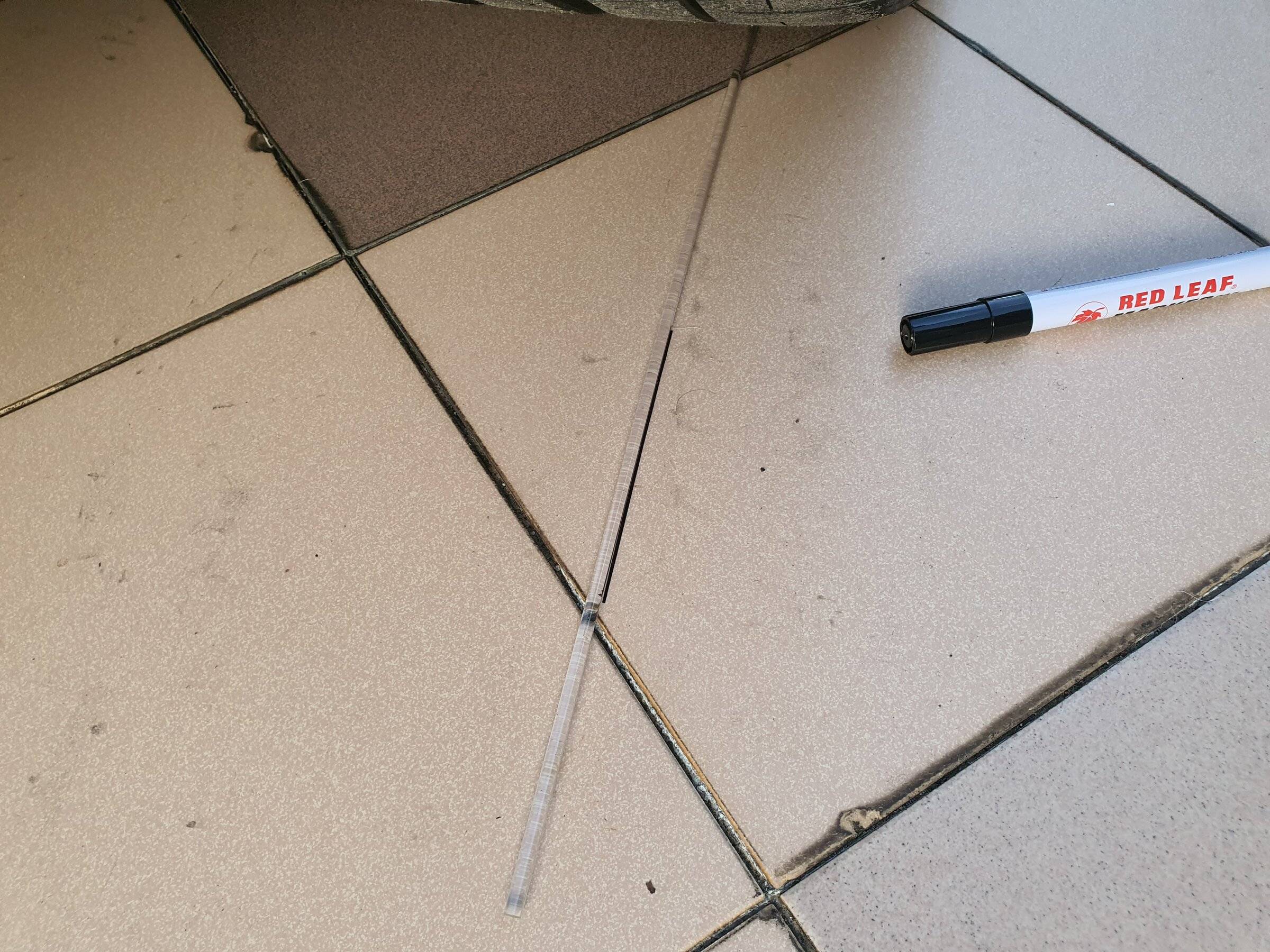

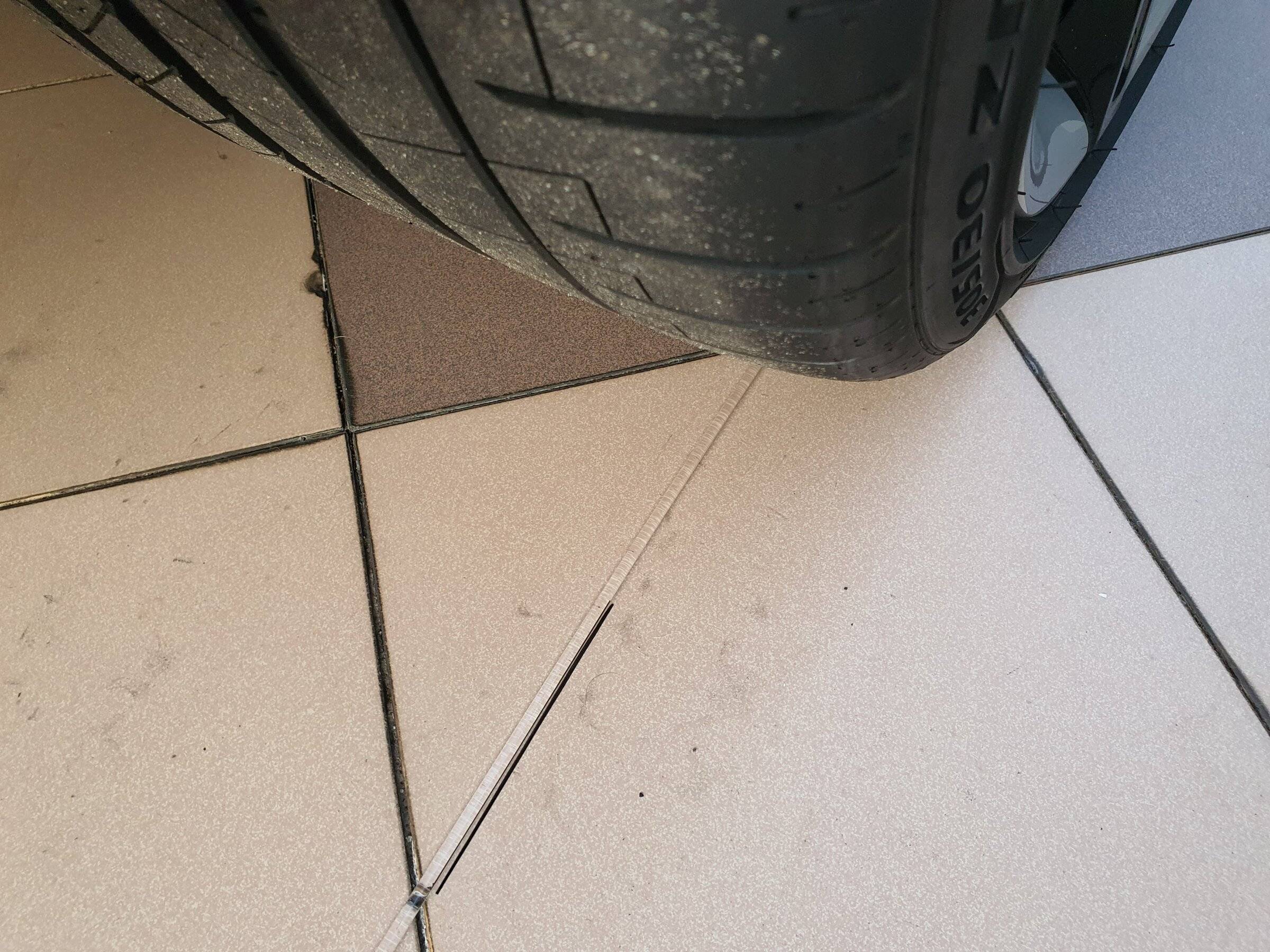

even though "My Porsche" lists the option, I am not convinced folks. I just did another test: With the car in reverse, I aligned tge front and back wheels straight.
Porsche Taycan Rear Axle Steering - how to confirm it's installed / working? 20220110_183224
the acrylic rod fits perfectly in the tyre's slot
Porsche Taycan Rear Axle Steering - how to confirm it's installed / working? 20220110_183248
I then used a marker to trace a line
Porsche Taycan Rear Axle Steering - how to confirm it's installed / working? 20220110_183404
now with the car in reverse, I turned all the way right
Porsche Taycan Rear Axle Steering - how to confirm it's installed / working? 20220110_183410
no changes whatsoever ..
I am sure there is another explanation than the one in my head right now!
cheers.
cheers.
Good test!
One thing, car looks to be raised - if it is can you set to Normal height and repeat the test as it could be anything other than normal height disables RAS (clutching at straws)?
I'm still in the 'uncertain camp' that RAS is present / works on my car - your test is starting to cement this thought!

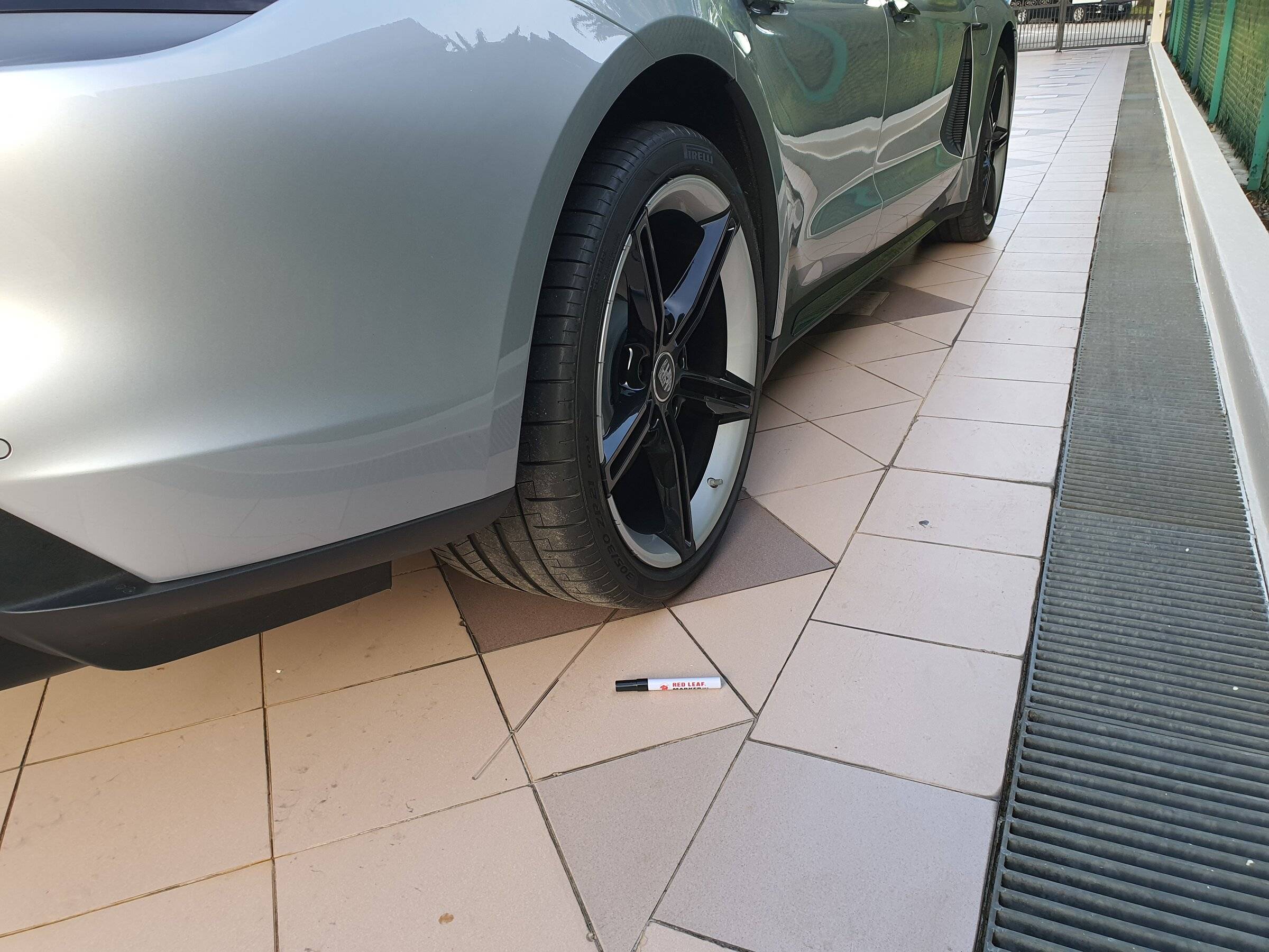

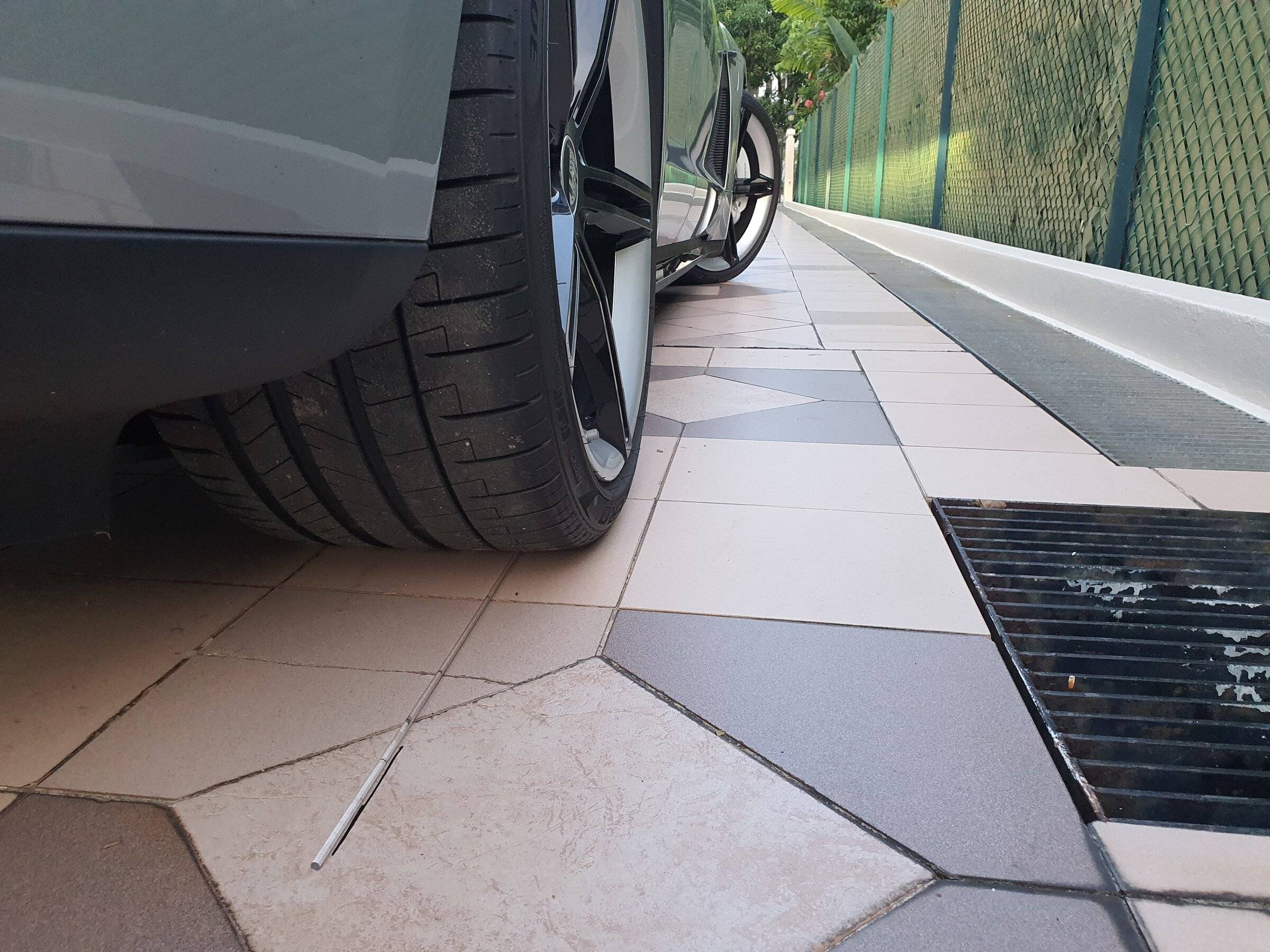

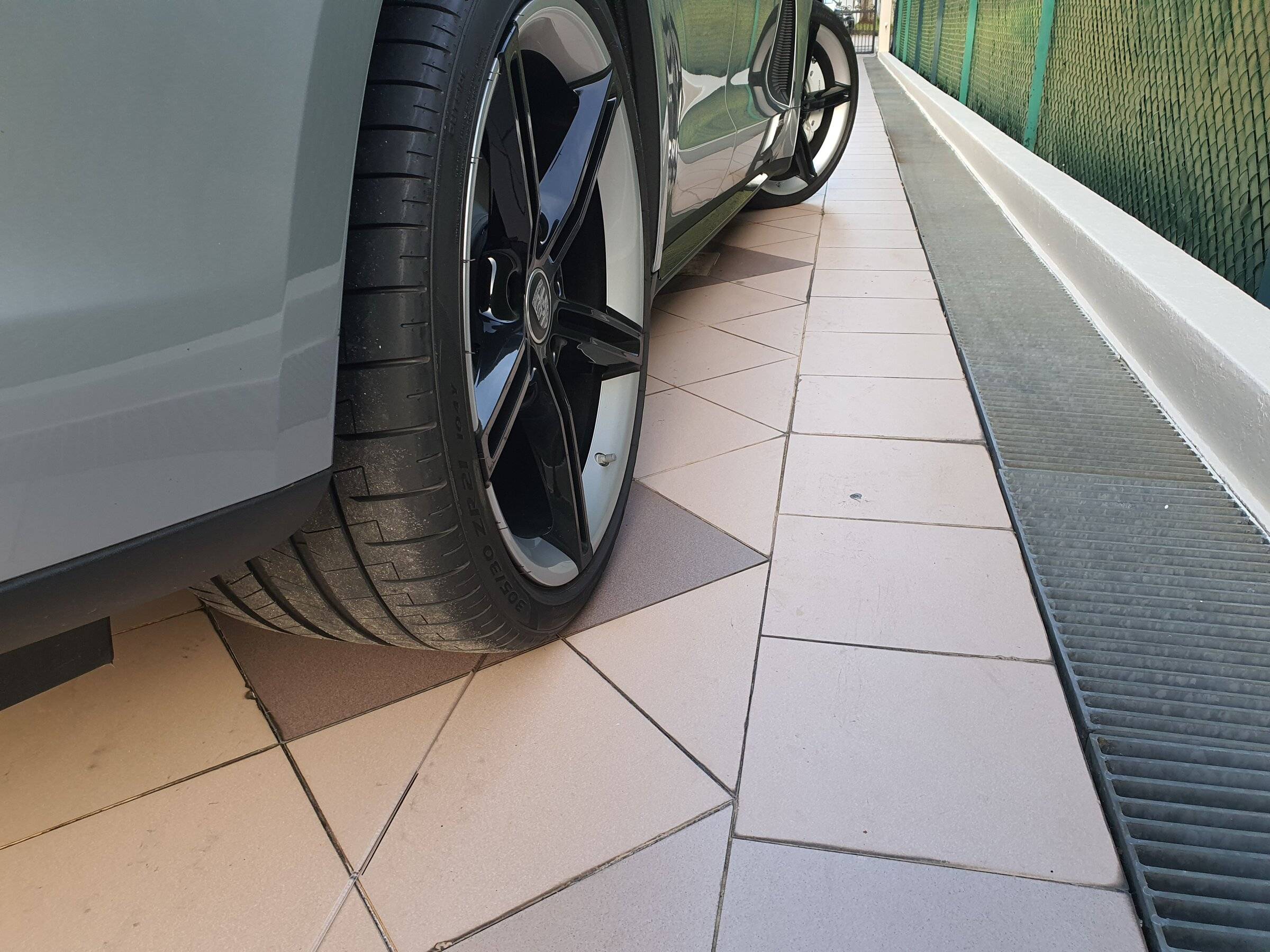

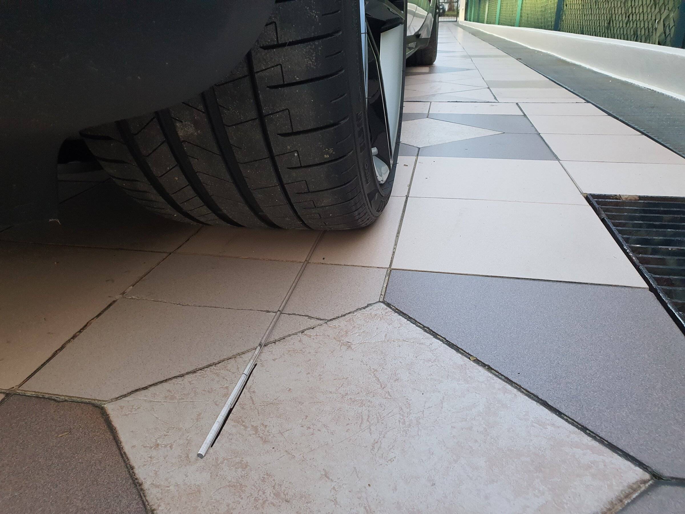

done again with a lowered chassis, same result:
Porsche Taycan Rear Axle Steering - how to confirm it's installed / working? 20220110_190709
Porsche Taycan Rear Axle Steering - how to confirm it's installed / working? 20220110_190753
