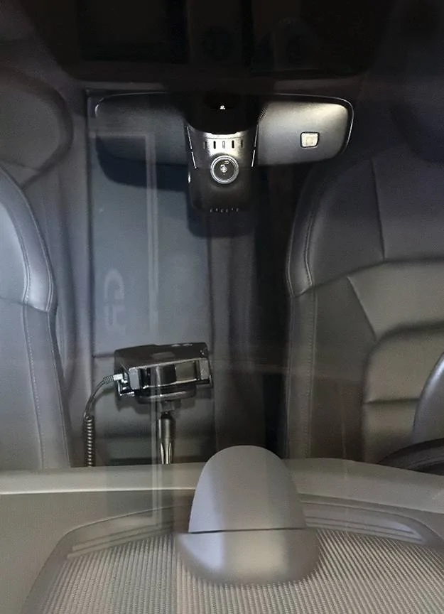

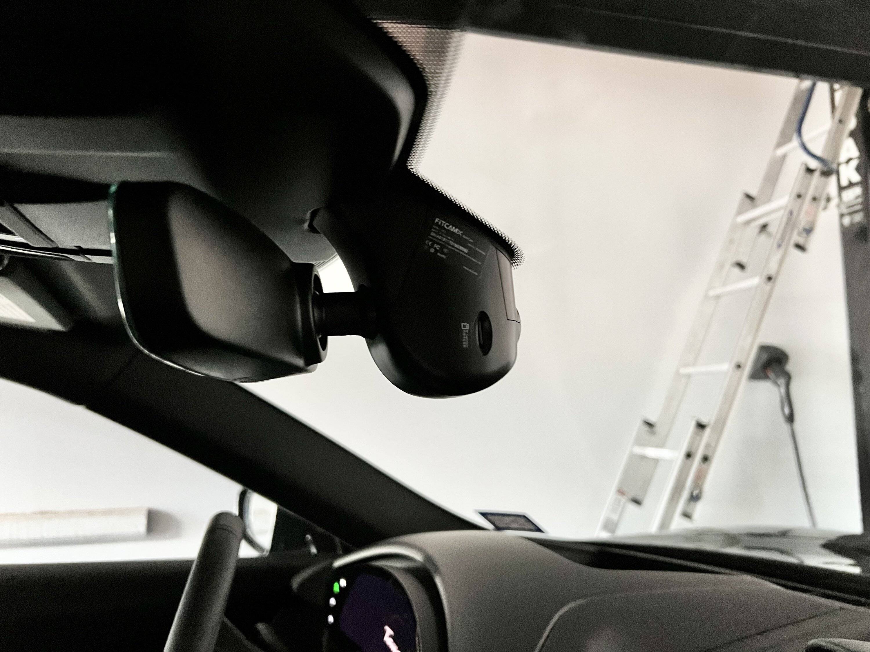

Incredibly well integrated and powered from source in replaced console housing part above mirror - by far the most OEM look available - Porsche should just buy the patent :)!

Are you sure they were talking about a Taycan? I fitted one last week and loads of people here have, and it's just plug and play.
The only issue I had is that I found it hard to pop the middle section back on, and there is still a slight gap if you look closely behind the mirror. I need to pop the big panel and that one back off and I think move the wiring slightly. May or may not bother as you have to bend round and look for it to notice!

I'm based in the GTA in Ontario, and around ten different installers straight up refused to hardwire a dashcam stating that it would be either bad for the 12 V battery, blow a fuse, or is somehow bad for the car. I find it hard to believe that when so many people already have hardwired dashcams and don't seem to have major issues. Any recommendations on where to get a dashcam hardwired in the GTA?
I installed a FitCamX in my CT4S in about 20 minutes. Easy breezy and the app works seamelessly.
