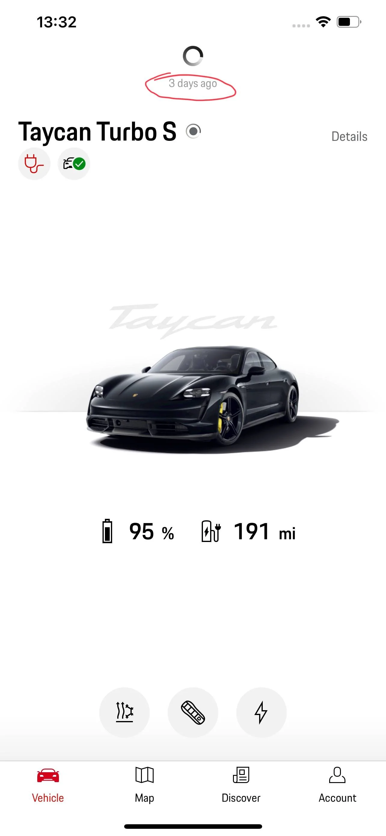

I have not been able to connect to my car since last Friday, but I have no LTE connection (= sign with diagonal line through it in PCM) so not sure whether our issues are related.
Porsche Taycan Remote Climate Function – This function cannot be currently executed. Please try again or contact Porsche Centre IMG_1286

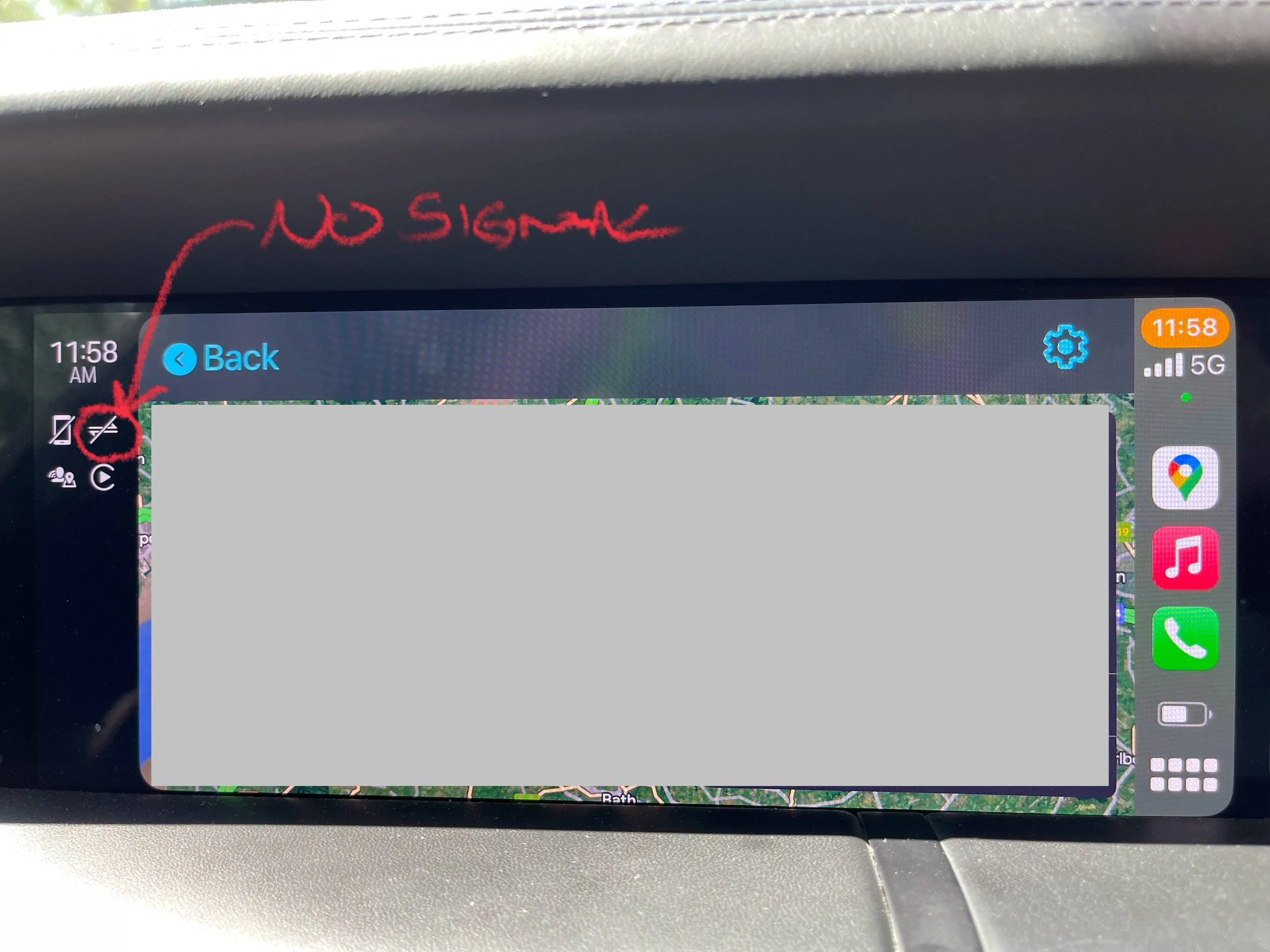

Is anyone else having the “no LTE” issue that I have been seeing intermittently for the last 3 years? My data connection has been working since I had the OTA module replaced a couple of months ago, but the “no LTE” issue reappeared last Friday.
