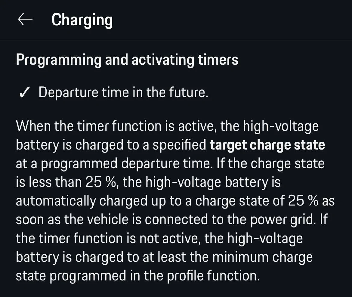

Manual says timer min is 25%.
Porsche Taycan Remove the 25% minimum charge IMG_8801

Its the ‘home’ profile that demands an immediate charge to a set minimum charge level…the thinking is that you always have this minimum charge in your car if you have an emergency need for a trip out. Deleting this profile should stop the car charging as soon as you plug it in.
you need a location - independent profile to avoid this, which for some reason can only be created in car, not via the app.
The General Profile is location independent and can be configured via My Porsche App BUT also has a predfined minimum of 25%.
Not looked at creating another non location based profile via the PCM but sounds like it will do the job.
