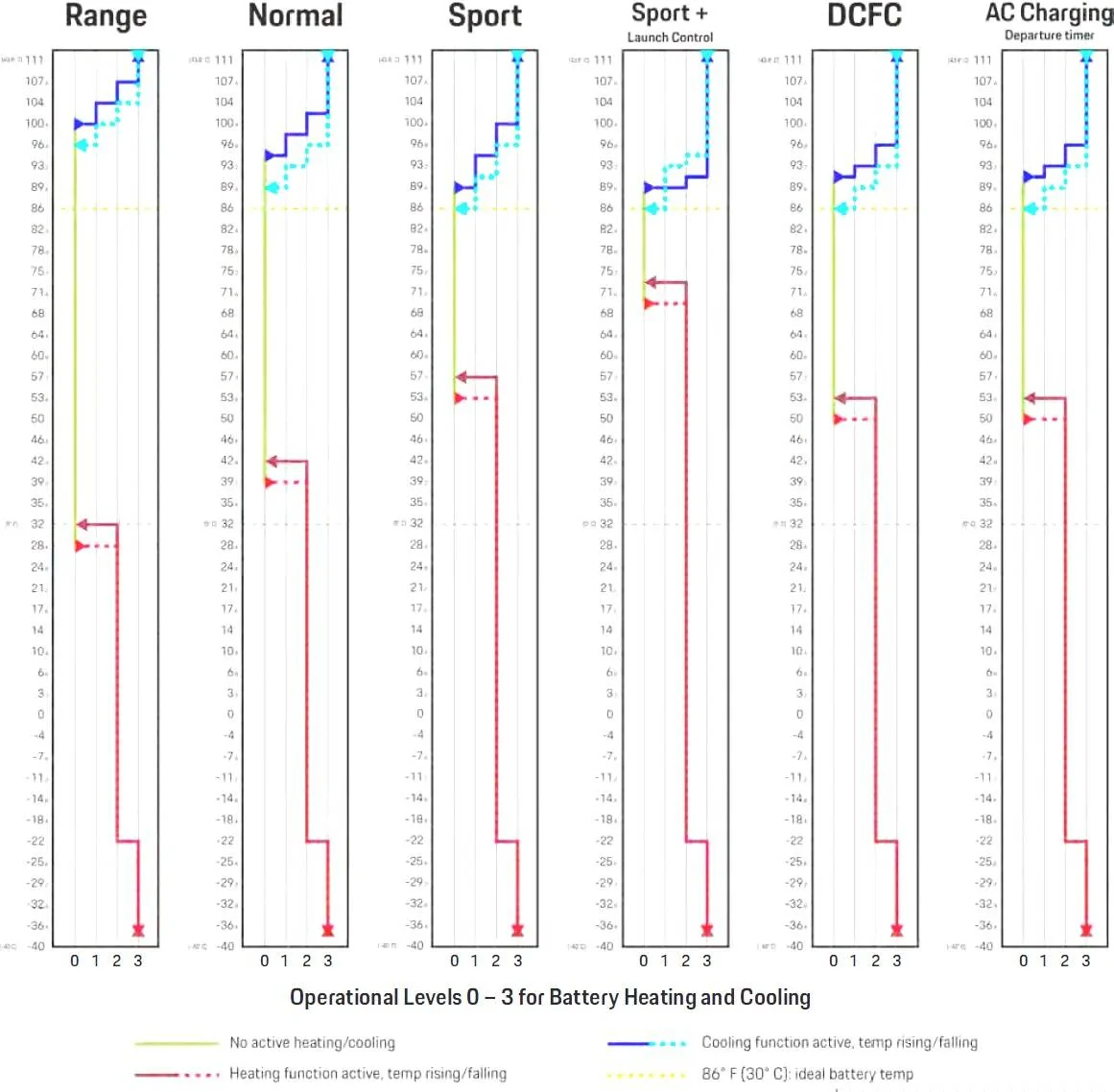

Your method is correct but 4 miles is too short of a drive for preconditioning to be noticeable. It’s usually about a 20-30+ min drive to see battery temps rise with preconditioning and depends on your starting temp and ambient.
If you need to warm up your battery as quickly as possibly putting it in sport+ mode will do that the most aggressively.
Porsche Taycan School Me on Preheating the Battery D6DB0D93-C804-4435-A70B-C3297A41F4A8

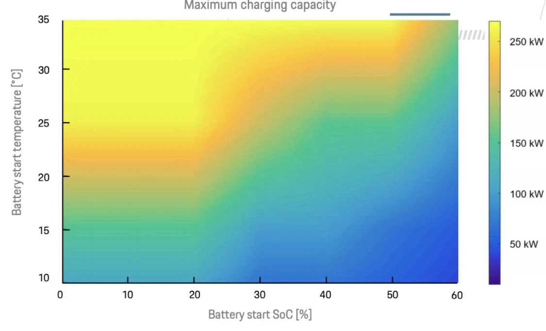

That chart also notes 86F as the ideal battery temp but for charging that varies a bit. But generally to max charging rates you need about ~76F and above.
Porsche Taycan School Me on Preheating the Battery 7CBD83FA-8131-46EE-9E33-21E9DCAF8874
