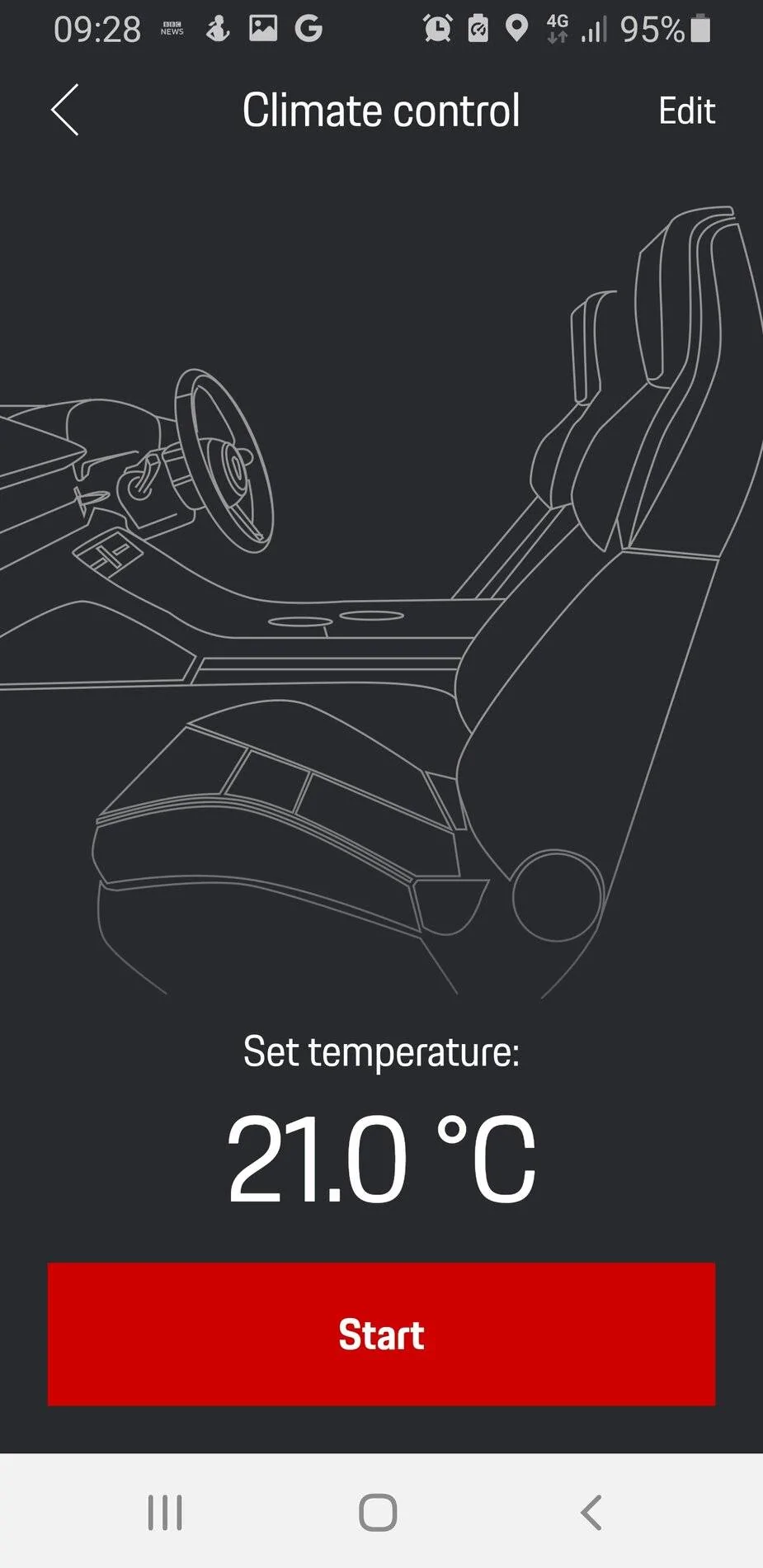

Use the pre-heat / pre-cool function from the app or My Porsche portal.
Porsche Taycan Set climate without charging Screenshot_20210627-092815_Connect

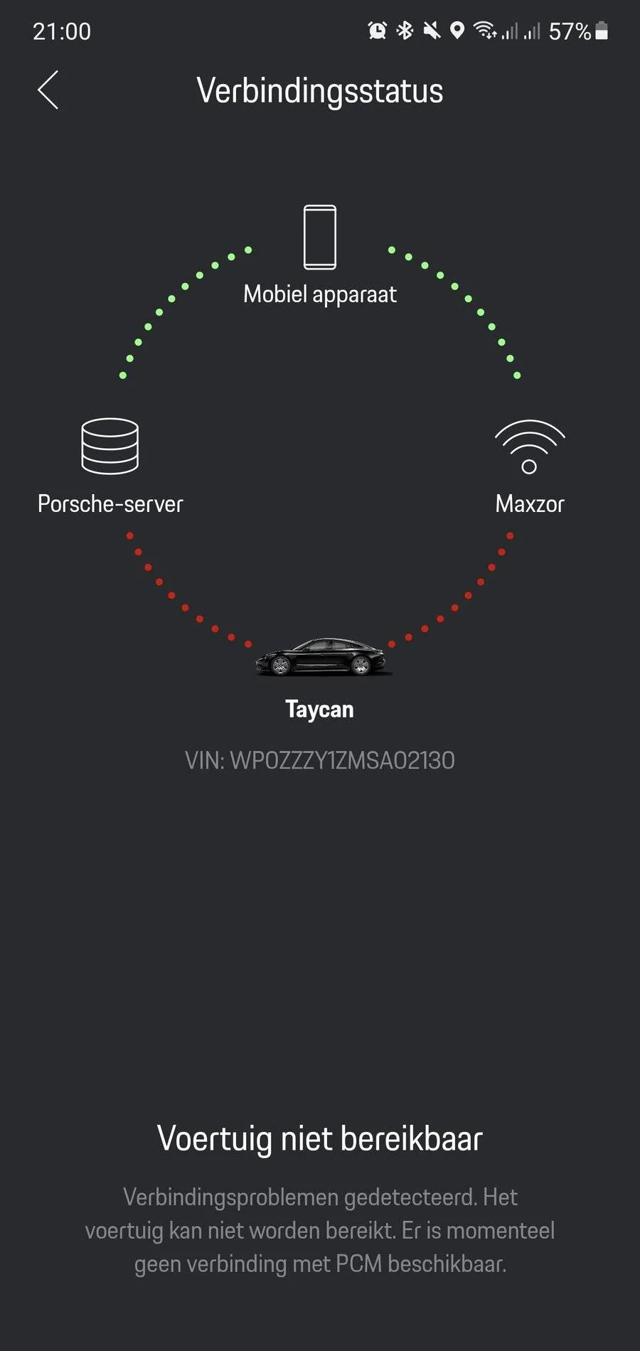

I can't set the climate via the app, it keeps saying that there is no connection. Is there something I can do about this?
Check that privacy mode is disabled in the PCM otherwise no remote access is available.
Check you have a good LTE connection.
If all of the above is fine then it sounds like a component fault and the dealer should be able to diagnose.
Bottom left quadrant must be green and you can ignore the bottom right quadrant.

Thanks, the dealer will take a look at it!
