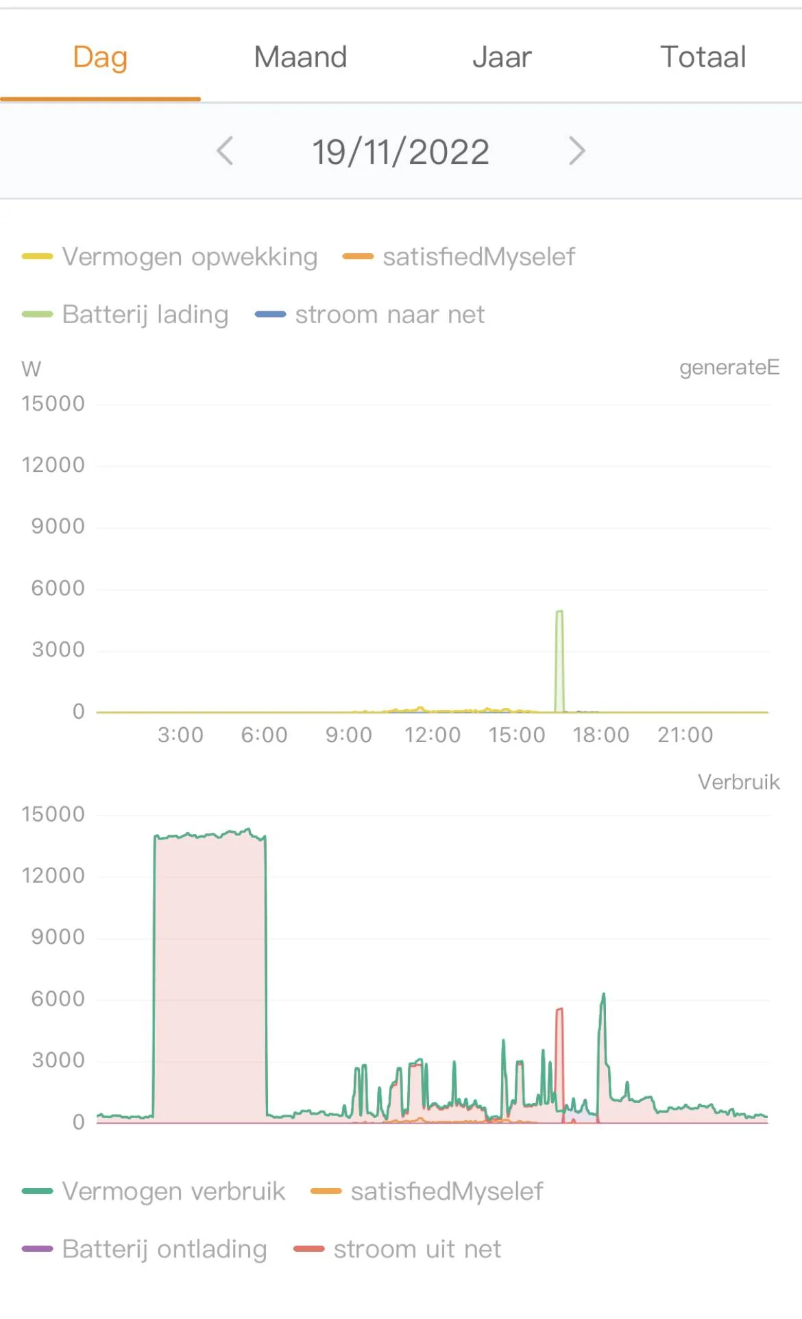

This is what happens with my settings. I have set the power of my charger very low (4,5 Kw) because starting in 2023 we will also be billed on generated peaks. So I want it to charge as slow as possible and be ready before the cheap rate end. This day it was still 10 Kw. I can have 22 max.

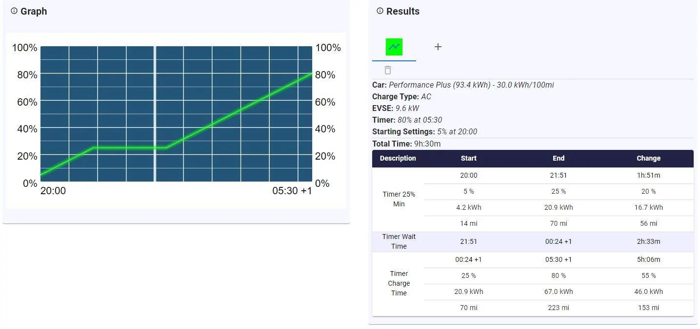

What kW EVSE are you using? At 9.6kW, it would not start charging before 11pm for the timer regardless of your starting SoC, except for the 25% min it will charge to immediately. See graph below.
Car charges to 25% immediately and then waits until 12:24 to start charging the rest of the way to get to 80% at 5:30.

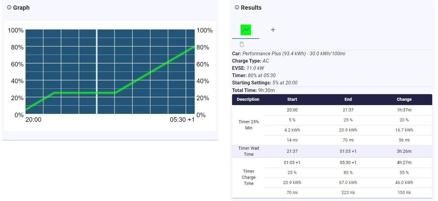

Yes, car will max out at 11kW, which is a little under the 48A, but then it wouldn't start until around 1:00am.
