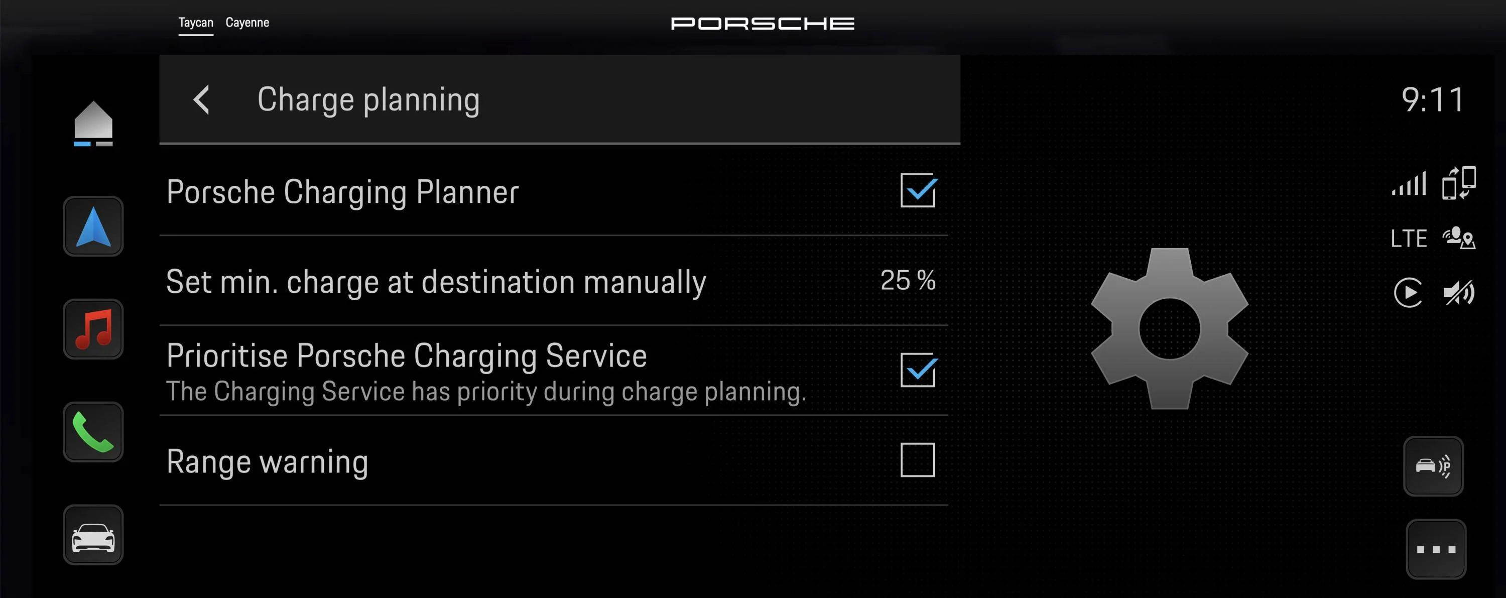

Ah, so not every charger option on the PCM is part of PCS network? Out of interest, how would one know?
Select this option if you want the PCM to "prefer" directing you to chargers on the Porsche Charging Service.
