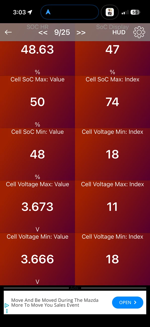

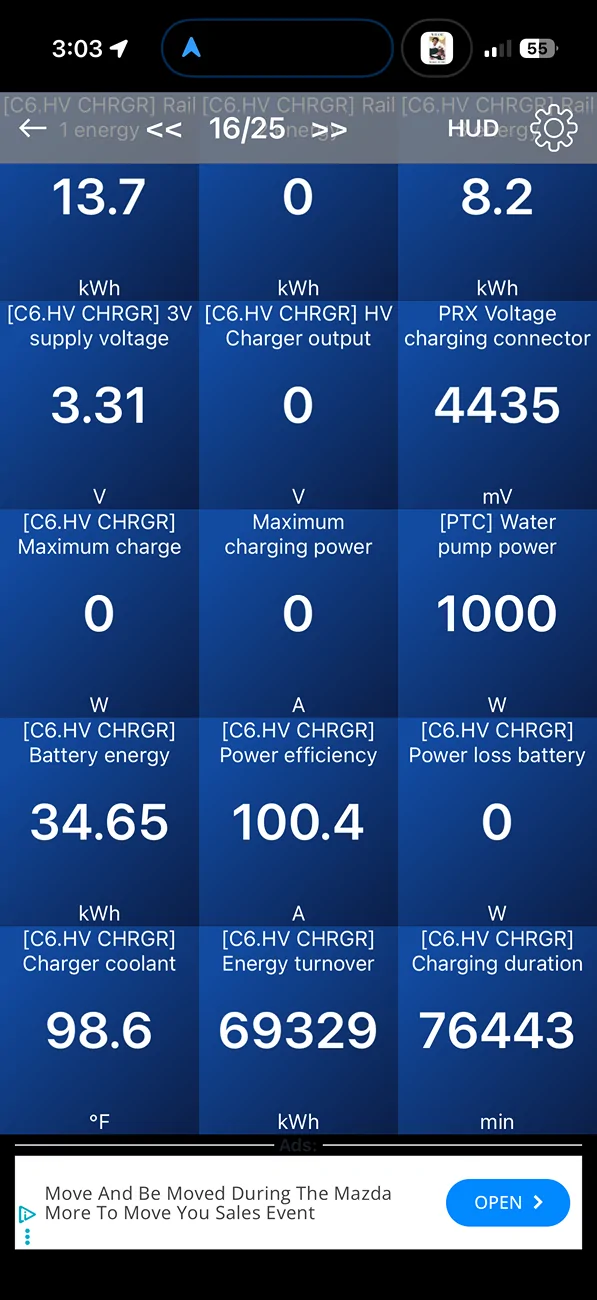

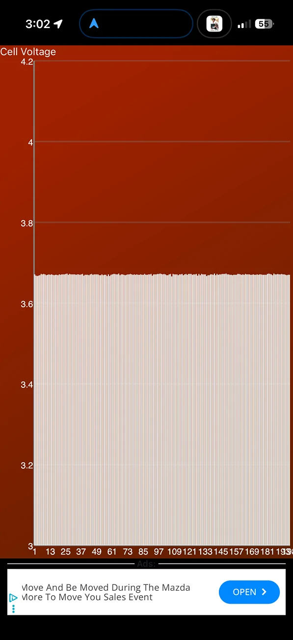

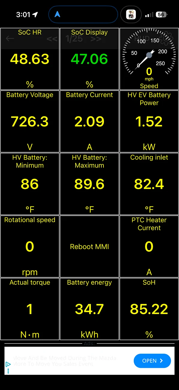

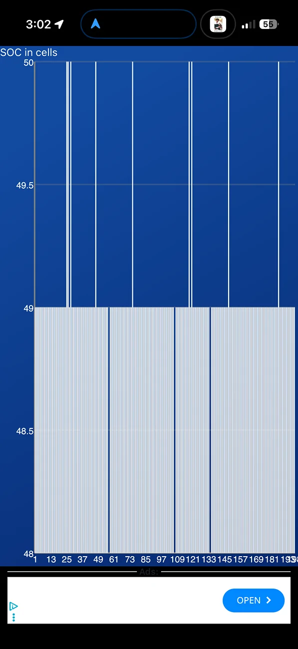

Came back from a 45min drive, SOC is at 47% so plugged in the OBD2 and ran CarScanner. I thought it would be worse than the readings I got.
Porsche Taycan SOC drop IMG_7571
Porsche Taycan SOC drop IMG_7572
Porsche Taycan SOC drop IMG_7573
Porsche Taycan SOC drop IMG_7575
Porsche Taycan SOC drop IMG_7576

@freinando , this shows me you got a problem.
1. I look at the Battery Energy when at 100% SoC and it is showing low as you take 34.7kWh (Battery Energy shown) / 47.06% (SOC Display) that computes to about 73.73KWh which would be low for 85% SoH level as it should be closer to 75-78kWh range. However, others can check me on that.
How many miles you have so that plays into the picture. For example, at 86% SoH my Battery Energy computes to 78kWh at 22k miles.
2. Also, your SoC graph clearly shows several outliers with some at 50 and some 48 or below, which may be an issue.
I think the next step is to commit to a rebalance procedure and do the same measurements before you start meaning at the point when your SoC Display should be 2% or less and then after you charge to 100% and process is complete, measure again looking to gain SoH and better cell alignment or clearly see the outliers on SoC and Voltage graphs. Bad cells come forward after rebalance as they get stressed to low to high and BMS resets its measurements.

I’ve seen around here that the usable KWh on the battery is a number around 86, for the perf battery. That means at 100 SOH, a 47% SOC is 40.2 kwh remaining. For a battery at 85% SOH this is comes out to be 34.3kwh which is around the same number my scan shows.
Regarding the SOC difference in the cells, yes, some have 50 and some 48, but I always thought that the actual thing to be looking at here is voltage difference in the cells. The voltage delta is very small, 3.673v highest -3.666v lowest comes to be at 7mV…
My car is a 2022 4S with 28k miles.
