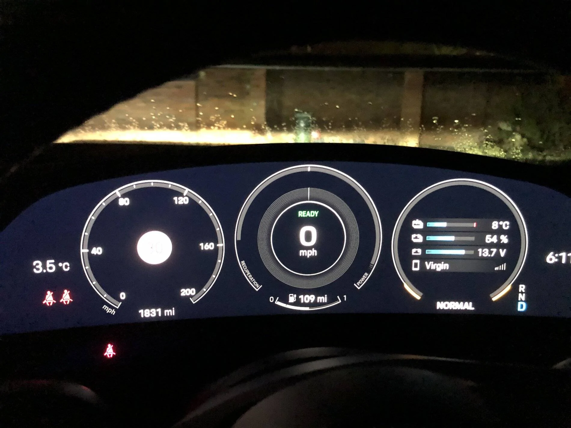

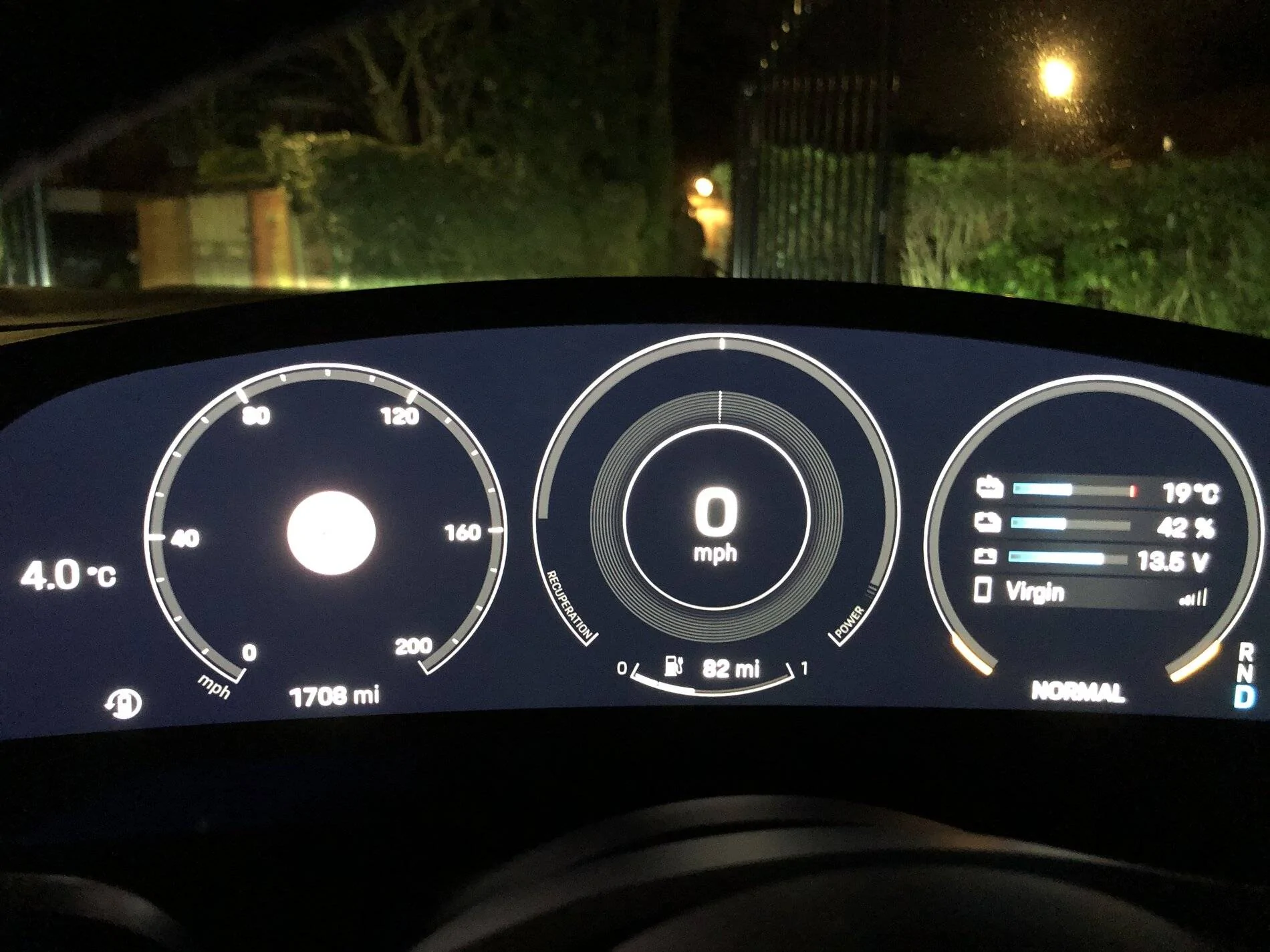

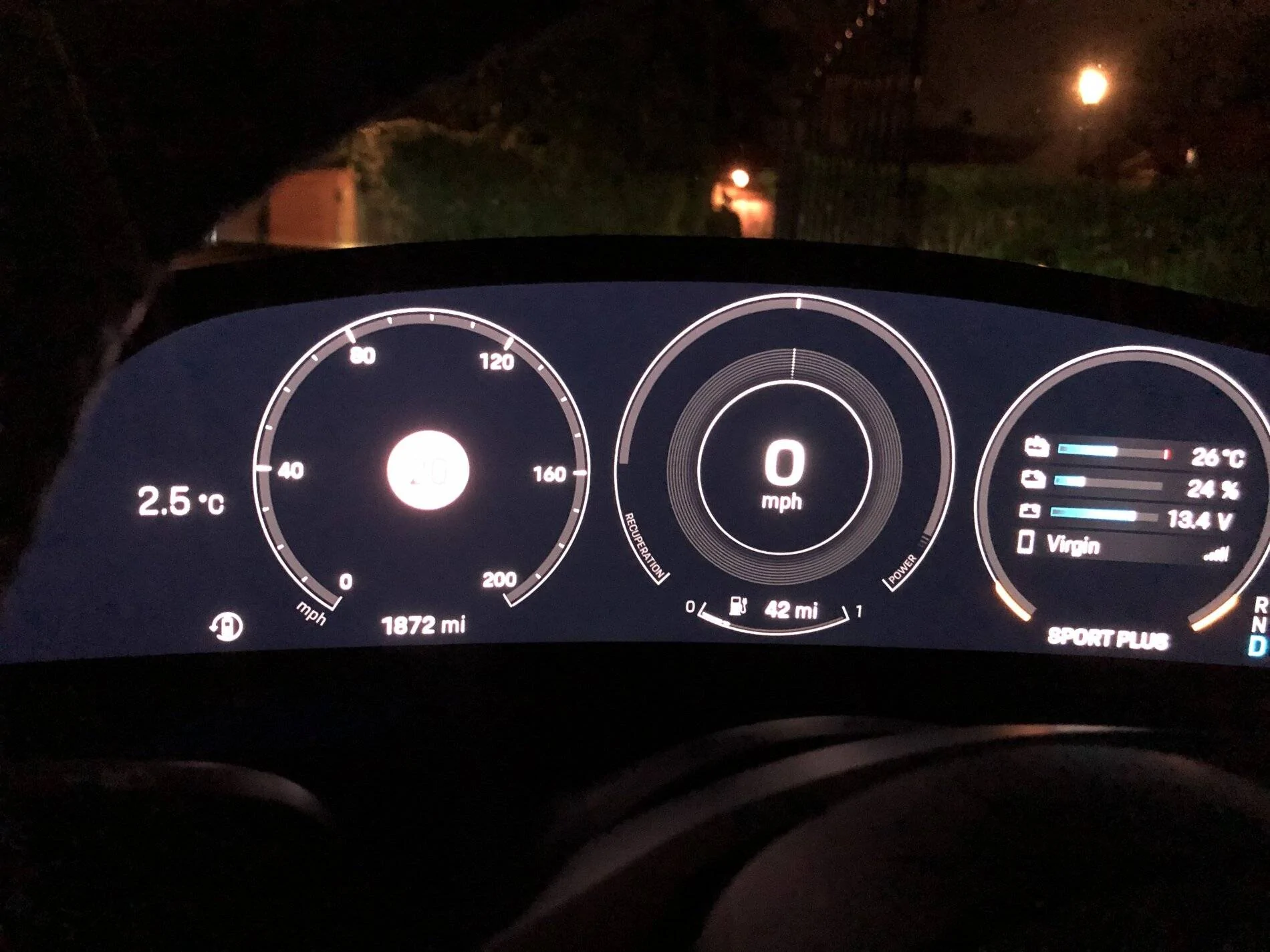

So I’ve struggled to recreate some of the things discussed. Taken several photos during the week, only to sit and look at them now and realise a lot of them are blurry ?. I’ll share some of them. The most interesting one is first, although it has just occurred to me I was in sport plus and should’ve checked if switching to normal made a difference. From what I’ve seen I don’t think it would’ve. Also want to get into the car with a below 30% charge and not pre-warmed. Strangely this week even with no pre-warm and the outside temp down below 4 the battery didn’t ever seem that cold.

So to summarise even when the battery has been as low as 8C (the lowest I’ve seen this week) and the charge was below 50% I didn’t get a loss of power.
If I can get the car below 30% and get in when the battery is nearer 0C that will be the real test now. I’ll have to be at home for that though, and not need to go into work or any other reasonable journey so may take me a while

I’ve noticed available power is nearly always max with battery soc c>55% irrespective of battery temperature. However as the soc decreases lower than 50%, battery temperature has a material impact on available power.
It will be interesting to see your available power with a battery temp <5c and soc <30%.
Sports plus heats the battery and have found my available power increases as the battery warms which is needed with a low battery temperature and soc.

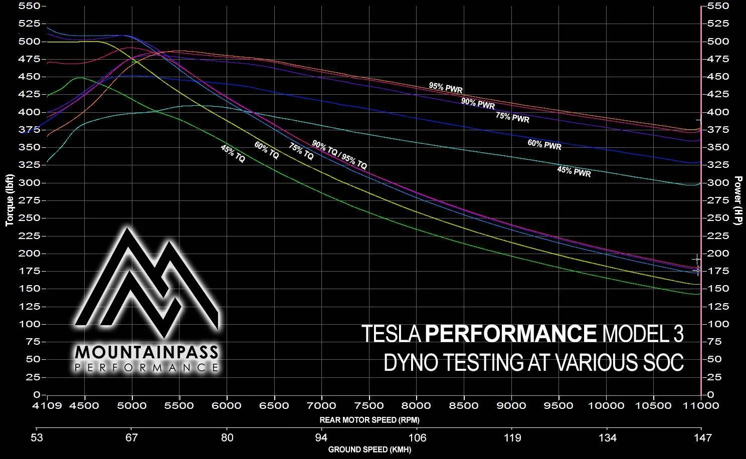

It would be great to see a 3D graph showing available power vs charge vs battery temperature. I'm sure this exists, but we could generate it with enough data.

I suspect Taycan will be similar to Tesla - here is a quick google for Tesla model 3. Full article here. They also mention there was not much of a difference in power below 45 mph. The temperature part is obviously missing....

I think you can not compare Taycan Performance with Tesla. At least not with Model S. They suffer with every single % of SoC loss. Taycan's power ouput is kept to a constant at least until 50% SoC (and okay temp)

The photos is the previous post are from a 4S. Maybe the power loss at low SOC and low battery temperature only happens to Turbo (S).
The 4S max power is already lower than a Turbo and the battery can probably provide the max power even at low SOC.
