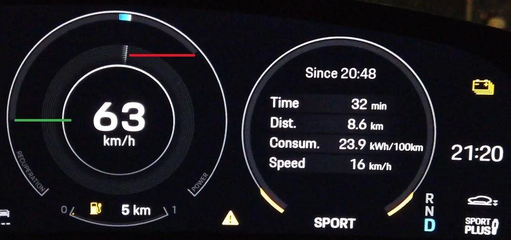

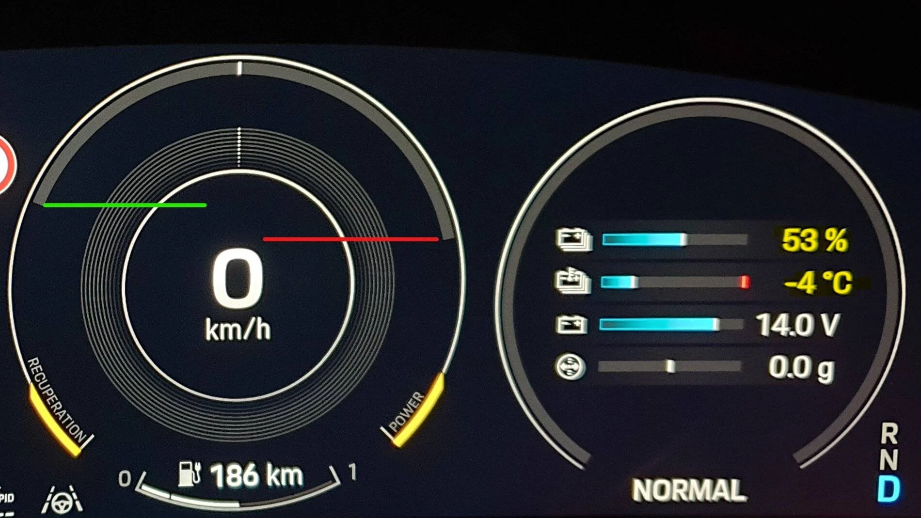

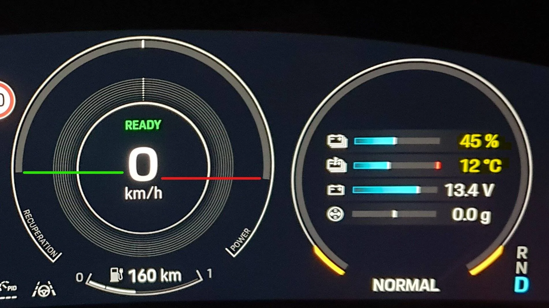

I can confirm that the battery temperature as an influence on power and regeneration.
For the sake of testing I've made a test before and after preheating ;)
here is a picture taken today @18:55
and another one taken @20:00 after preheating the car
That's interesting. I never even noticed the gray bars.

Very low bar in otherwise perfect conditions. Outside temp 29°C.

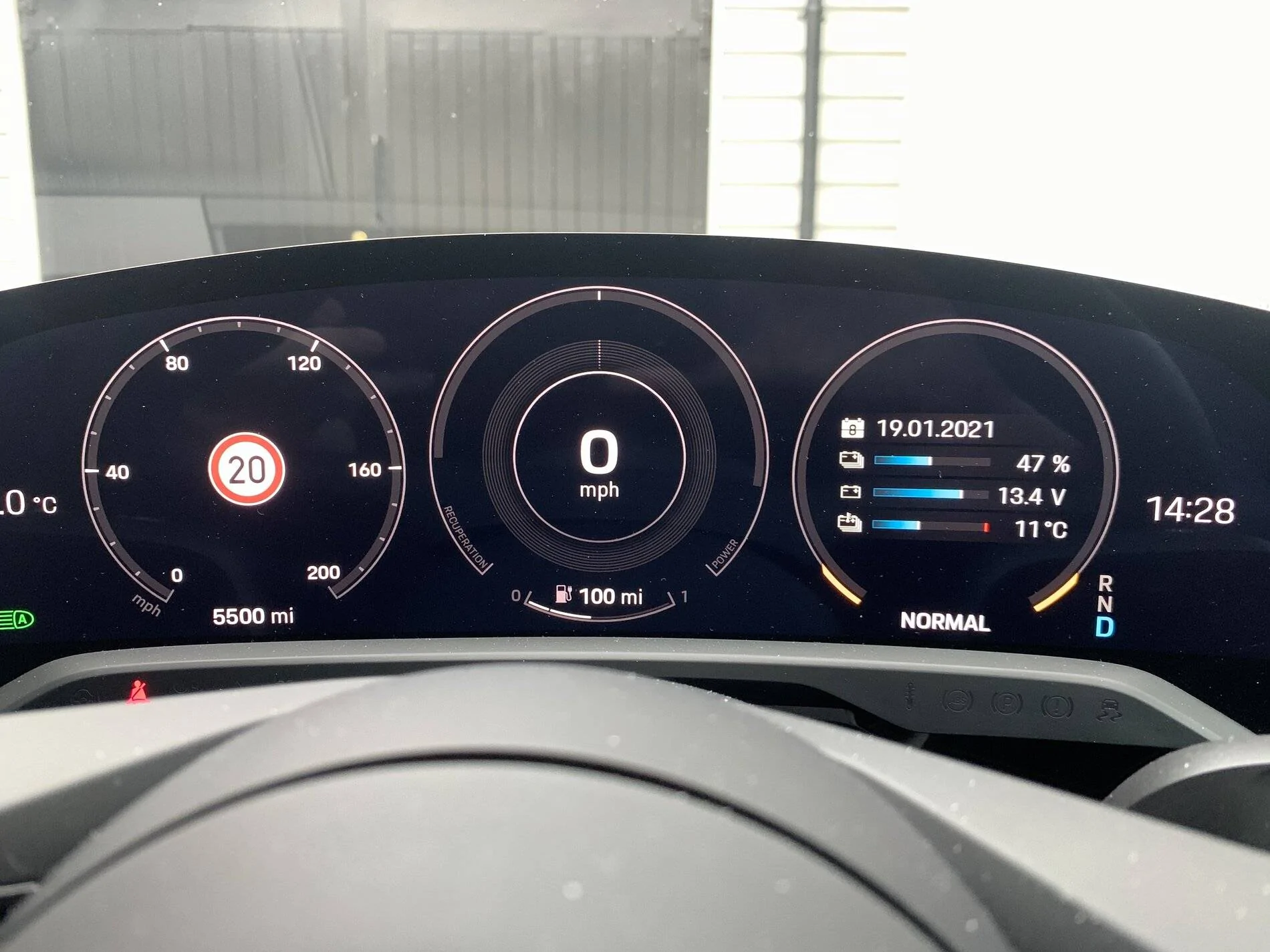

Interesting point, my photos are from a Turbo which clearly evidence power loss at <50% soc and even worse with a low battery temp.
This would be an interesting data point - at the same battery temperature as the SOC for a Turbo or Turbo S declines, does the available power output approach that of a 4S? Meaning all the extra money paid to step up to Turbo or Turbo S is only buying you extra acceleration at higher SOC...?

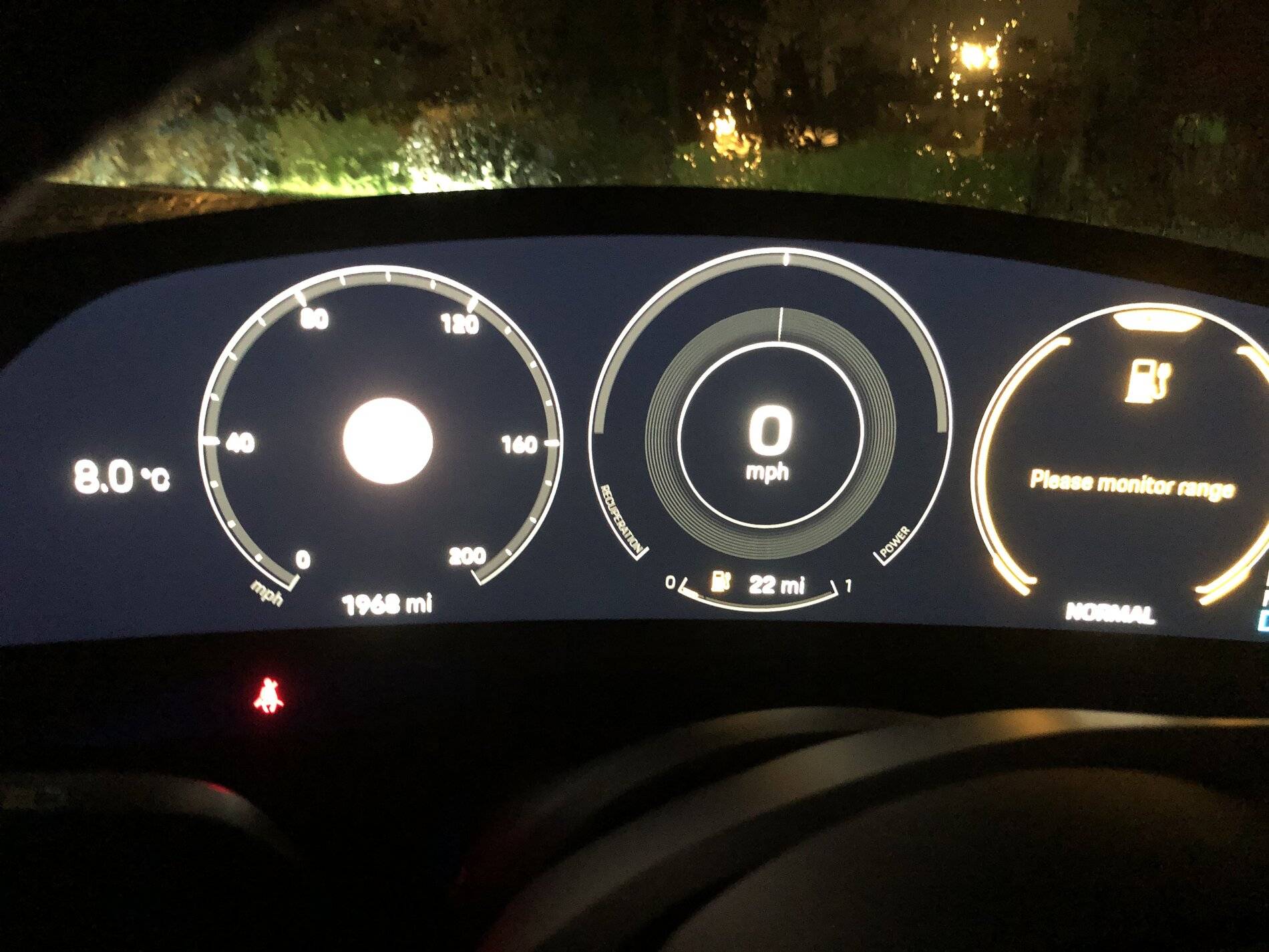

Mine is a 4S with performance battery.
Today I only noticed Power loss once my range notification popped up, just over 20% charge. Battery temp around 25C. I was driving so had to wait to get home to take photo. Power reduction started only very slightly in the meter, but very noticeable when I accelerated hard I could see the bar shrink, then it would return some way to where it was before when I lifted off. Meter stayed at same levels in normal mode.
photo when I got home - battery was 13%.
can I get rid of the range notification in the cluster? It looks like the back arrow symbol at the top is a button, pretty sure it’s not!
