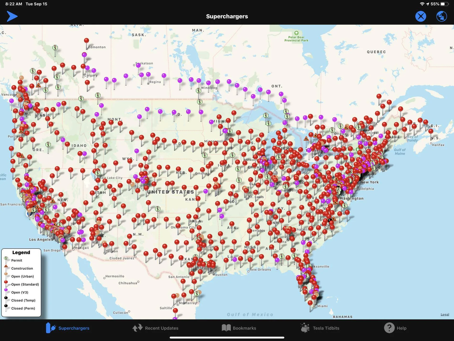

Musk Lies and over promises and generally over promises and under delivers - except in one area - superchargers - and they monitor congestion and seem to respond reasonably - I won’t say congestion is never a problem - but so far the sites seem bigger and they are getting more density - Hwy 101 in CA used to only have Atascadero - and now has Paso Robles, Atascadero, San Luis Obispo, Pismo Beach - relieve congestion along that route…
as a current Tesla & Taycan owner - the Taycan’s charging network is the US is a complete failure - where as the Supercharger network is reliable and growing. I prefer driving the Taycan, but I also prefer arriving at my destination and being able to refuel my vehicle - the best car to drive and the best driving experience is the vehicle that can actually get you there - and right now that vehicle is not the Taycan if you want to drive further than one full charge.
you will have few if any problems attempting to use any of the supercharger sites listed below - and now we know from europe that the Taycan and other EV’s work just fine with the superchargers, so there is not even really a technical issue…
Porsche needs to step up and work with who ever can provide a functional EV charging network…cause EA ain’t it.
