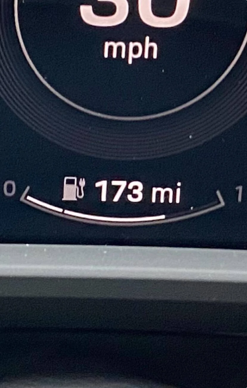

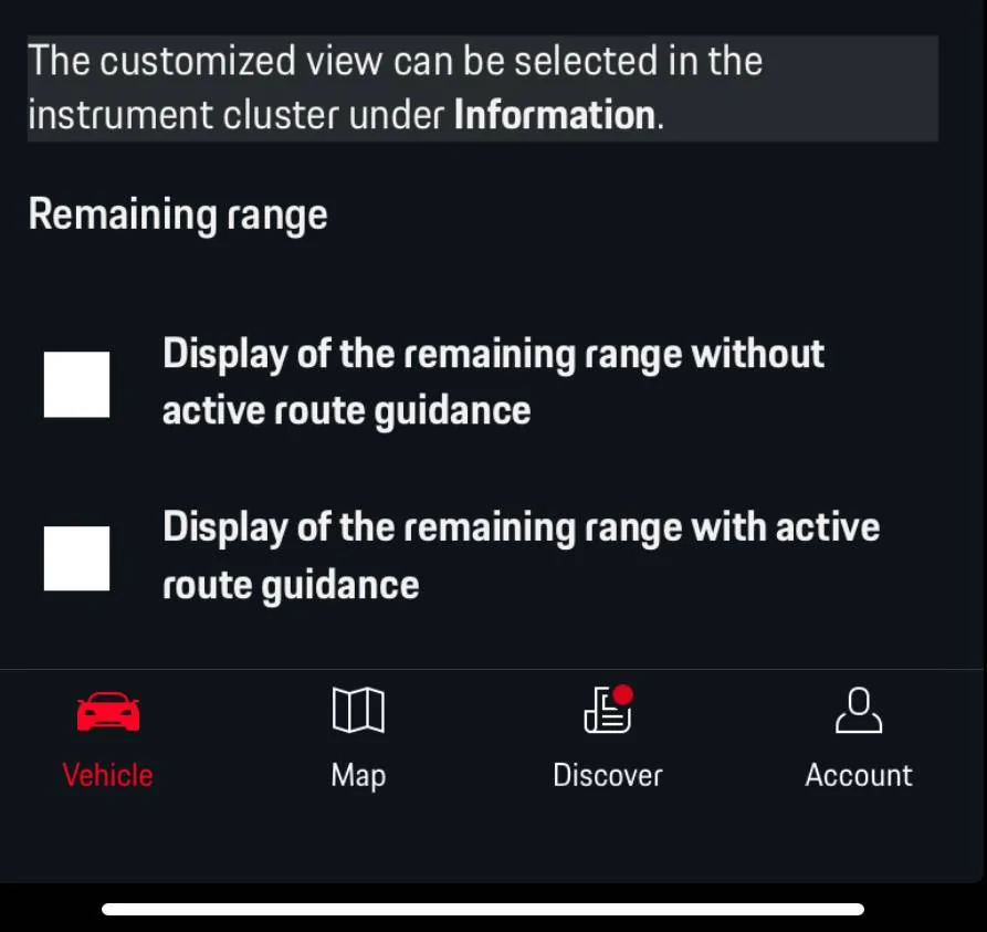

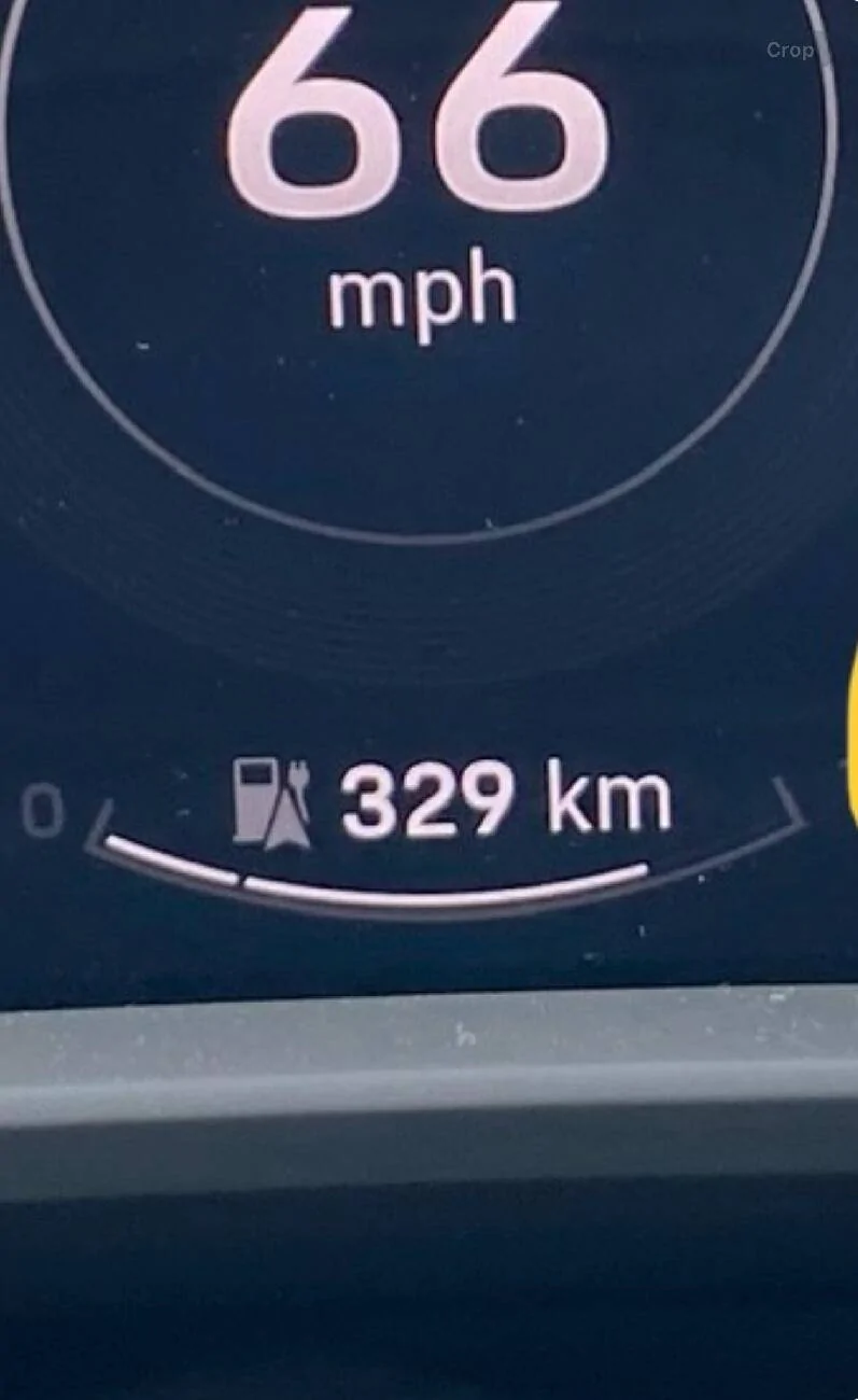

On the range display (under the speedometer) there are two symbols. One is an EV charger alone. The other has an EV charger with a triangle superimposed over the charger. There are two modes for that display. One is for range remaining, nav not active. The other is range remaining with Nav active. I noticed this for the first time last week after almost two years with the car. When the Nav active with an active destination, the range remaining will sometimes change based on the characteristics of the route (I suspect elevation changes are a part of this computation). I’ve seen the range remaining change considerably due to this.
I can’t say I understand it. But I suspect this is what happened. Here are some photos. Ignore the MPH vs. KM discrepency. I was in Canada for one photo, and the US for the other.
It does that. My normal range without navigating is around 360 km. On a long winter trip to the alps through Germany it drops to less then 300 km when starting navigation. It is really accurate. It doesn’t explain however why his SoC dropped from 30 to 15. And if I understand correctly it was the actual SoC not the SoC on arrival.
For pre conditioning for DC charging it takes some battery. I have set my SoC at arrival at 10 %. When I am driving home I don’t mind if it would go lower because I can charger anyway. PIRM will schedule an extra charge stop and pre heating when the estimated SoC is to low. Skipping the charger and pre heating however also results in getting home with 8% SoC.
