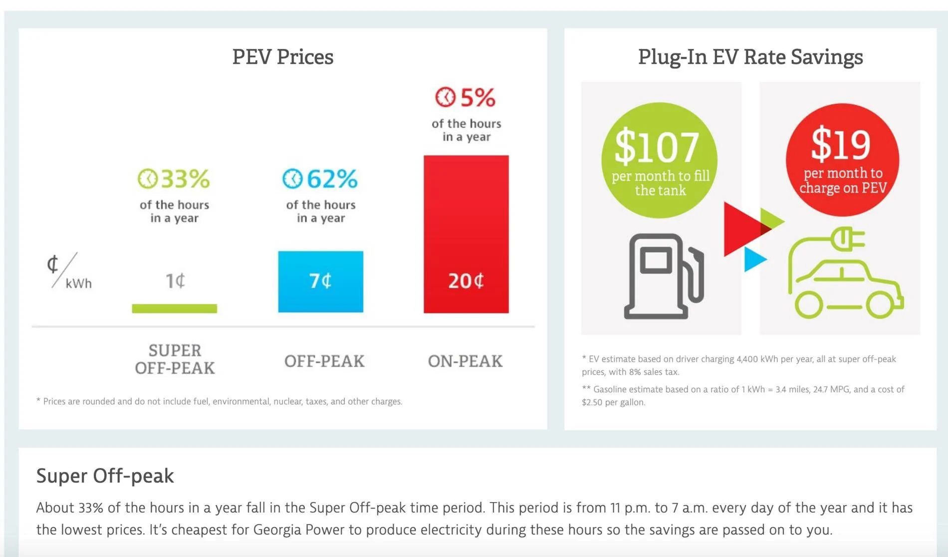

I am glad that forum members have discovered different options for getting to 85%. There are some situations whether it is precool/heat, or the cheaper electricity rates available that I can achieve overnight that are more difficult with a general profile vs. a timer profile. Setting up a timer profile takes about 15 seconds longer to do than a general profile, so either is easy to do. Once set up both are automatic. Below is the difference in the electricity rates with Georgia Power.
I'm not saying that a Timer profile or a General profile is better. WIth all the confusion and lack of information from Porsche or the dealers, it is important that all options are available and explained to the forum members. We all know what is going to happen. When we hit the winter months, someone will rediscover that you can preheat the car, and we will have a new round of people who have set up General profiles and then will be surprised to learn that they could preheat with something called a Timer profile.
Porsche Taycan Setting up for charging in garage Screen Shot 2020-08-03 at 12.38.34 PM
