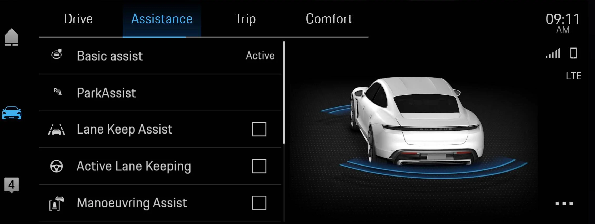

8,815
5,274
GTS ST, Macan T
What does LKA stand for? Lane Keep Assist? then yes that is what I meant
To be clear, what Assistance options do you have on the car - Adaptive Cruise Control (incl Active Lane Keeping), InnoDrive, Lane Change Assist (leds in mirrors)? If you don't have any of these then my guess is the problem relates to one of the three standard speed control features.
If Lane Keep Assist (standard on all cars) is the culprit you can easily switch this off - press the button on the underside left hand control stalk and then use the thumb wheel on the steering wheel to select and then press in to enable / disable.
By default set it to cruise control which will then be enabled / active when you press the button at the end of the same control stalk. So next time when you press that button the cruise control will be in a passive state waiting for you to engage or not.
Also you can also disable LKA in the PCM
Porsche Taycan Take over steering problem 1642611926799
Suggest reading the relevant section in the Porsche Good to Know App as there are many things here to understand and utilise. None are difficult but good to be aware what they are and how to activate / deactivate.
LKA is a pain (and dangerous IMHO) and so I always have it disabled. The other function I have disabled (also controlled by the same control stalk) is the speed limiter - this will randomly slow the car down if it thinks the speed limit is less than what you are travelling at (uses the camera and mapping data to determine) - so if travelling quite happily at 50 mph on a road where the limit is actually 50 mph the car could determine that the speed limit is actually 30 mph (as happened to me) and automatically (and dramatically) reduce the speed to that value without warning. Road signs can be damaged or confused with others and mapping data can be out of date. So nice idea (when it works) but can catch you unawares.
So of the 3 standard speed controlling features I only ever use 1 - cruise control - as the others are flawed for various reasons (poor signage, mapping errors, faint road markings etc).
