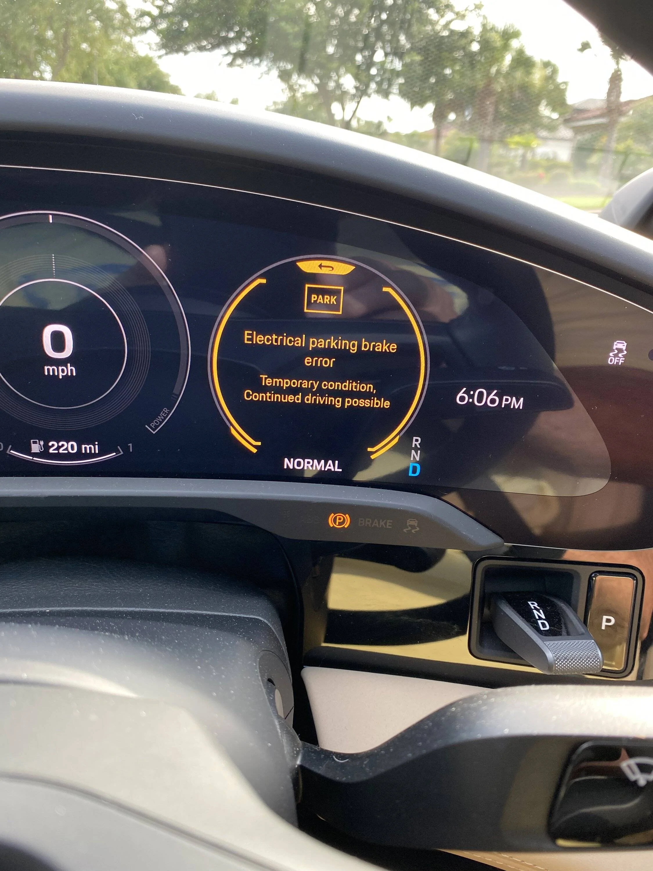

My 2022 Taycan recently began showing this error requiring me to go into the option/vehicle/electric parking brake to get it to release. This does not always work rendering the vehicle useless. Have to power on and off multiple times to clear this error. Eventually it works correctly. Anyone else experiencing this and was there any permanent resolution?

Not seen that error before.
Could be random but likely will need a dealer visit.

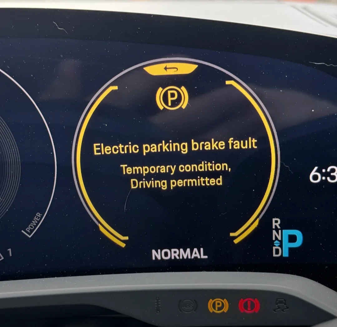

I have this same error. I note the "HOLD" function no longer works while in drive or reverse. And the sound of the parking break being applied when I put it into Park isn't there, so I'm assuming it's just a broken parking break.
Service scheduled, driving in the meantime.

I got this same error today and was able to continue drive in to work. When returning back, the parking brake would not release and I had to go into settings "Parking brakes" selection and run detection on it. Ran it a few times to no avail. Eventually just turned off the car. Turned on and the error cleared out. I have scheduled service visit, though I dont know if this is self resolved or needs technician to look into like the TSB says. Mine is 2022 CT 4 and has about 8000 miles on it.
