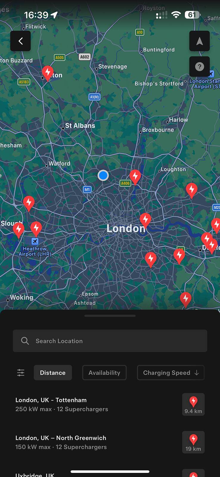

Thanks all - looks like I only have 1 around which is open to all
Porsche Taycan Tesla Superchargers & Taycan for dummies IMG_3067
