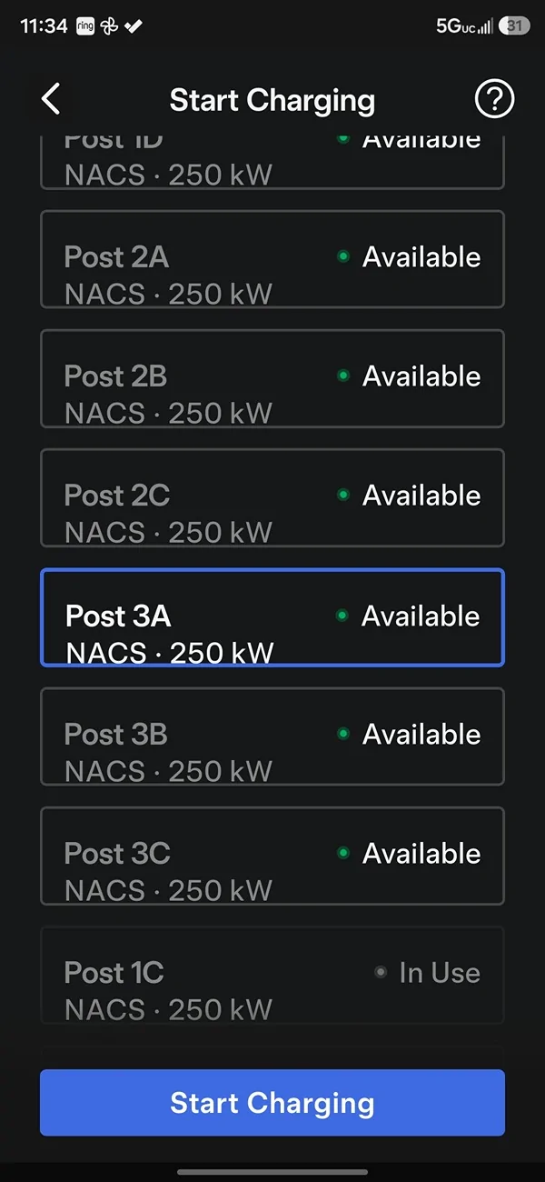

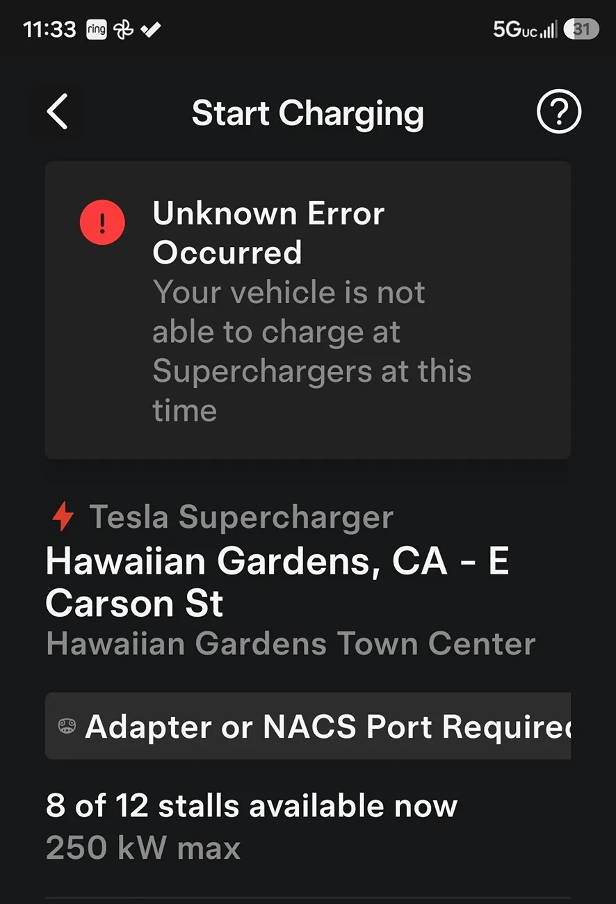

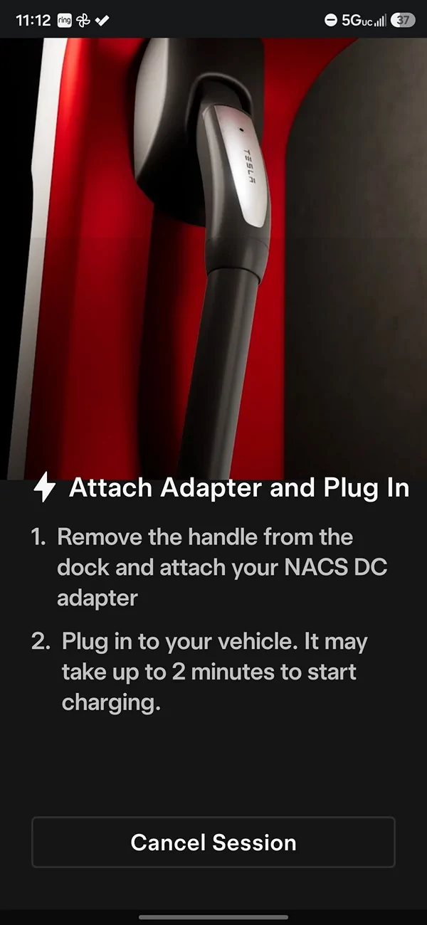

However I was wrong, I did activate charging first.
After that it tells me to attach the adapter and attach it to the car.
I went to yet another station to try this sequence and still no luck...
