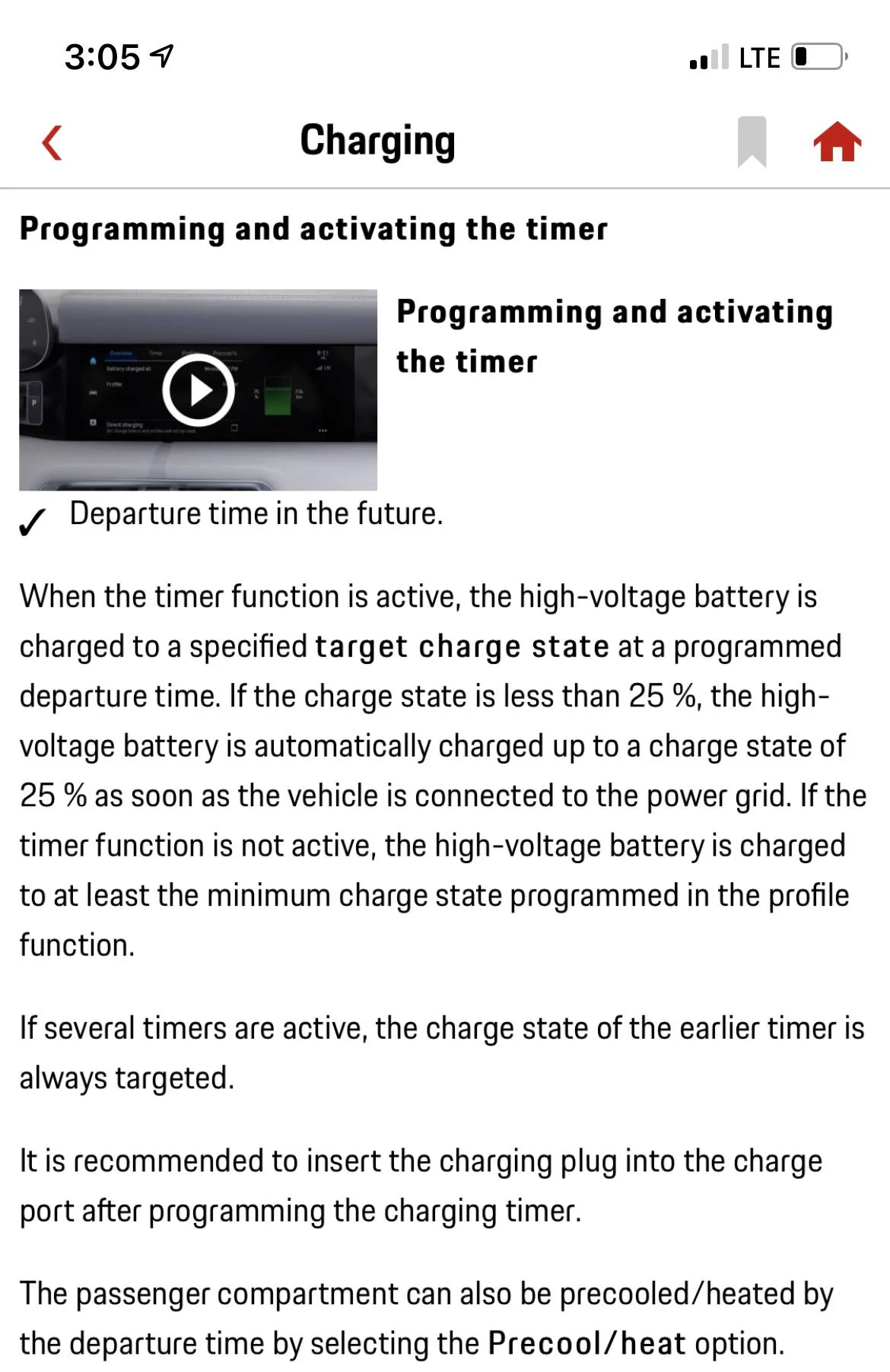

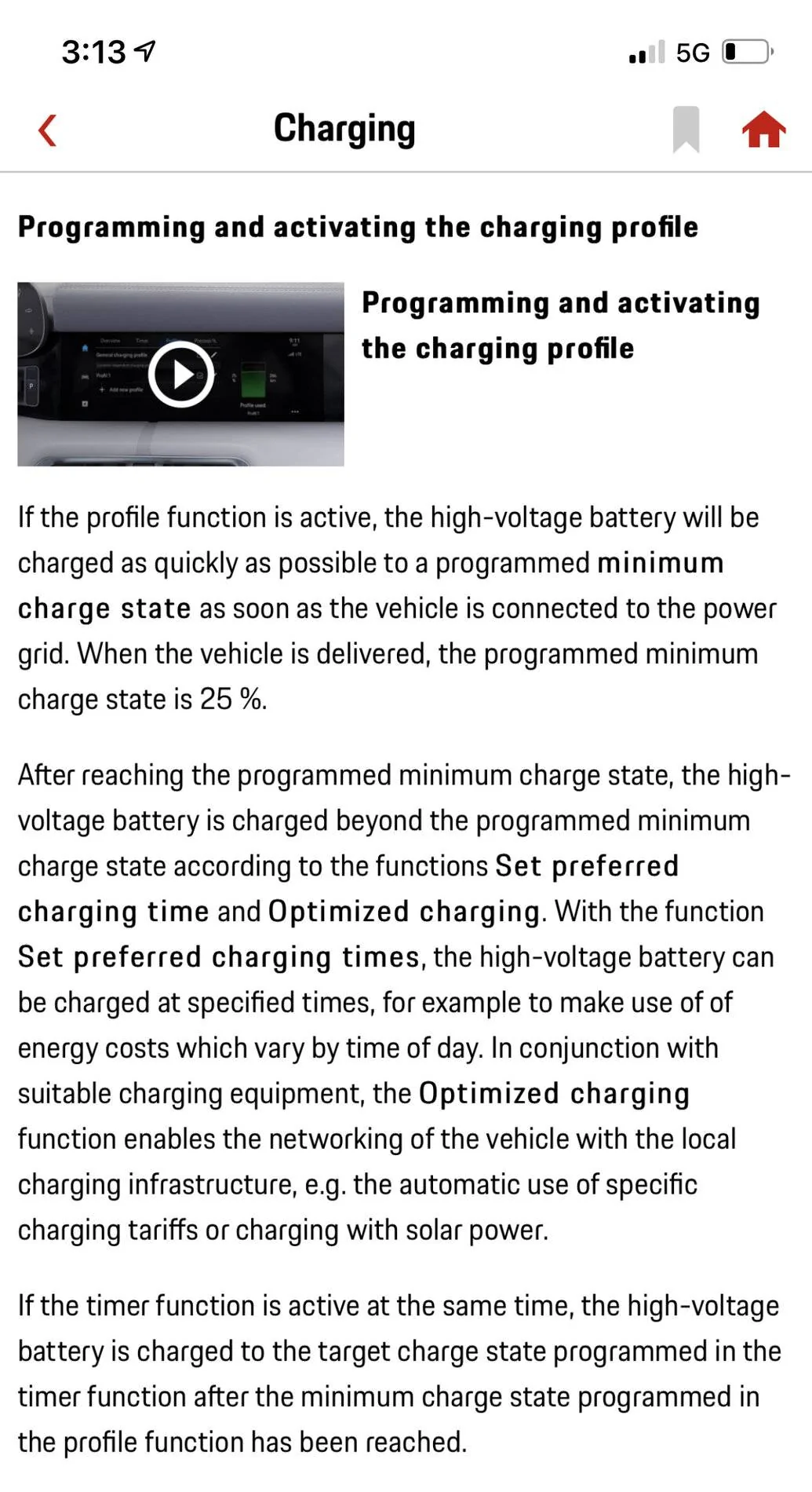

You know, the more I think about it, I think I am right in Post #79 on what happened - timer functionality got overloaded for TOU by adding ability to charge to less than that is in your profile. As a side note, it makes very little sense to want to charge say to 80% daily, but only next Monday I want to charge to 50%. Not only that, it is not obvious what would happen if today is Monday night, my profile is set to 80%"minimum" but I have a timer for next Monday at 1am to be charged to 50%. Will the car charge to only 50% all week? Or will it charge to 80% until 12:01am on Monday and then somehow discharge to 50%? My theory is also supported by the "Optimized charging" profile option description:
Out of curiosity, is how to set up profile+timers something that Porsche documents in the user manual, or is this only something the internet community has figured out and shared?
I see what @andrewket and @DerekS are saying about missing TOU functions. Without being able to further lower or turn off the minimum, as well as set a maximum, you can’t properly set the car to charge to a limit within a window.
And I see what you’re saying about Timers since they can be and are used to accomplish this in certain circumstances. I was incorrect that they can be used to replace TOU generally. There’s also no actual maximum for Timers since the car will start to charge to 100% if left plugged in for 30 min after the departure time.

So, there is effectively no maximum settings in any case. Although, as stated earlier, profile minimums act as a maximum when used in isolation.
A correction though, the Timer would be used to charge above the profile minimum, not below it.
I agree you wouldn’t, and in fact can’t, have the car charge to 80% from the profile and then 50% from a timer. Remember that the profile minimum is in fact appropriately named and is a minimum.
I also don’t think the Timers are a work around on Porsche’s end for TOU as much as by the community due to the missing max charge feature to use preferred charge times.
But none of this means the settings are confusing or poorly named. I’m adamant they aren’t on both accounts.
They just don’t support some features (lower/no min charge and a maximum) some people want/need. I have no issue conceding that point.
Timers and Profiles are both covered in GTK. There is also information in the connect app for the settings.
