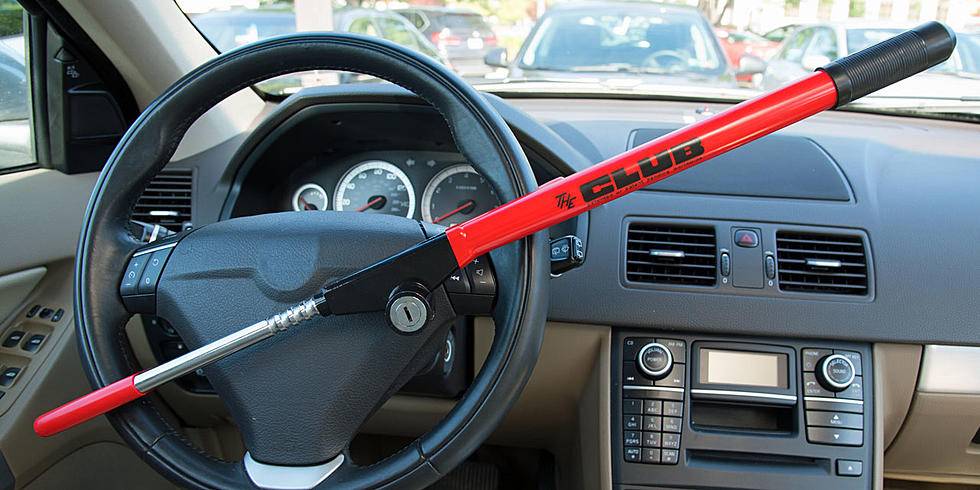

This was a popular, noninvasive solution to car theft in the 80’s… will need to search my parents attic to see if it’s still there.
OK, I've always thought these were ridiculous. You can use a standard bolt cutter (or even less) to snip through the steering wheel in 2 spots and off you go!:rolleyes:
007
Mar 21, 2023
714
1,381
Poland
Taycan Turbo S
Modern thieves don’t carry bolt cutters, just those black boxes to steal your keys. The Club will make a comeback.
