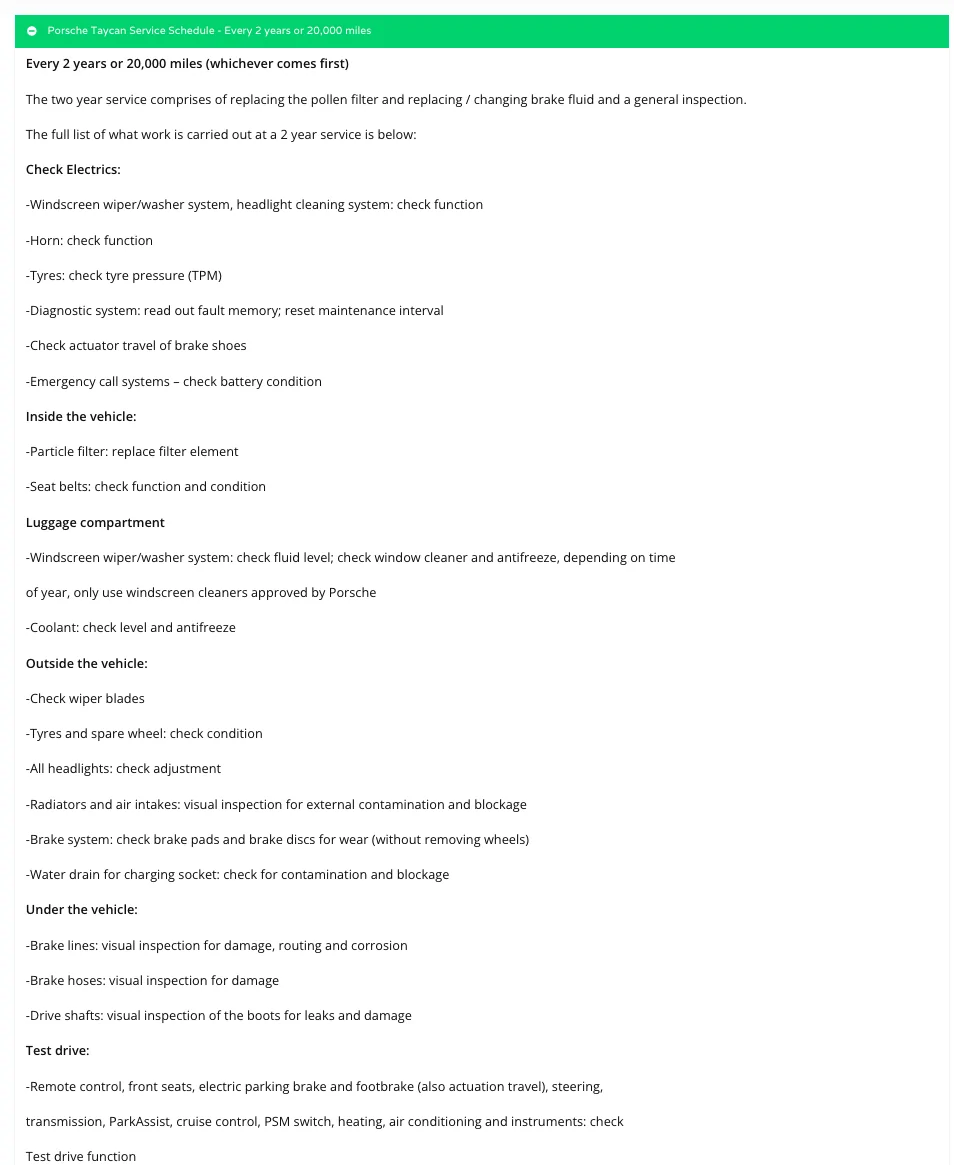

Add to that the brake fluid replacement (mandatory at this service interval) and overall inspection (drainage plugs etc). Labour rate / time is the killer.
Full list:
Porsche Taycan Update: the recall completed all brake and hose servicing. 1776757681900-a
Full list:
Cheaper than servicing a Macan ICE.
Still a rip off. Even at shop labor rate. It Doesn't take more than 1 hour to do all the checks since it's all visual. They don't even remove the wheels.
Changing the brake fluid would also take less than 1 hour for any competent mechanic.
