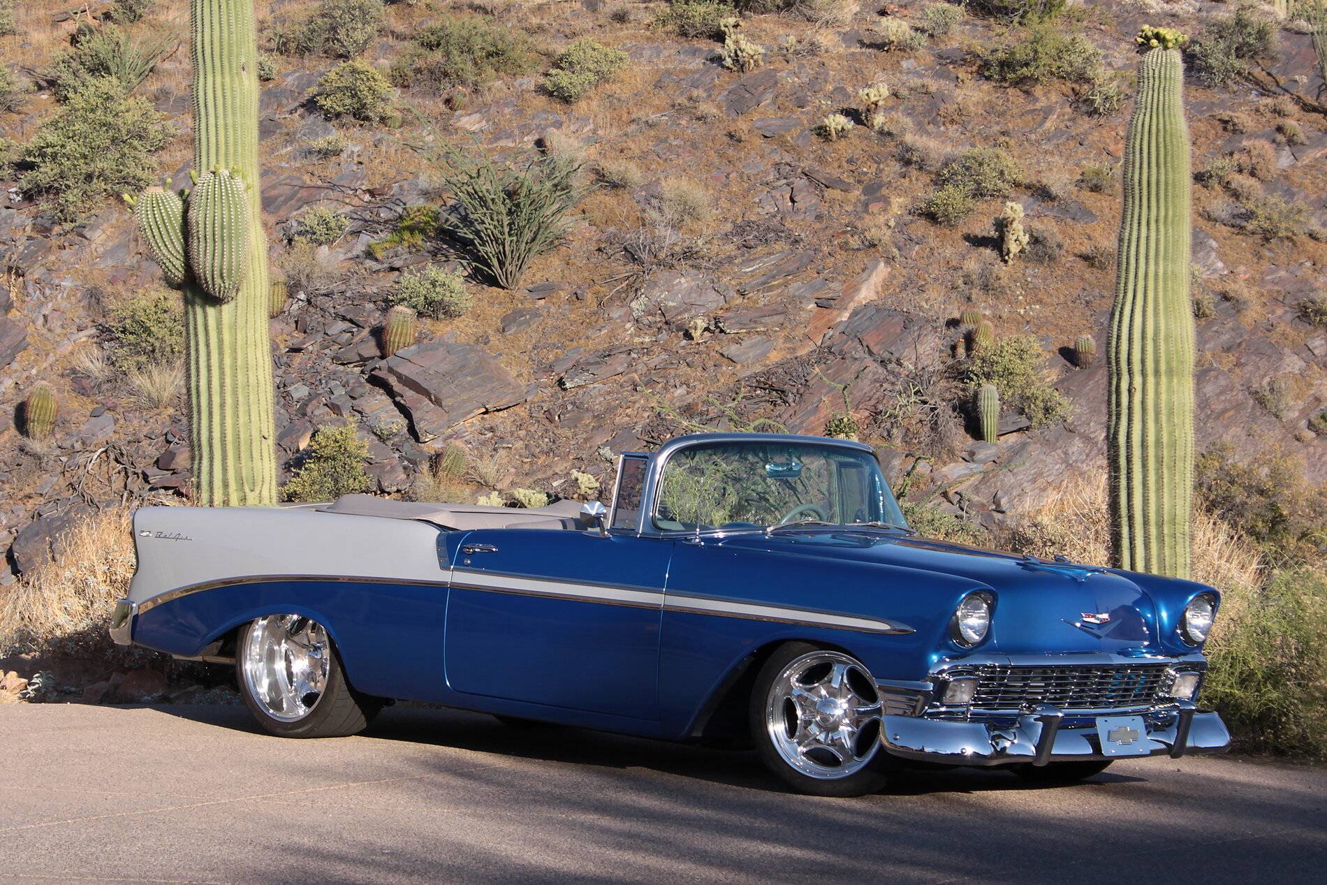

OT but lets see photos of the 56! Nomad?

56 is my favorite year tri-five. That is gorgeous my friend! I had a 63 Bel-Air a few years ago - 1 owner AZ car with 55K miles. Aqua/aqua with factory A/C.

About the Chevy - You asked, here it is! Old school. Belair with a big block 454 and dual four barrels.
Man, global warming has done a number on Vancouver since I was last there a couple of years ago!!!! I don't remember the native cactus growing that large!
Seriously a gorgeous car, and perfect for Arizona in January or February.

The car resides in AZ! A big contrast driving the 56 compared to my Taycan.
