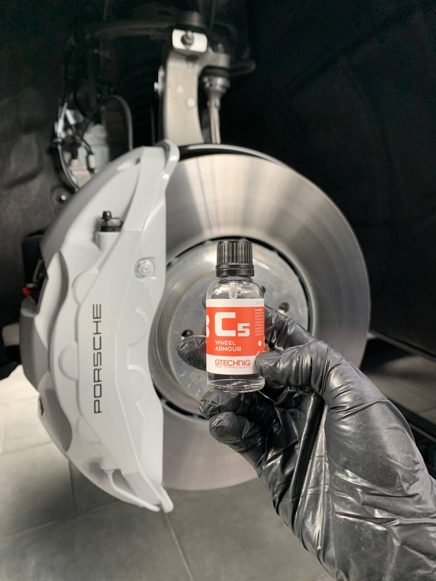

PSCBs are 6 piston calliper at the front (4 at the rear), same as the standard brakes on the GTS.
3,092
2,690
No not for the MY 2020. They are massive 10 pot front and 4 pot at rear. I think they change this in 2022?? See picture below
Not sure that more is better though??
Ah, ok. Those were used for the 911 Turbo S I think? They certainly had 10-pot calipers on the 992 Turbo S for PCCB.
