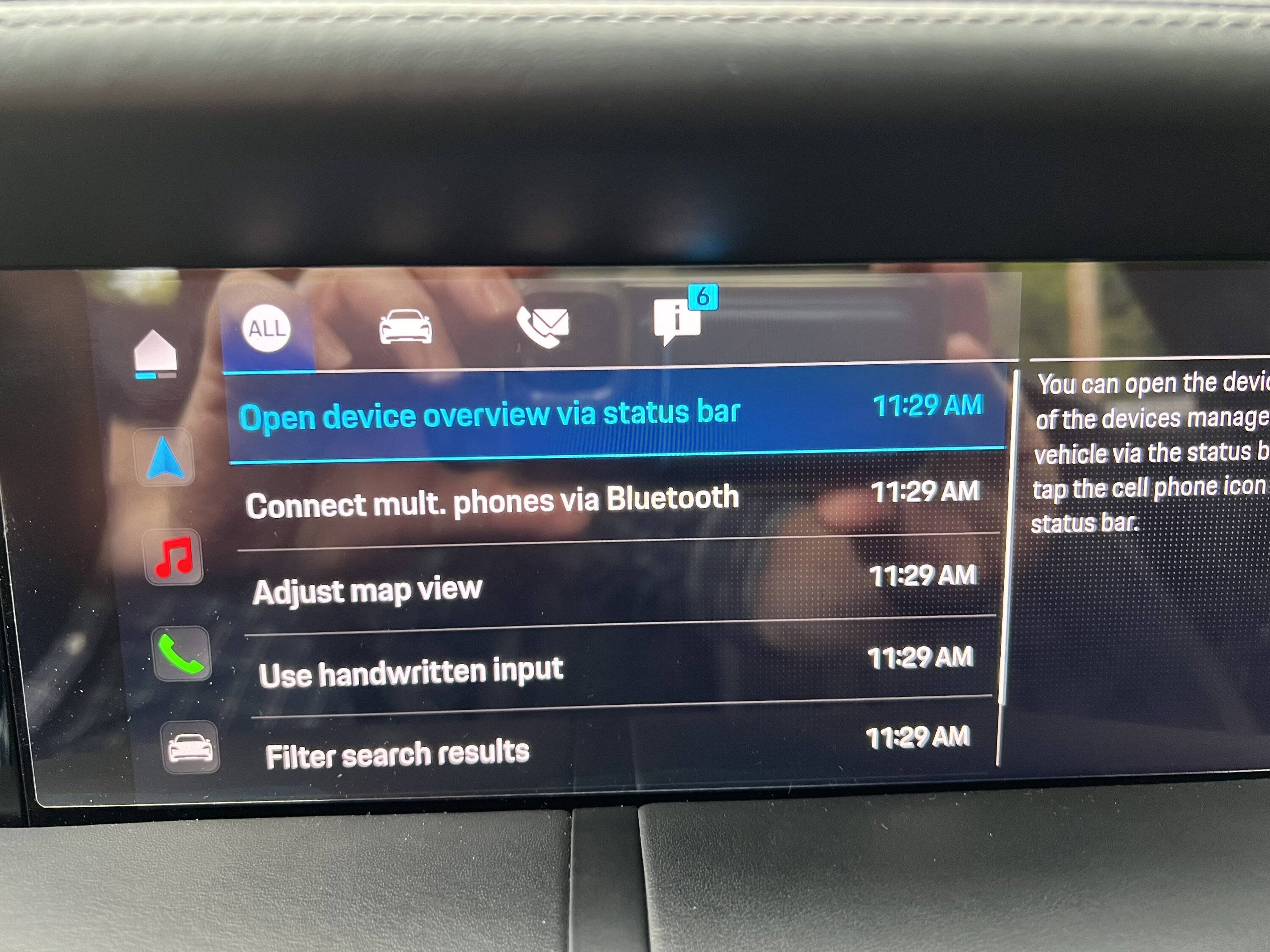

Q: what notifications, can you share a pic?

Multiple notifications pop up every drive now, started a week or two ago. '23 CT 4S.
I’d say it has been happening for about two months now with my 2022 CT4. These notifications are apart from map updates. Hey are always the same six notifications. Deleting them causes them to arrive the next time I drive. Not deleting them has the same effect. I’m can’t see what else I am supposed to do with them. I do not believe these are new notifications, and I find it annoying that I keep getting them. I would like notifications when there are indeed updates, but repeatedly telling me I have received updates I have already been informed about it very annoying.
I also cannot see how to suppress the notifications about homelink that appears every time I am near home. That is spurious too, and interferes with my use of the user interface for other functions when I am driving into my garage.
It would be great if Porsche hired a few decent UX designers for their software. It would go a long way to making their product feel high quality.
This has been a constant annoyance for months on my 2023 GTS as well! Like others on this post, I tried swiping left to delete them (sometimes 12-15 of them), only to have them reappear a few days later. Finally, when I arrived home one day with 15 more of the same update or tip notifications, I tried opening a few and responding to the prompts. One of the prompts was to "Ignore" the notification, which I selected. I did that on a few more, then the PCM displayed a new message, asking me if I wanted to stop receiving tips from the PCM. I gleefully, selected "Yes". That was a few days ago and I haven't received any new tip notifications since then. Hopefully, problem resolved.
Unfortunately, after extensive searching online, in the PCM manual (both paper and digital), I could not find any reference to the ability to turn on or off OTA Tips. Very frustrating that one has to deal with this and solve it through trial and error!
