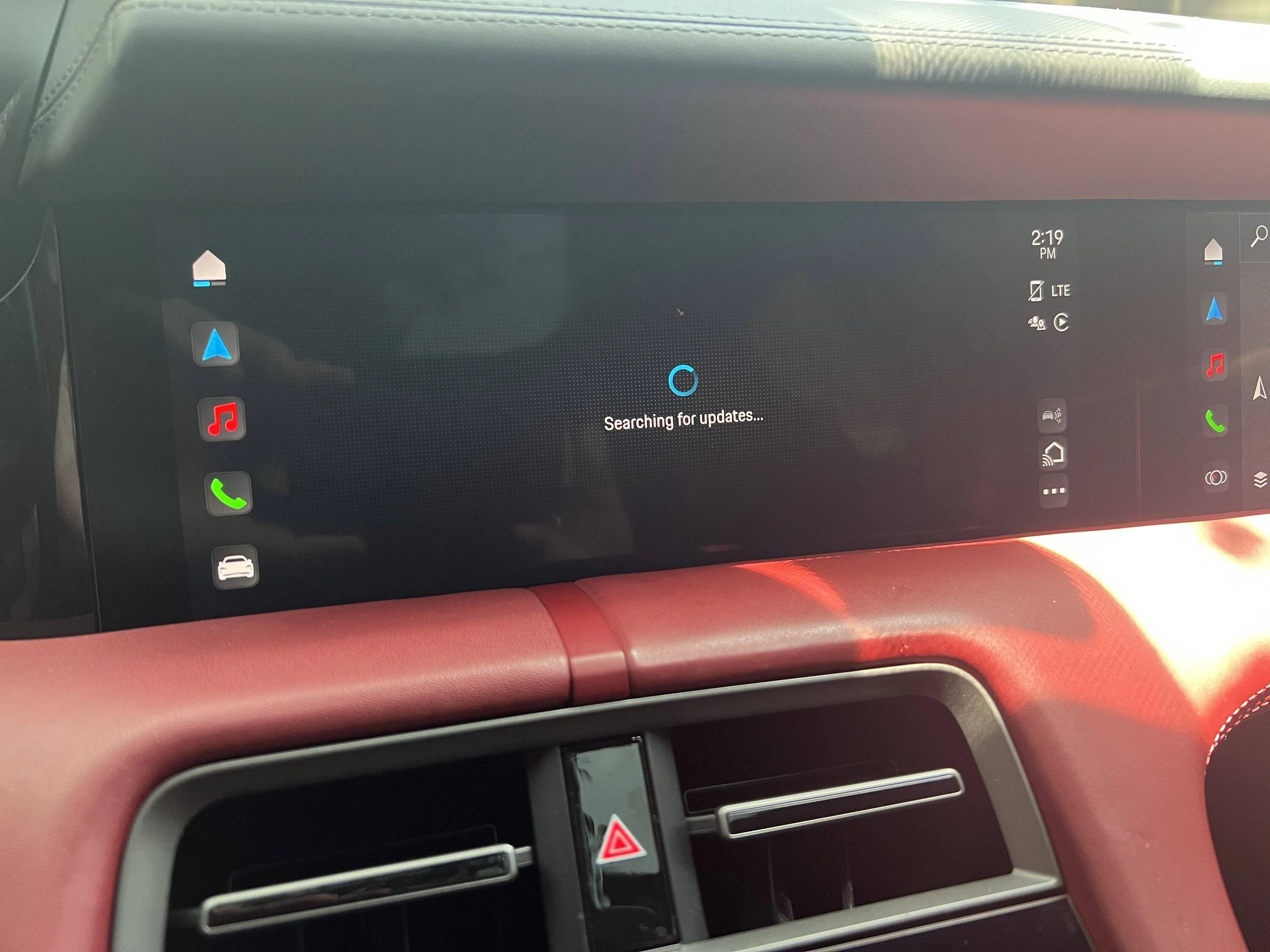

I’m sitting in my car watching the updates app for 10 minutes now as it is ‘searching’ for updates / no idea if it is actually downloading in background but not exactly transparent nor promising at the minute - patience apparently required!!
Tried powering off again in case already downloaded but no prompt appeared to install so I guess not.
Have full 4 of 5 bars LTE embedded SIM card connection so that’s not the issue.

Yes and point is you need the update to have downloaded to proceed which (download) only happens when car is ‘on’ - nothing yet and again, the update app is stuck in a spinning wheel with car on which either suggests it’s actively downloading in background and not telling me or is stuck - again, I have a full LTE SIM connection active.

Well after 15 mins with everything correct to receive I'm getting nothing but a spinning update wheel - guess the servers may have been hit hard or its just not ready for prime time ... will try again tomorrow!

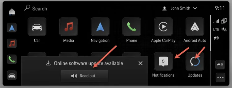

According to the video, you have to have OTA Updates enabled on the my.porsche.com website, so login and check that is enabled first.
If OTA is enabled, the update simply downloads in the background (no user action required to initiate download). Once downloaded you will get a notification on the PCM screen that it is available to install.
If you happen to miss the notification, you can see it under "Notifications" on the PCM Settings screen, and the Update will appear under the "Updates" icon.
Porsche Taycan OTA Software Update (July 17, 2023)! 1689624177921
My update hasn't appeared yet.
