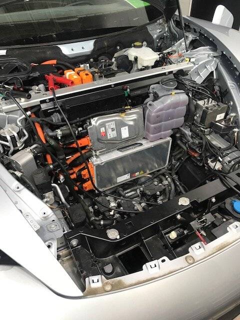

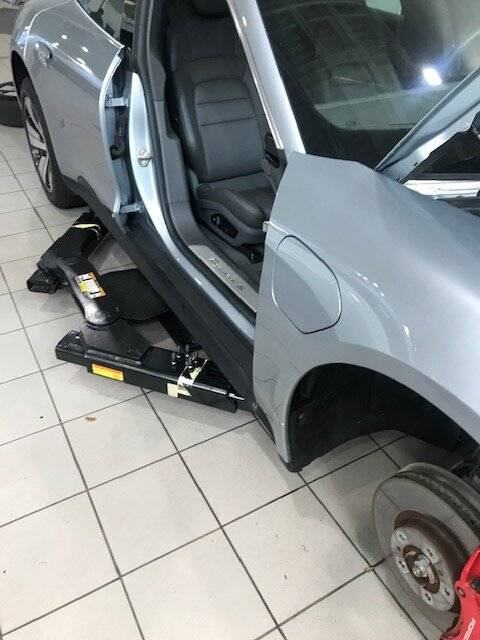

I did the 22 KW Charger Upgrade on my 2020 4S mostly to get Plug and Charge capability. As mentioned it is helpful when you encounter a more potent Level 2 destination charger. As far as costs go the 22 KW charger kit is $2K. My dealer never did this update before and charged me $5400. To make the story more ugly the car was throwing electrical system fault afterwards which was traced to an improperly seated HV connector. Part of the kit are two new charge sockets which to install require the front doors to be removed. I was able to qualify for a tax credit towards the cost of the charger. As a non-business user the charger tax credit is capped at $1K however if it is part of a business you can get 30% tax credit.

I don't want it badly enough to fork over $5k and then have the car throw codes.
