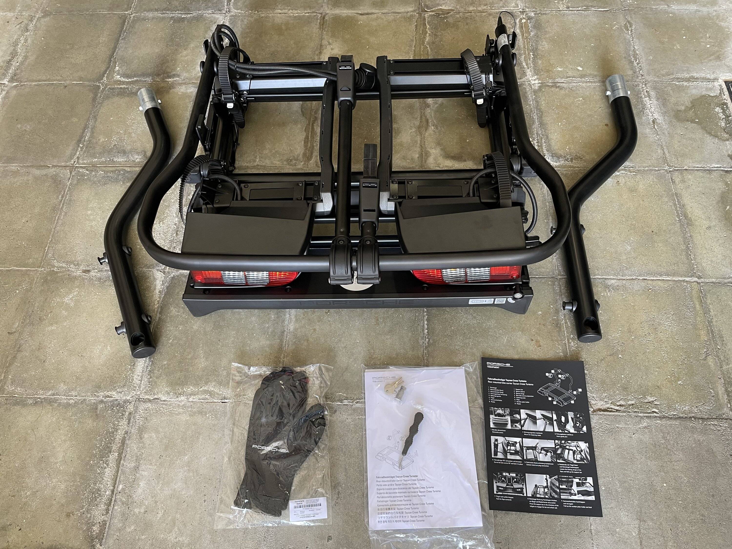

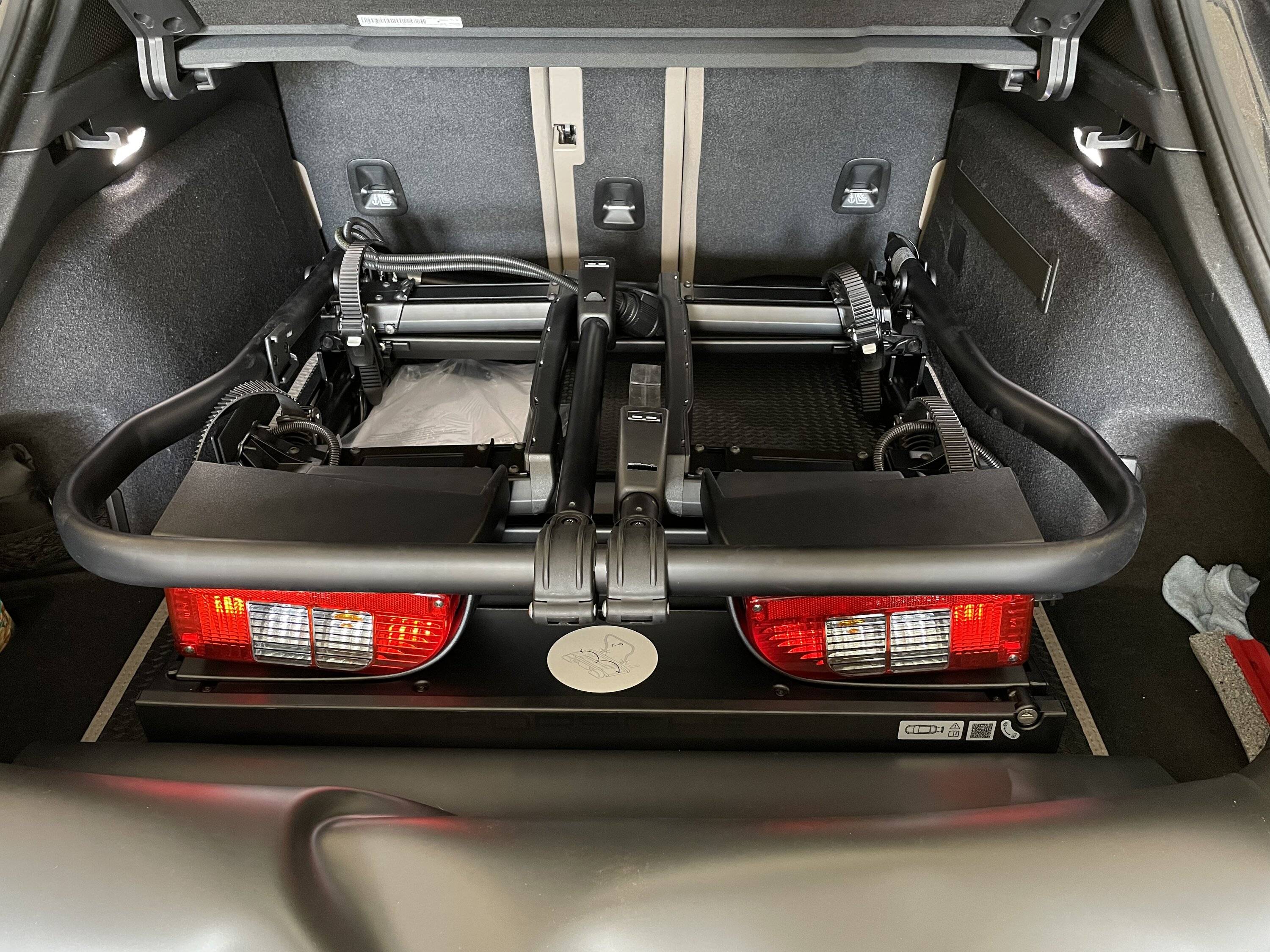

This is what you receive in a box on a europallet:
Porsche Taycan Porsche Bike Rack (step by step picture of the installation) 43250CEC-C57F-46EB-9143-543C902DDB95

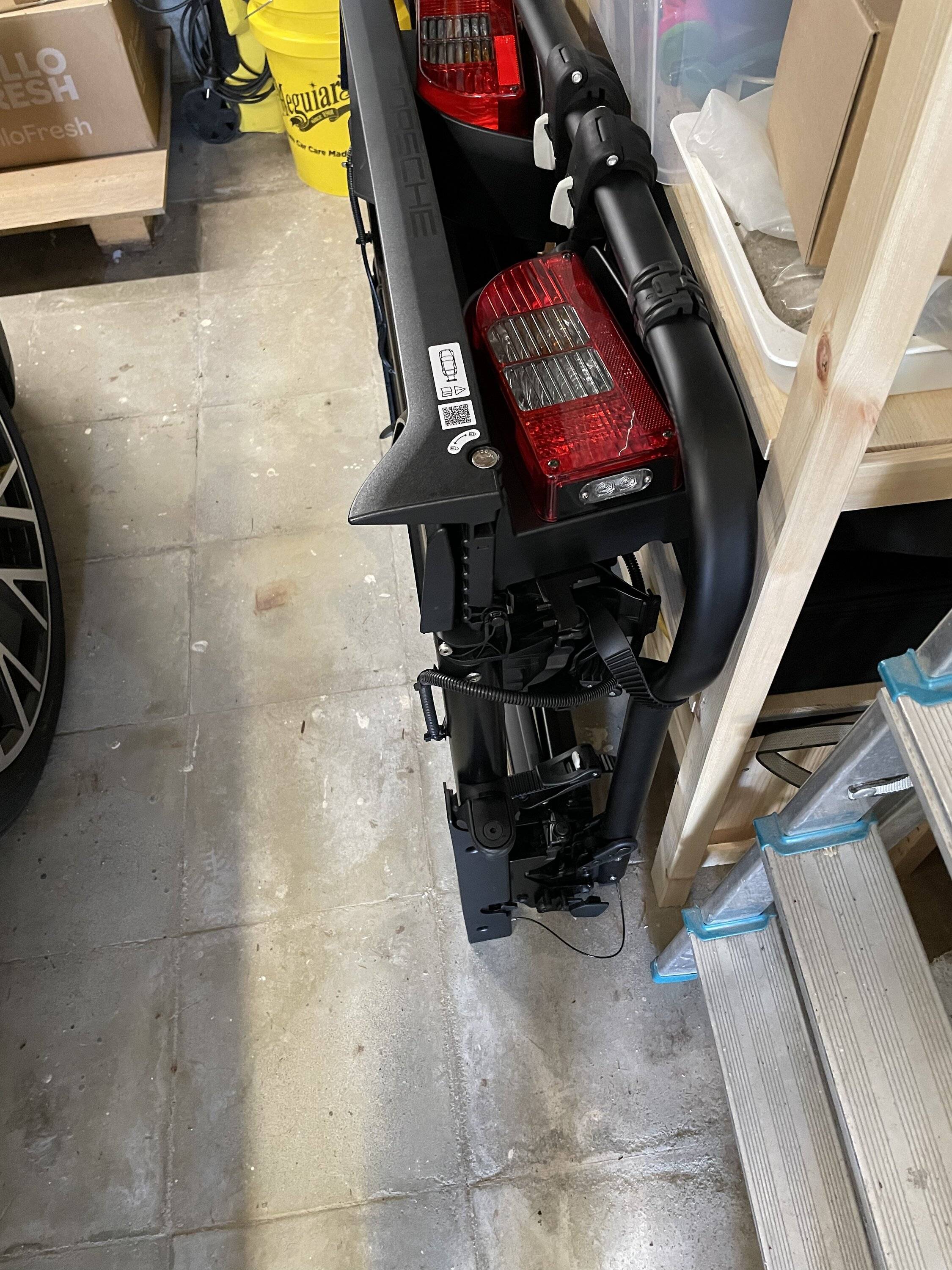

It fits in the boot no problem once folded

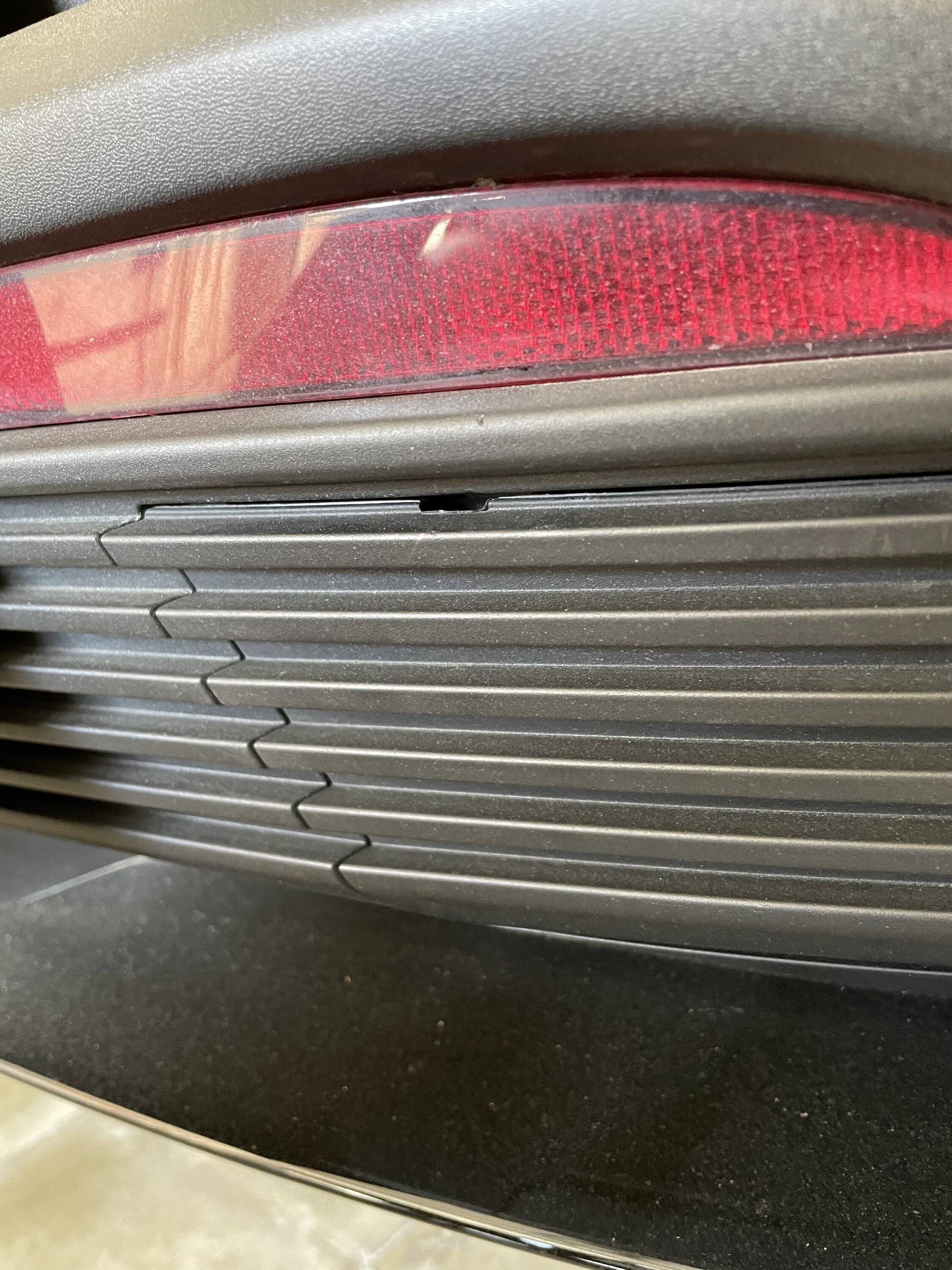

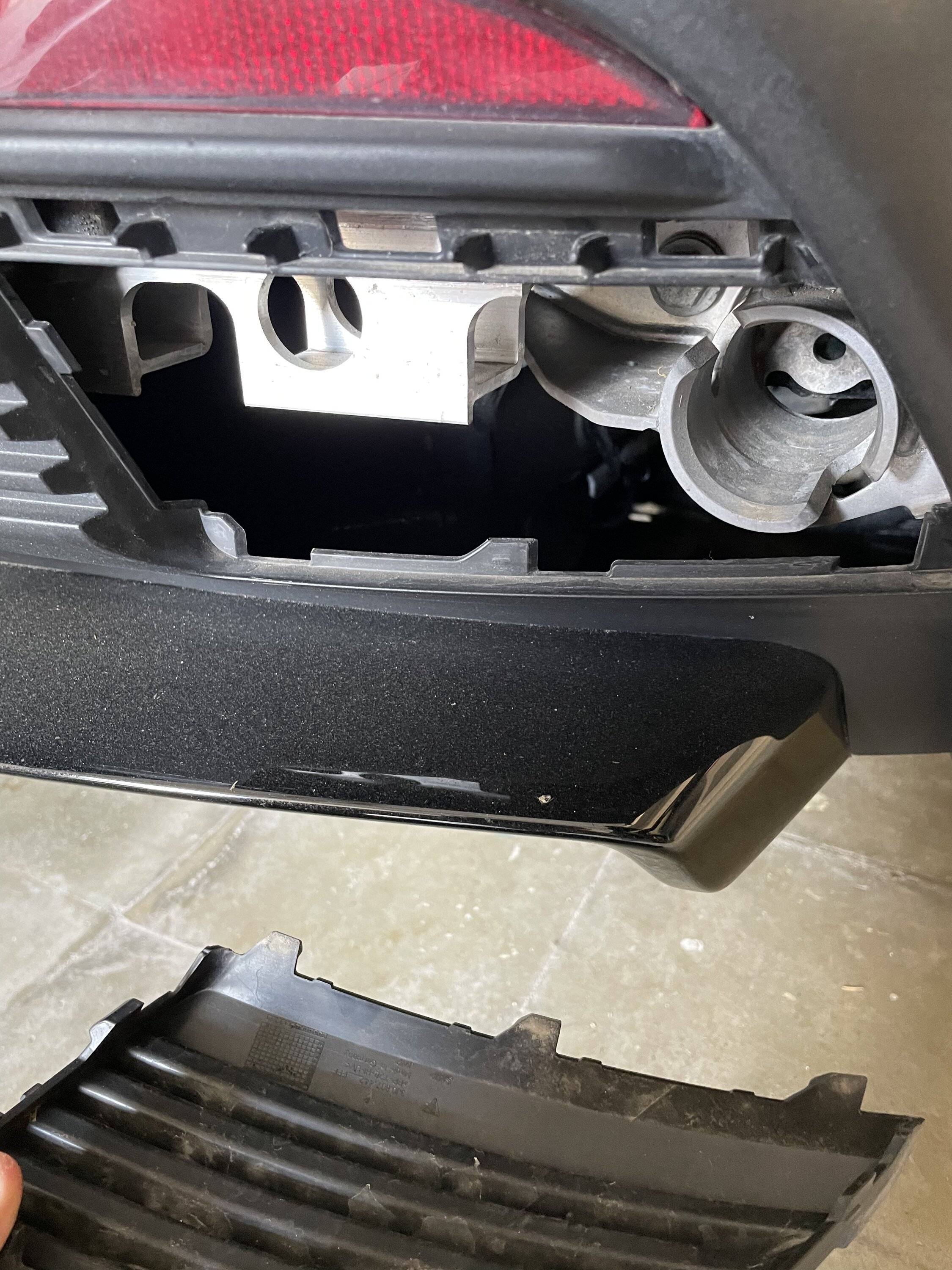

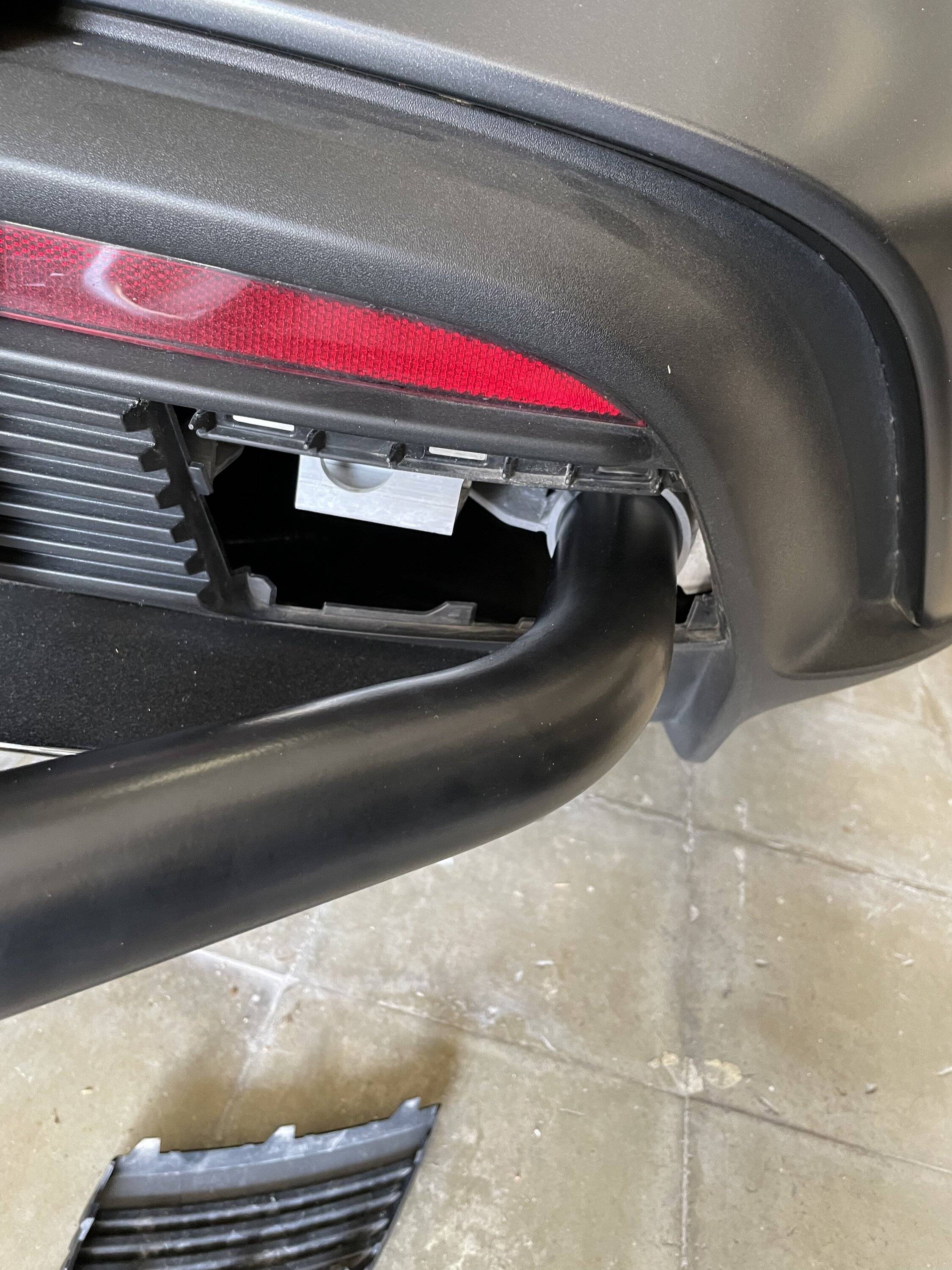

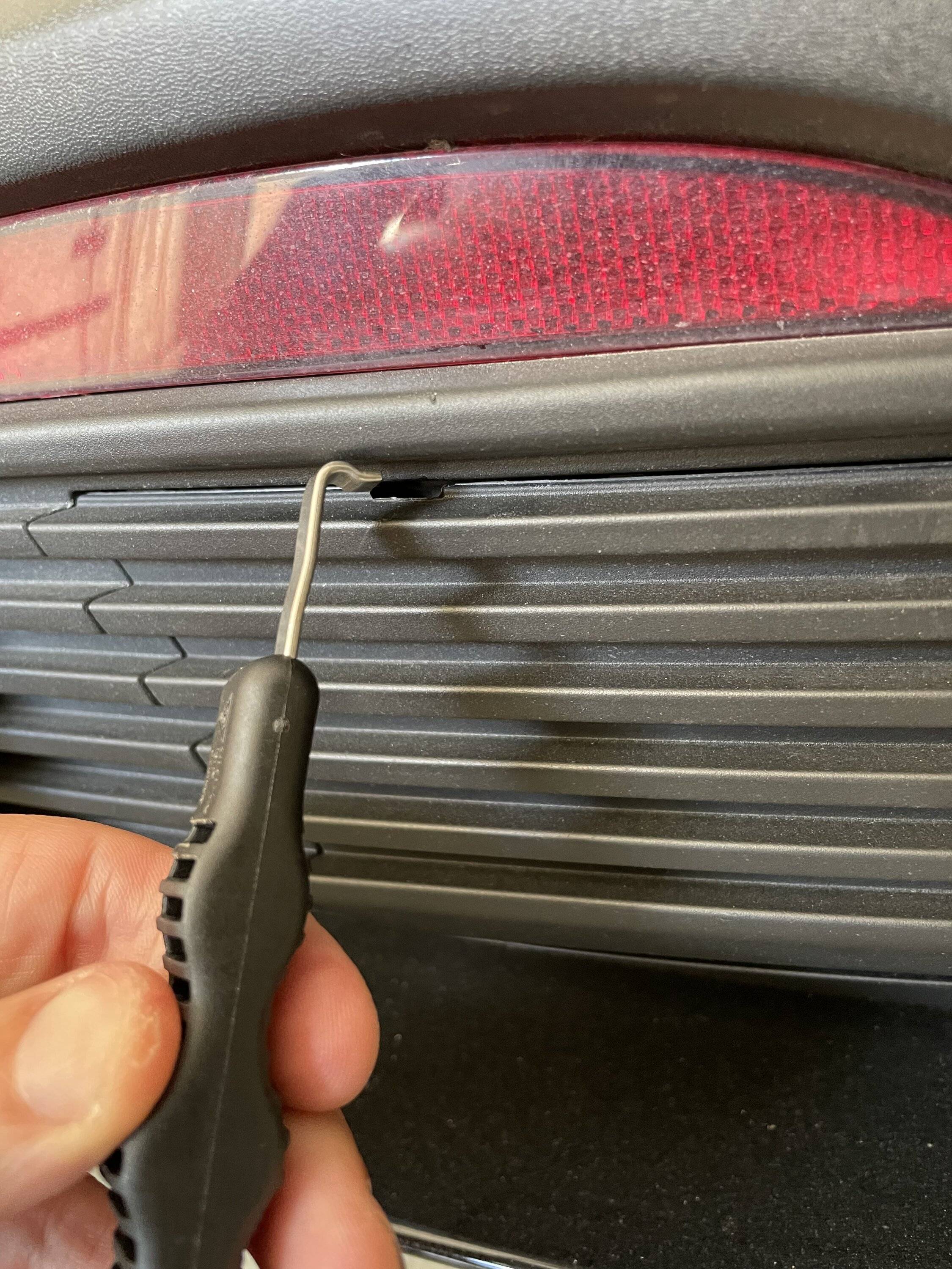

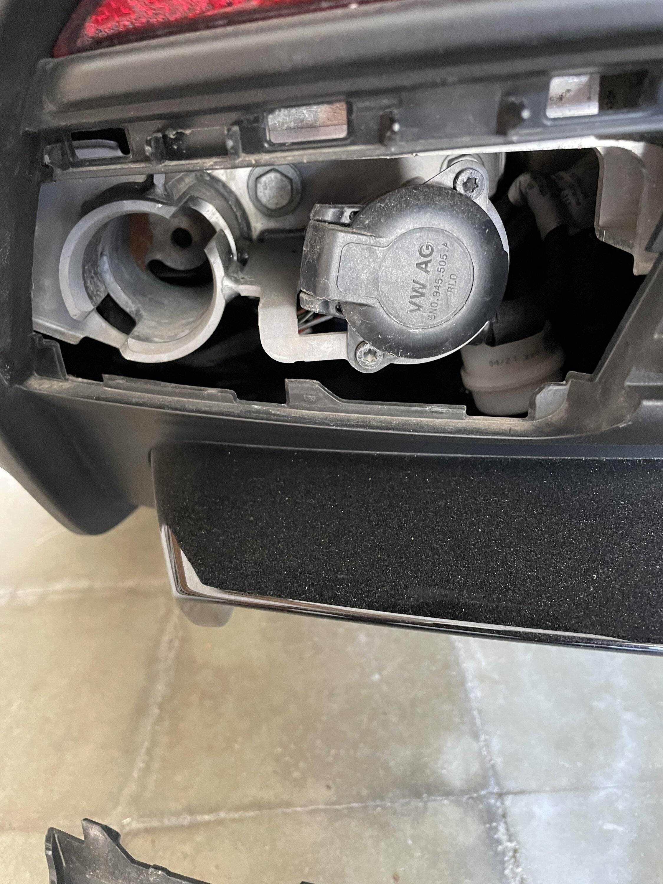

You have to remove the cache with the given tool
Porsche Taycan Porsche Bike Rack (step by step picture of the installation) 3819FF19-1BFF-4AB8-9A13-C4F918F80955
Porsche Taycan Porsche Bike Rack (step by step picture of the installation) AF9CFA16-38D3-42A5-9C0D-30F07E69F047
Porsche Taycan Porsche Bike Rack (step by step picture of the installation) D8DFFD48-CB68-409A-A306-3D080F32771F

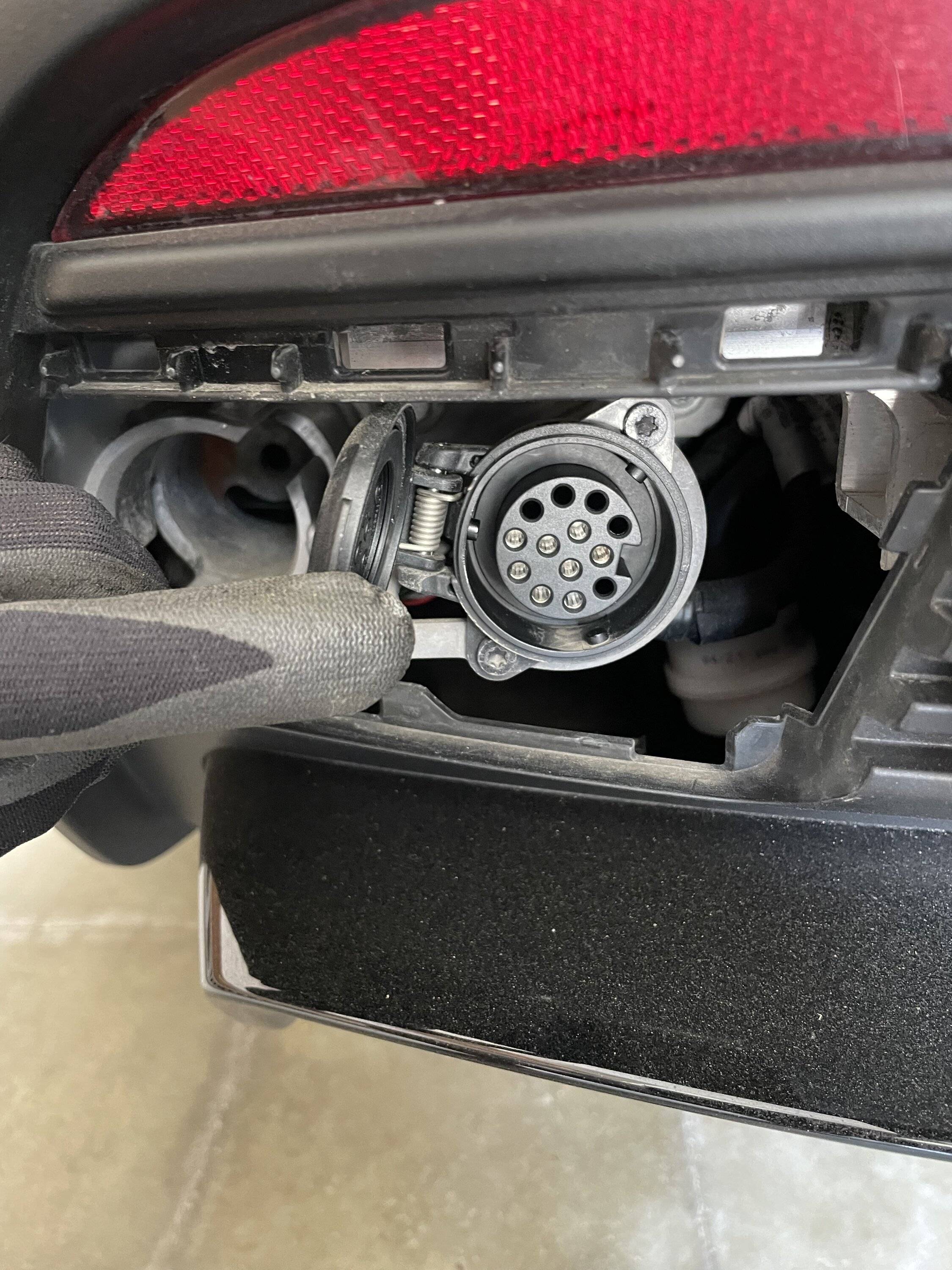

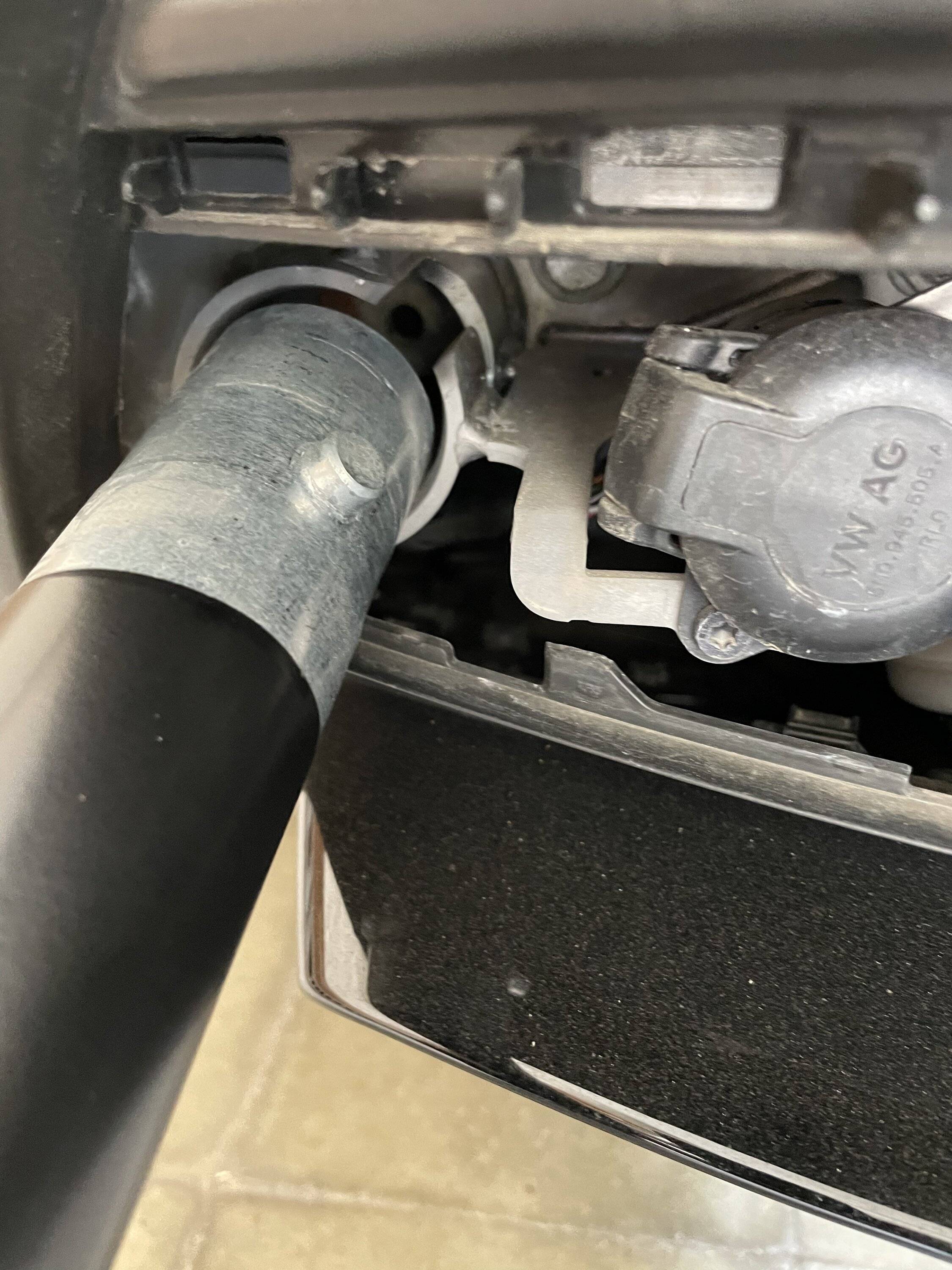

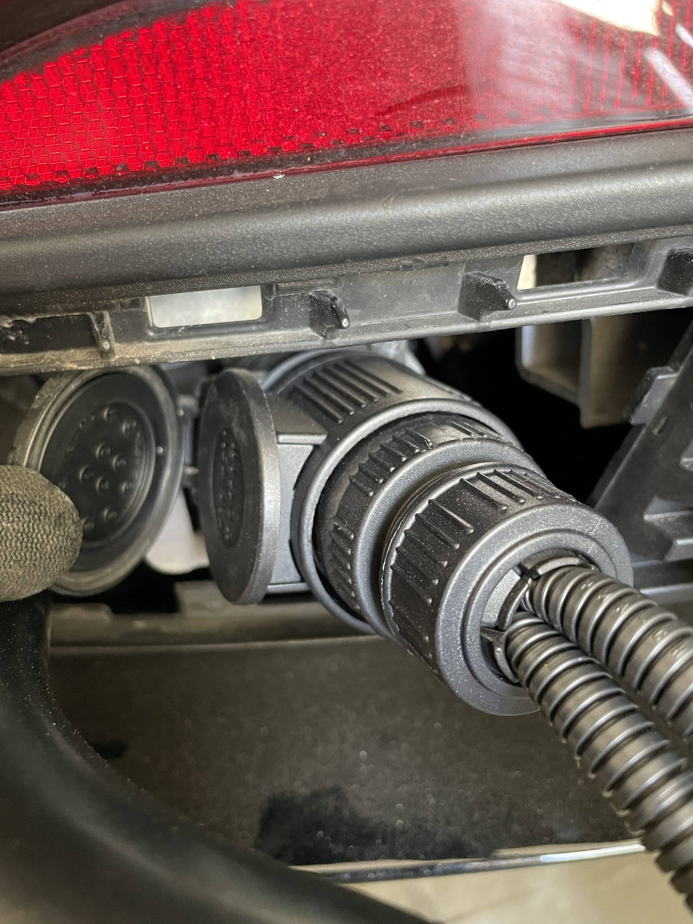

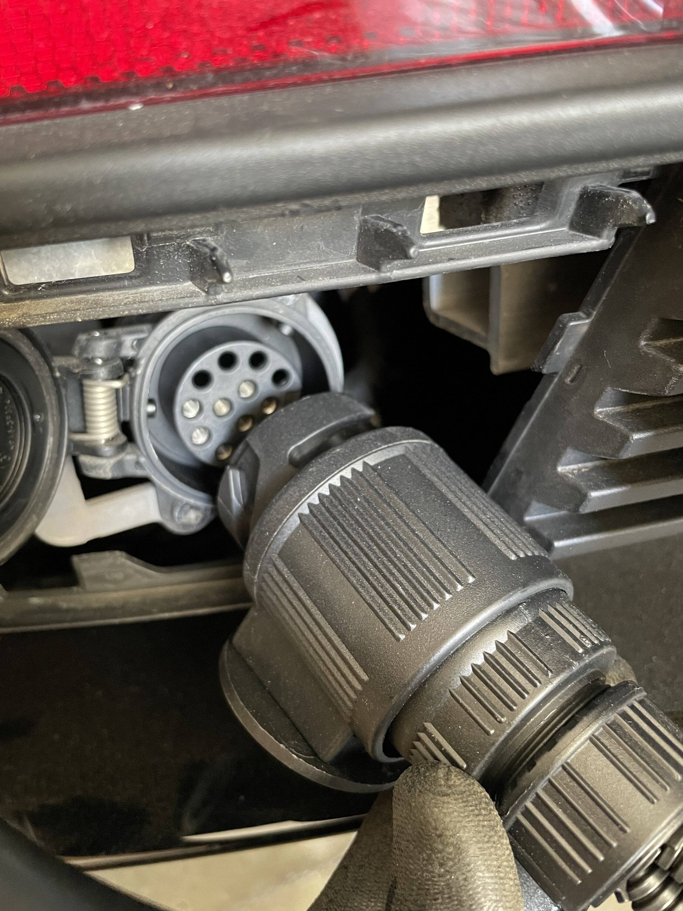

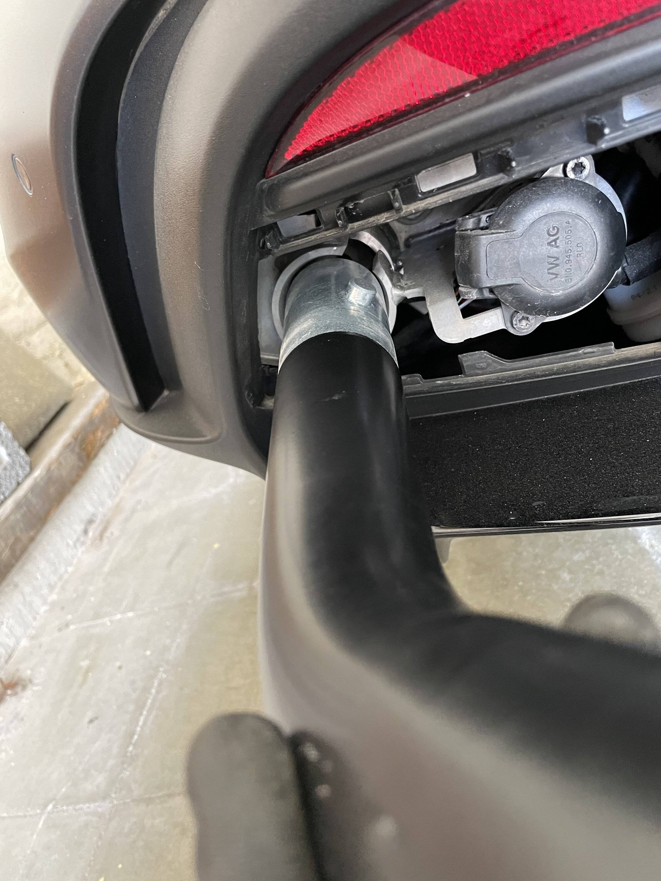

The left side has the plug
Porsche Taycan Porsche Bike Rack (step by step picture of the installation) 83110AEF-E1E4-4915-8020-8CAED475C1B3
it’s the new type of plug in Europe
Porsche Taycan Porsche Bike Rack (step by step picture of the installation) 1134E0BB-8E05-46BB-AAD1-82860D009C07

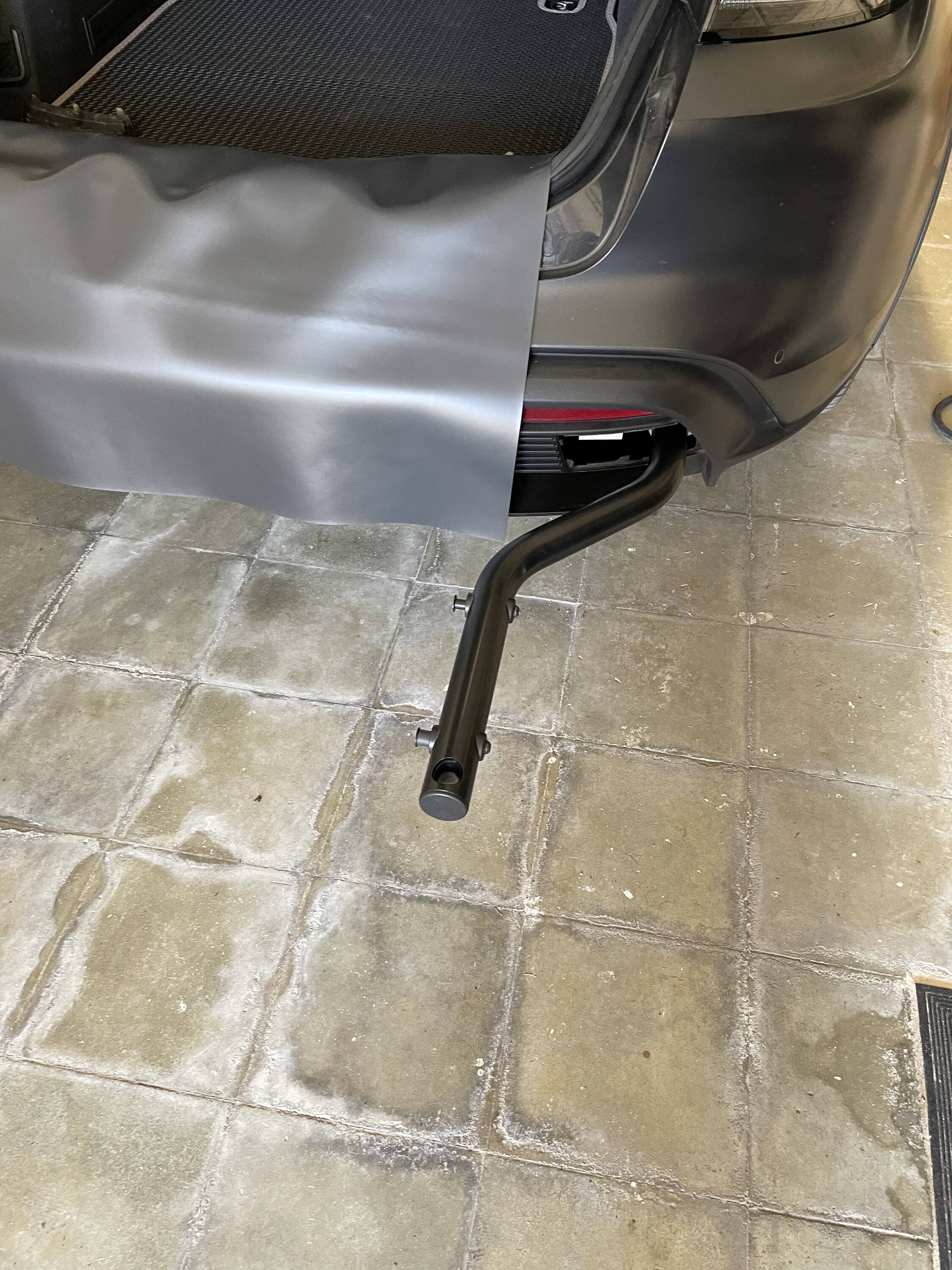

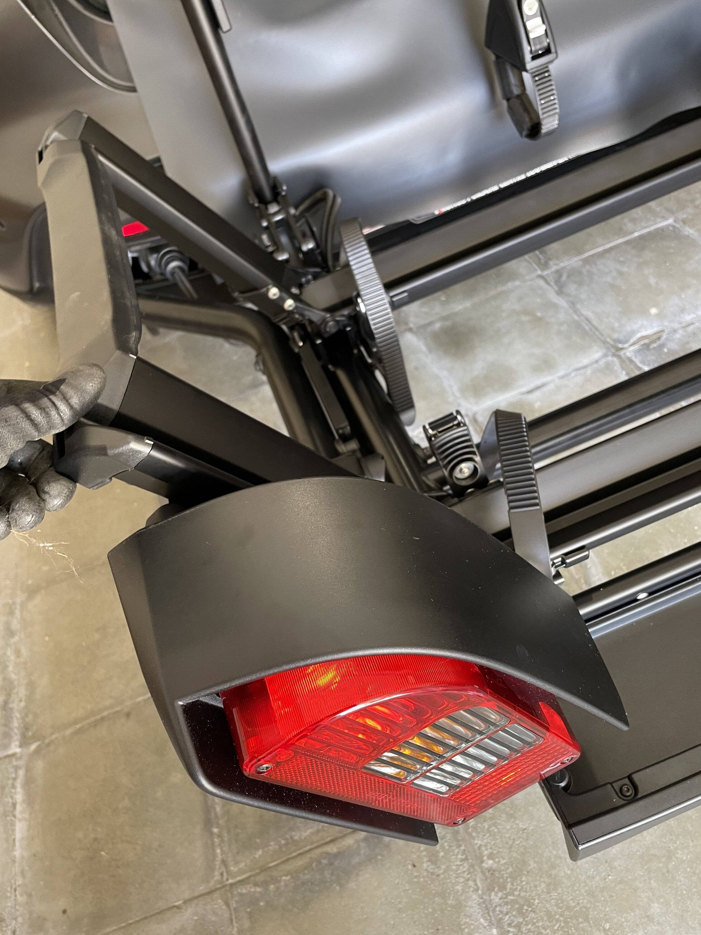

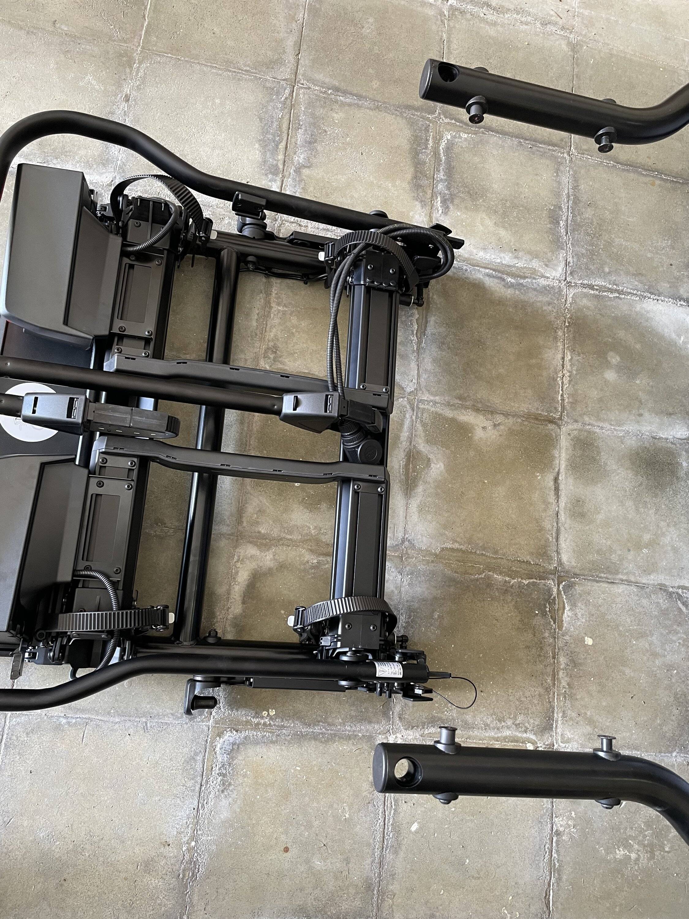

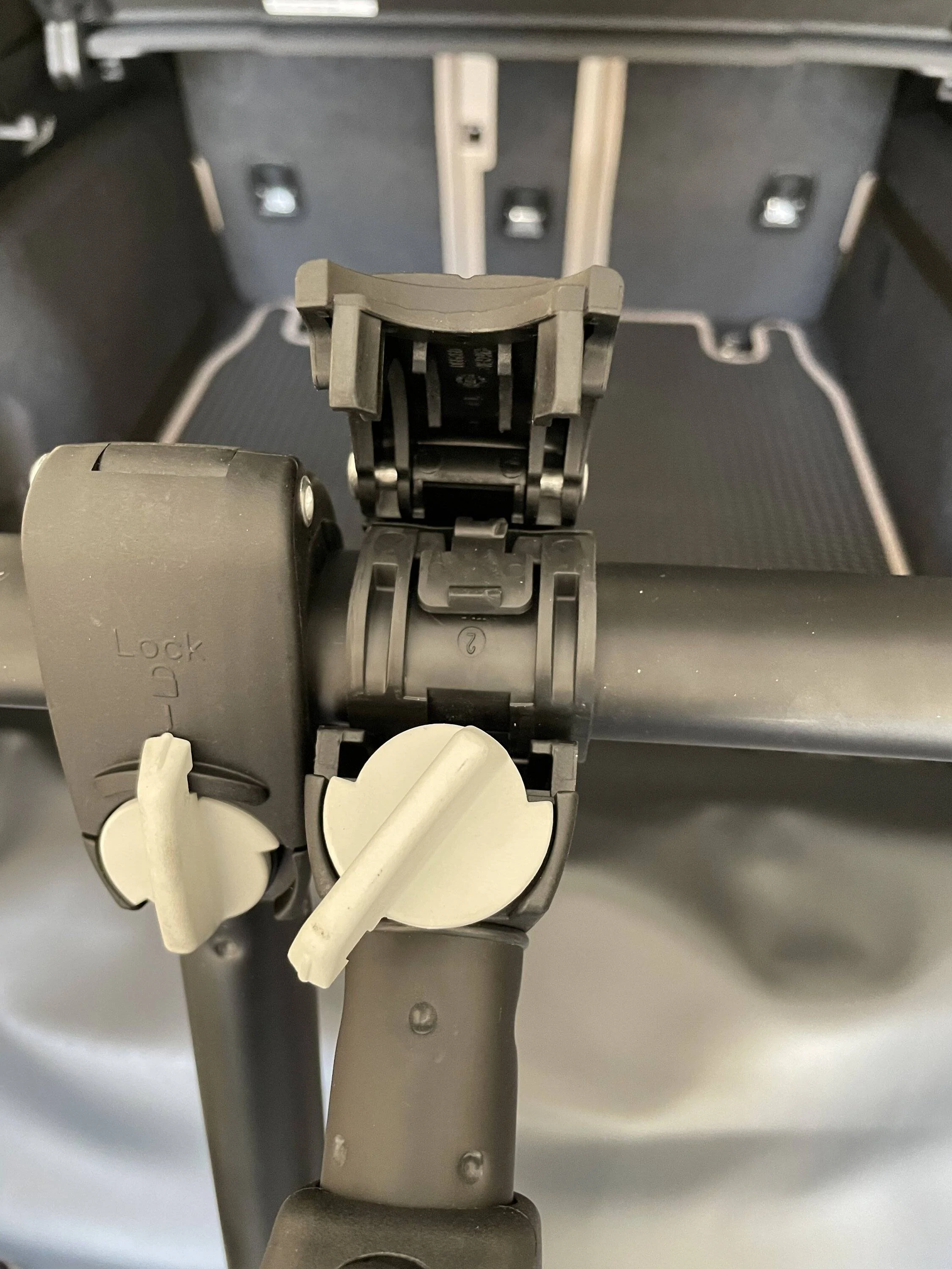

you have to put the bars in the holes and turn them
Porsche Taycan Porsche Bike Rack (step by step picture of the installation) 0AF44F3F-FA4D-4A3B-9D8A-9D9226AF9BE7
Porsche Taycan Porsche Bike Rack (step by step picture of the installation) CAC3C835-688A-4C35-B5FE-15B6F51FD390
Same on the other side
Porsche Taycan Porsche Bike Rack (step by step picture of the installation) C32772B5-FC1D-4329-900C-1EDD70281E09
Porsche Taycan Porsche Bike Rack (step by step picture of the installation) A1FCB220-9EC8-4625-9C89-7B2203C30A56

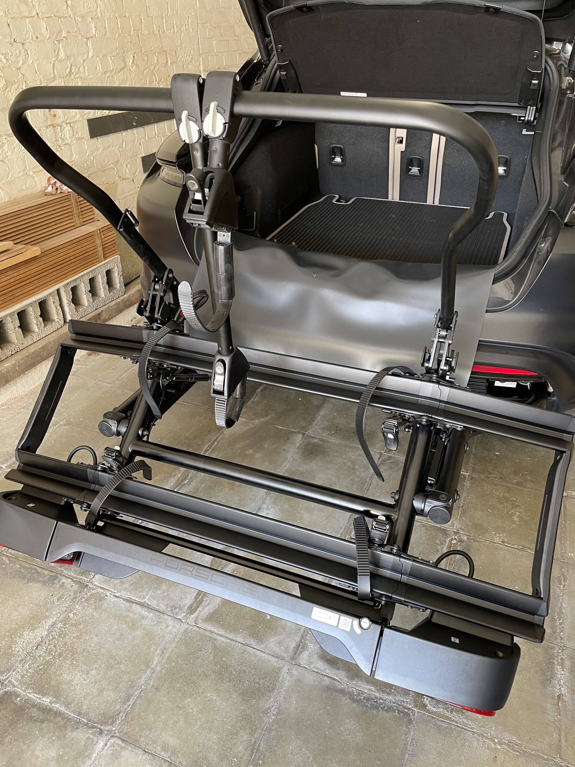

You now have to put the rack on the holes but once you know what to do it’s easy. You should start with the rack in vertical
Porsche Taycan Porsche Bike Rack (step by step picture of the installation) 3CE8131E-B891-4A02-BFA6-D3D808DED16E
Porsche Taycan Porsche Bike Rack (step by step picture of the installation) F0E587CA-4D4B-4D28-BF19-AB3F93C36CA0
Porsche Taycan Porsche Bike Rack (step by step picture of the installation) 312F94DF-6346-4D42-A6F8-8A80BF734814
Flip it horizontally hard enough and it clicks into place and is locked
Porsche Taycan Porsche Bike Rack (step by step picture of the installation) 0506959C-F476-485B-8754-21D7DBD1365D
plug and twist the ring
Porsche Taycan Porsche Bike Rack (step by step picture of the installation) 360F21A2-1D62-49B3-87C9-DB4AD567587E
Porsche Taycan Porsche Bike Rack (step by step picture of the installation) 16CB2CB3-060D-49A6-8BB0-6423356EF1AD

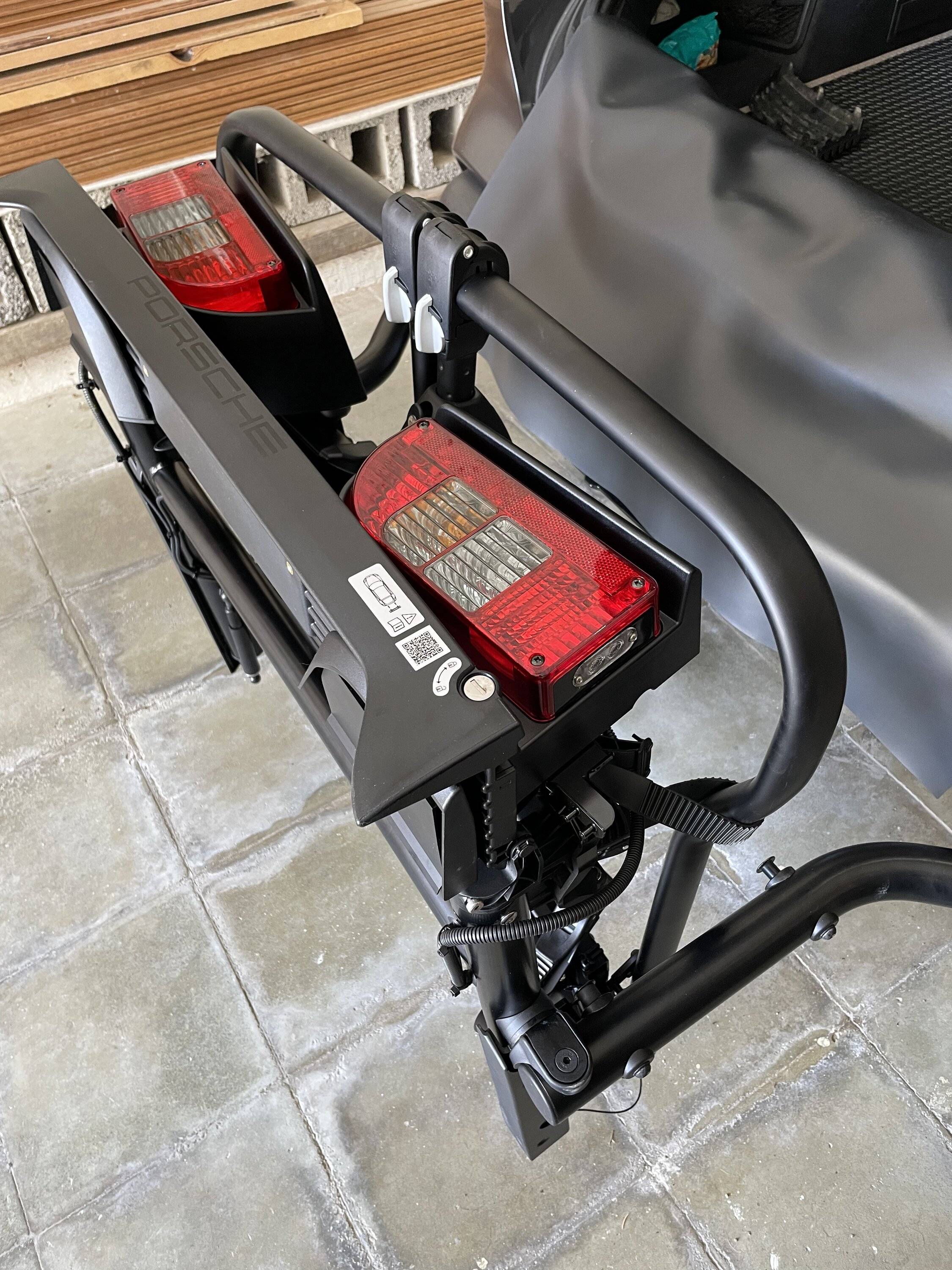

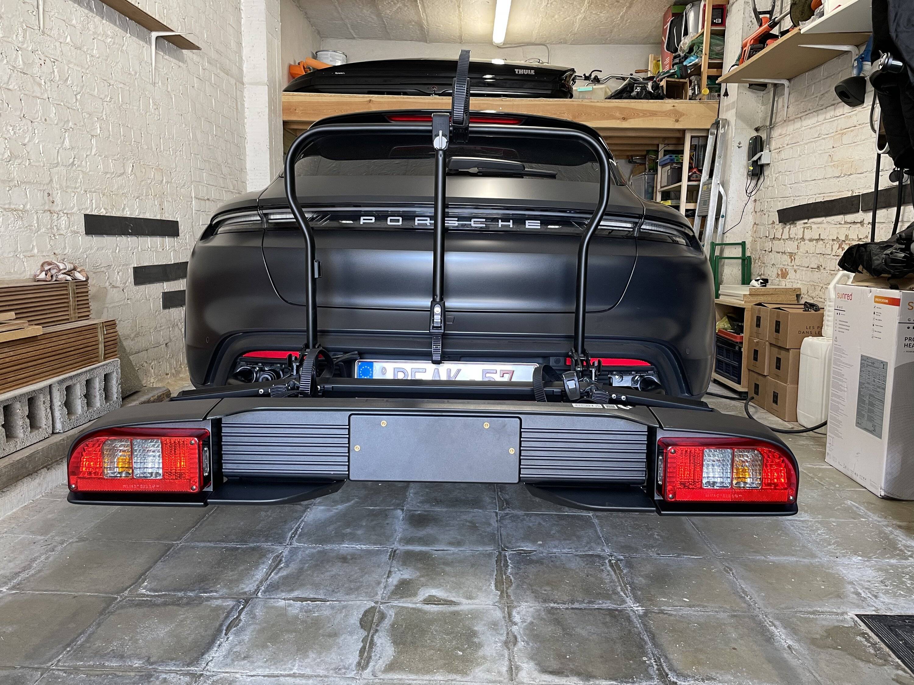

Unfold the rest and it is nearly ready
Porsche Taycan Porsche Bike Rack (step by step picture of the installation) B03B0CCC-B262-4518-A766-DCA3E46513E3
Porsche Taycan Porsche Bike Rack (step by step picture of the installation) E1F88E64-6A33-4421-8D74-1BED8048AED4

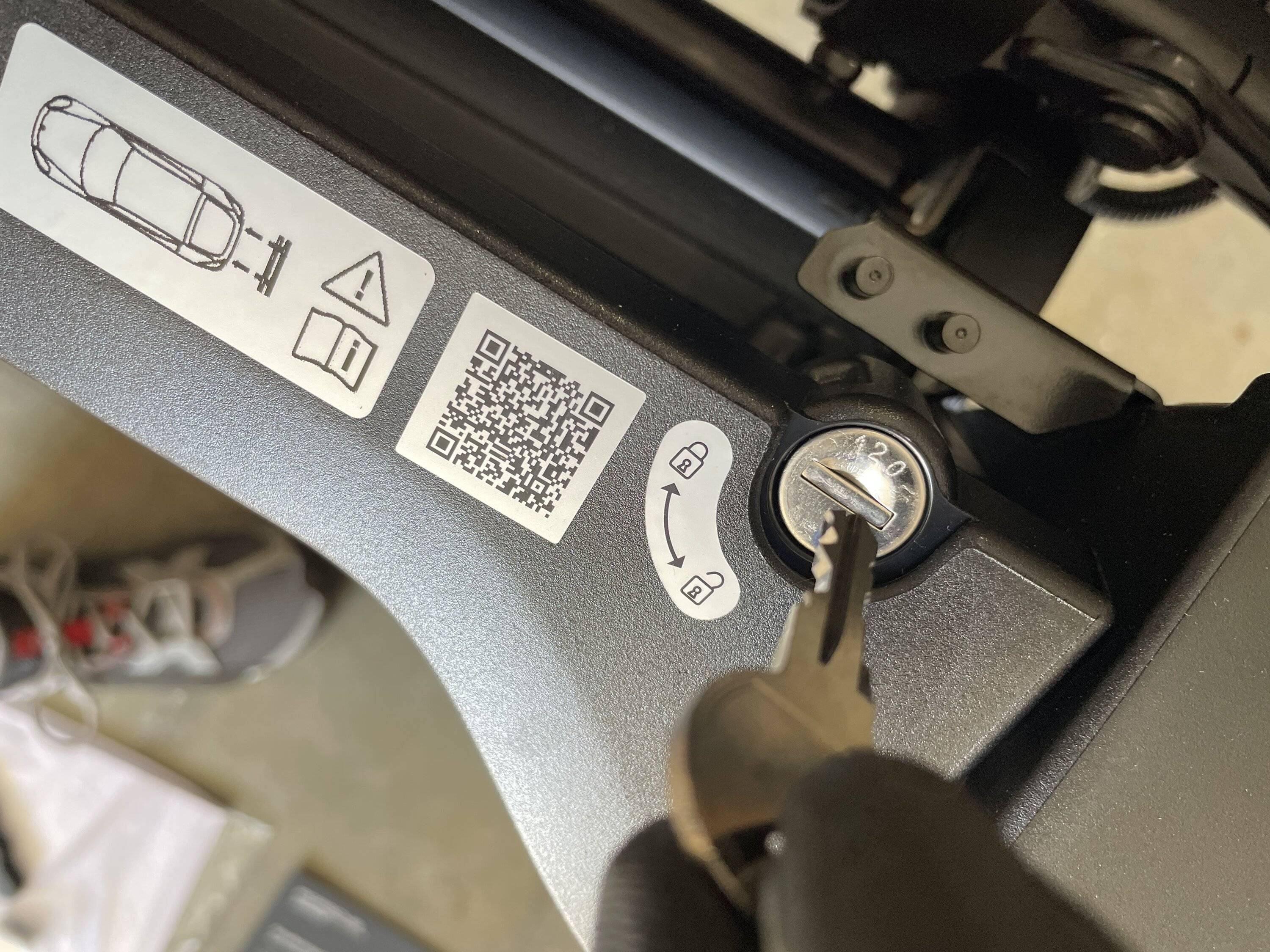

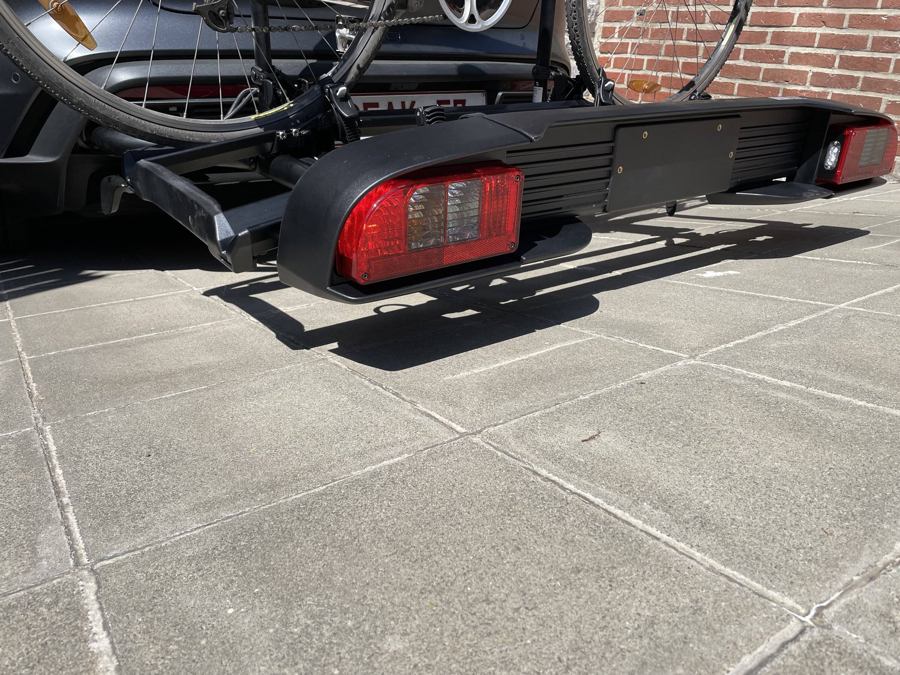

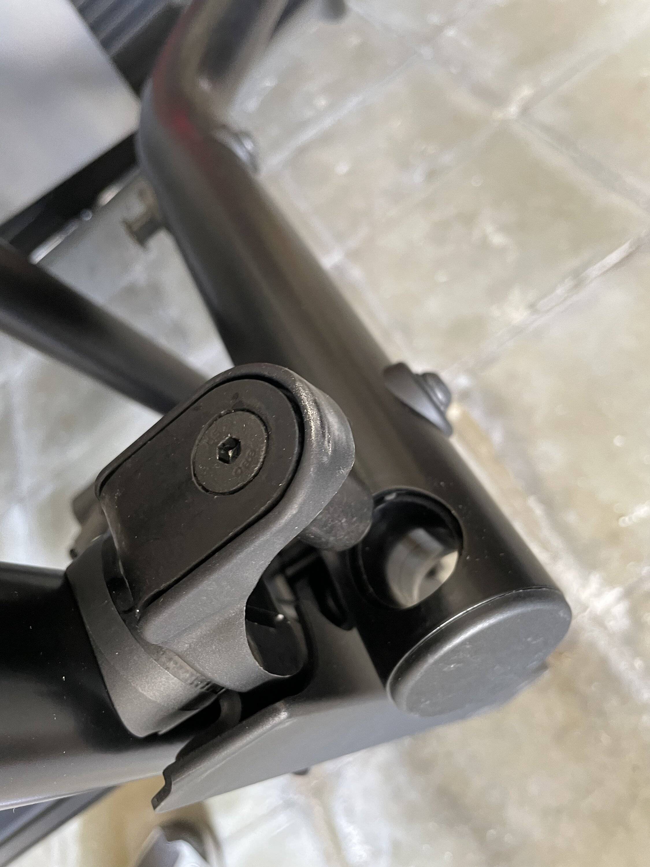

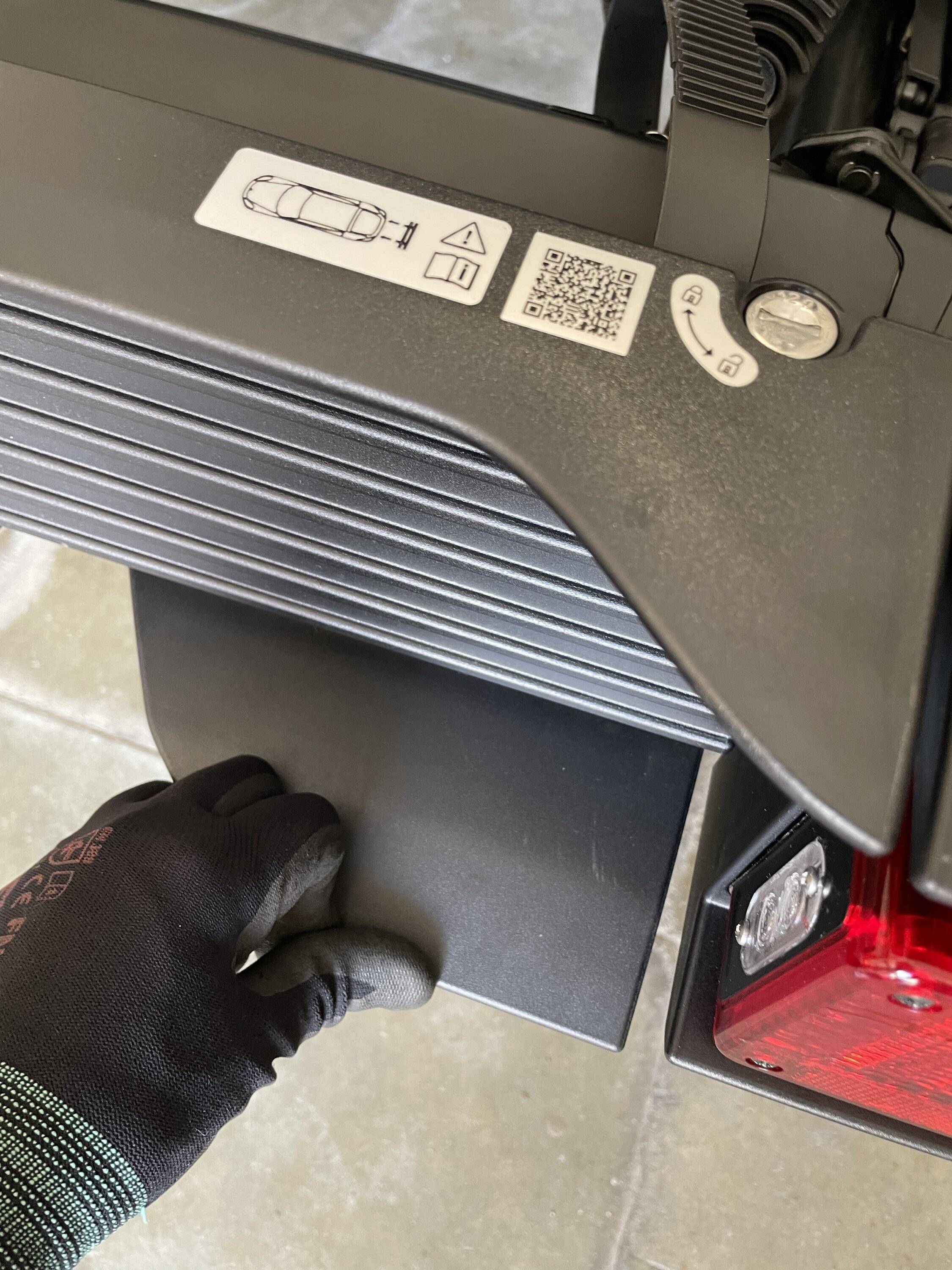

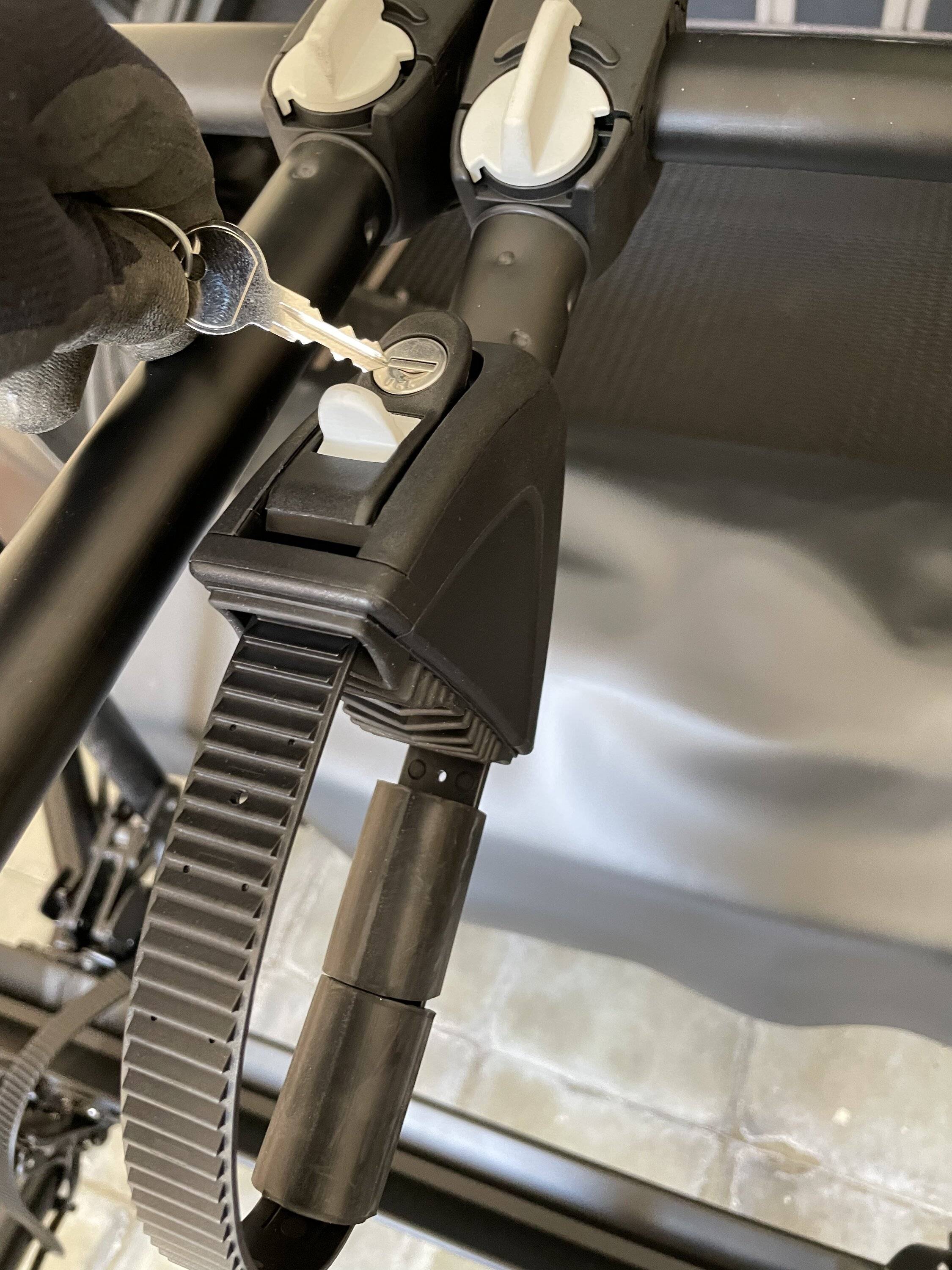

There is a key for the plate holder
Porsche Taycan Porsche Bike Rack (step by step picture of the installation) FFC20326-EB33-4BC1-8486-C6377614EFA6
Porsche Taycan Porsche Bike Rack (step by step picture of the installation) 64381639-F386-403F-AC23-419FFCCD9EDB

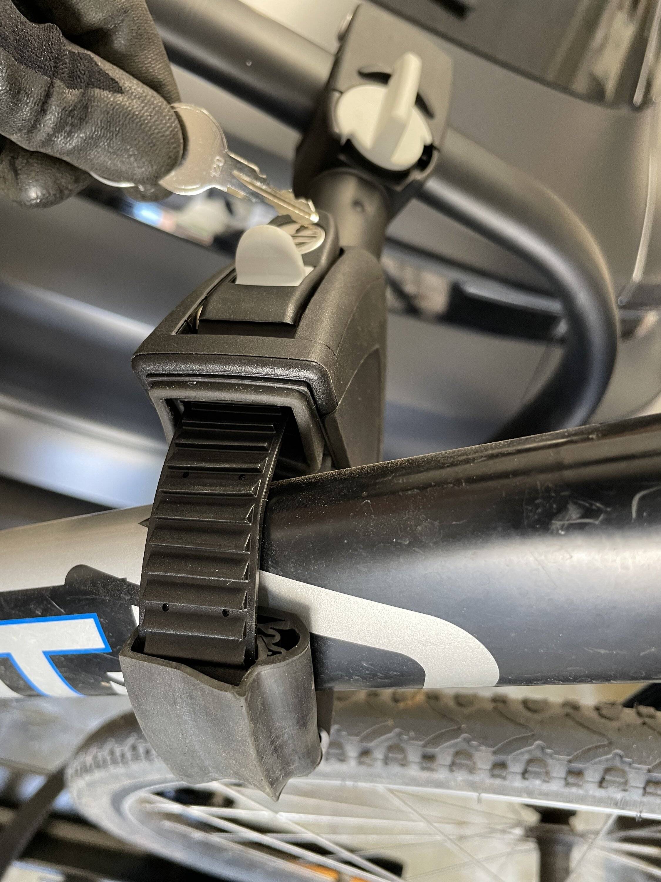

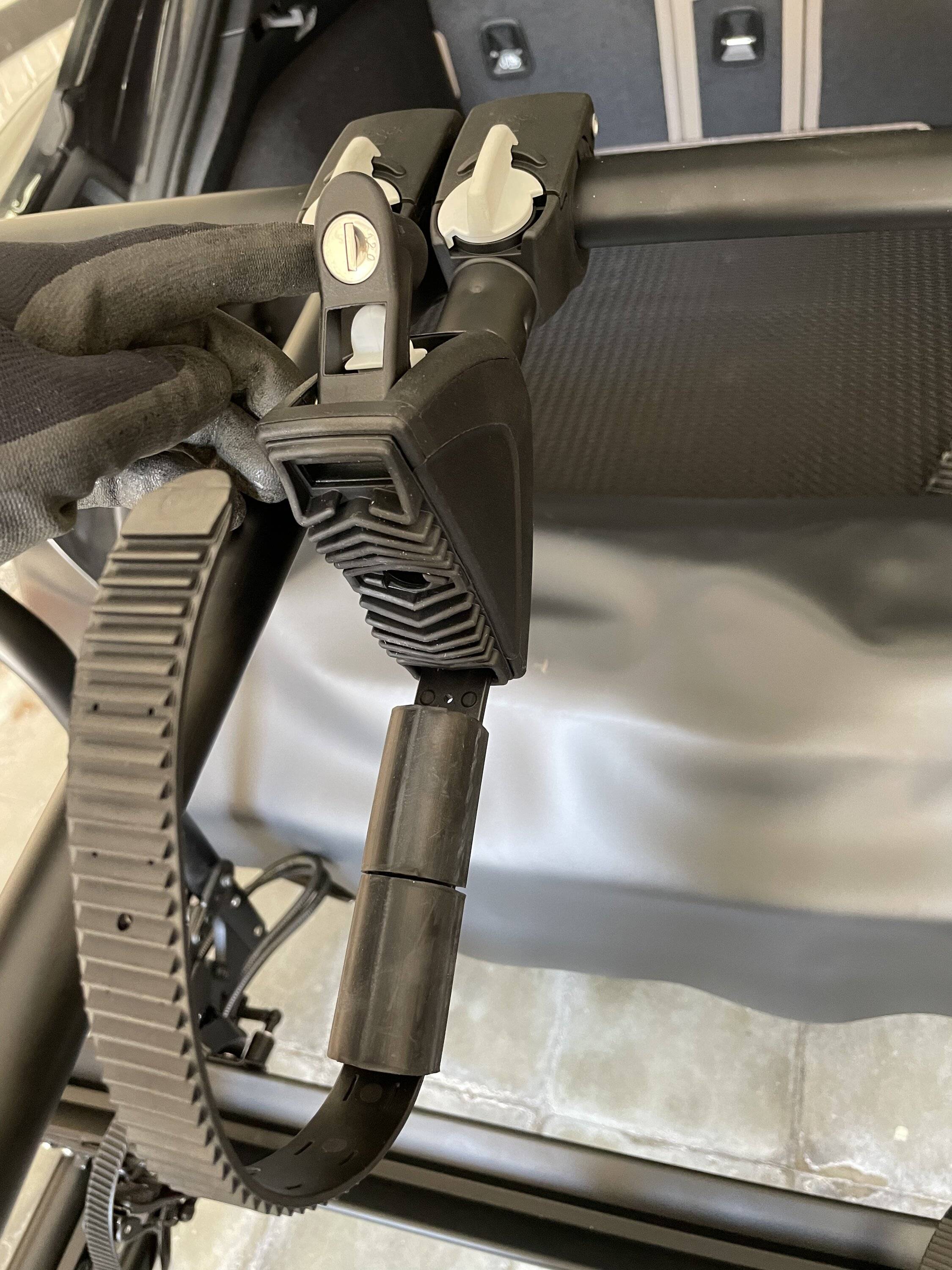

Same key to use for the bike holder otherwise you can’t move it
Porsche Taycan Porsche Bike Rack (step by step picture of the installation) 14A0CEDC-BD91-4636-A6AC-3360DC86904F
Porsche Taycan Porsche Bike Rack (step by step picture of the installation) 5AC9AB4E-F74B-44FA-A28C-D203C810F8B5

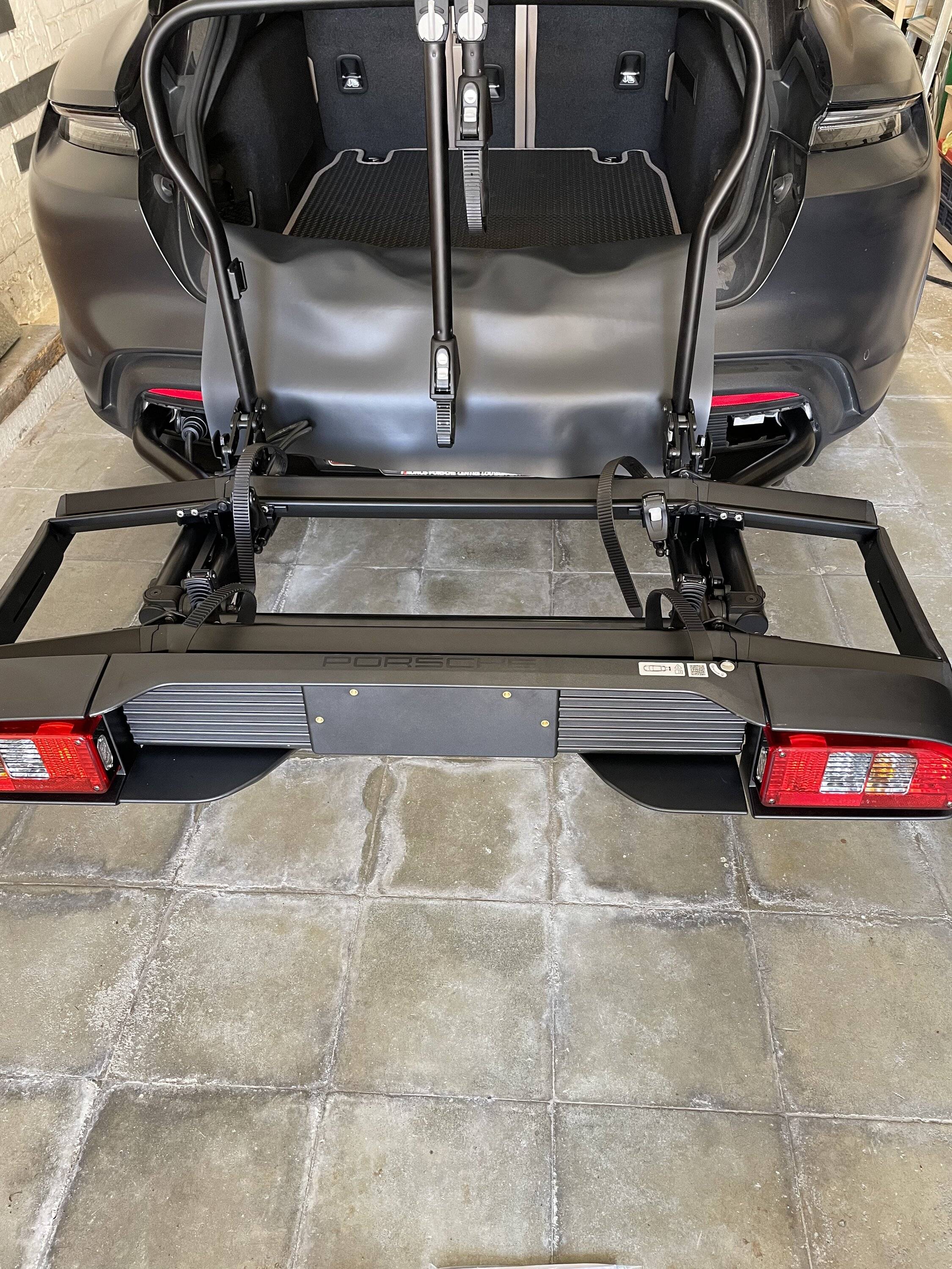

Ther is more rubber and protection than on the Thule I was using previously
Porsche Taycan Porsche Bike Rack (step by step picture of the installation) 3F45EE90-C365-4B3C-A4AD-D2E33A0CECD0

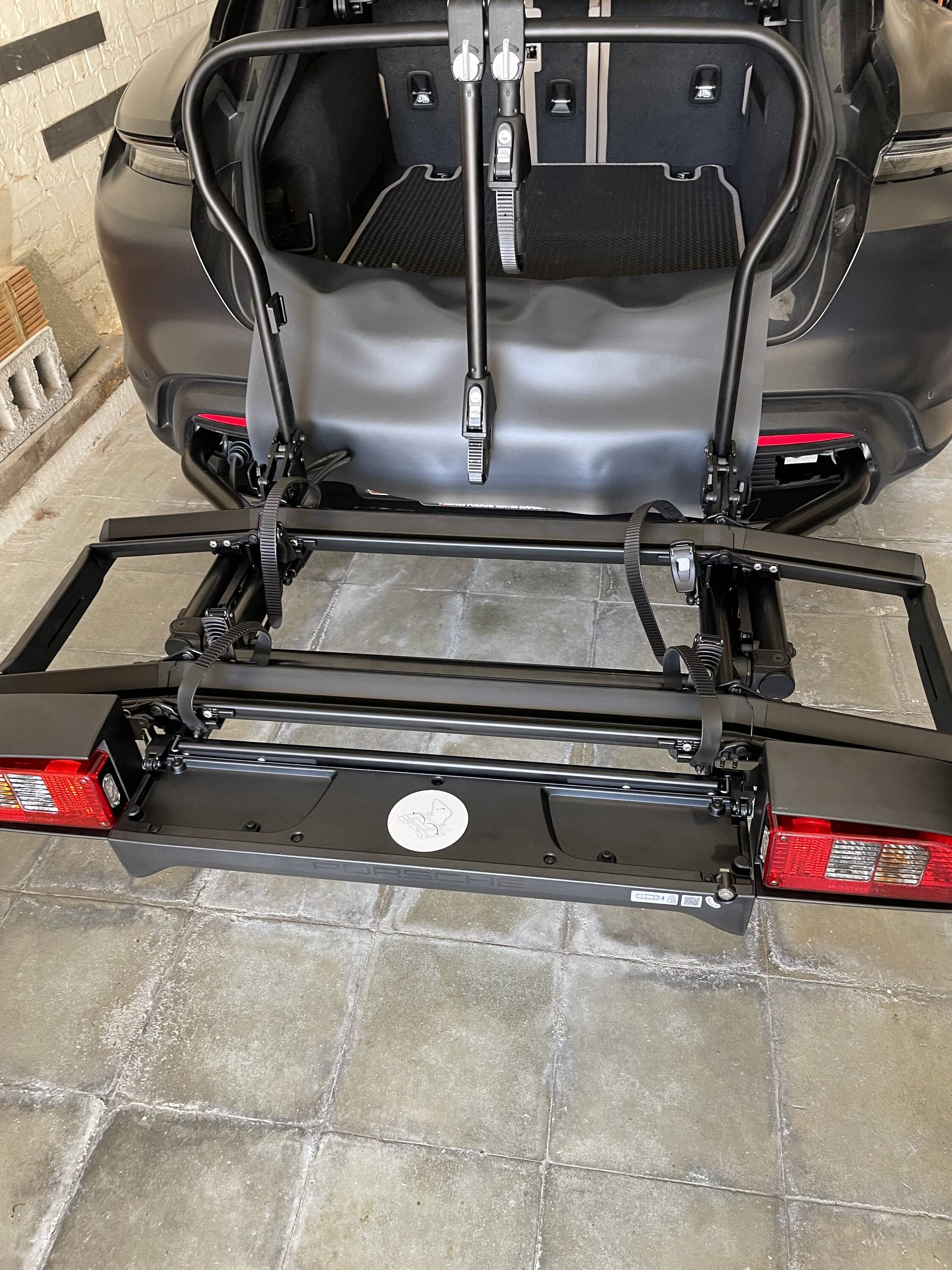

You can fold it to open the boot
And if it’s plugged the boot doesn’t open if you press on your key but only if you press on the button of the boot
Porsche Taycan Porsche Bike Rack (step by step picture of the installation) 90462667-83B9-4857-AC6D-2E4ED43BD39D

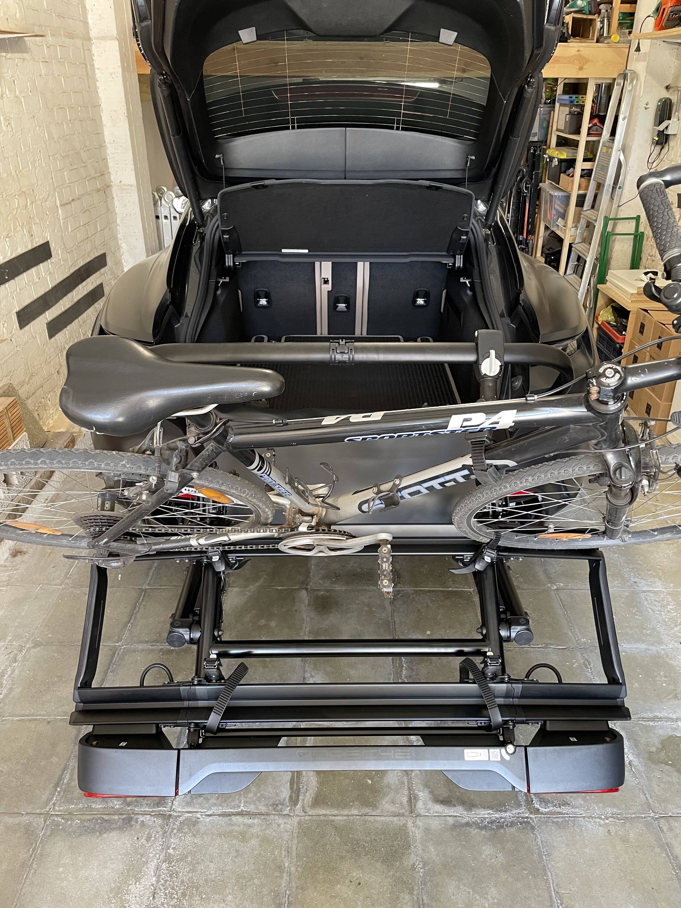

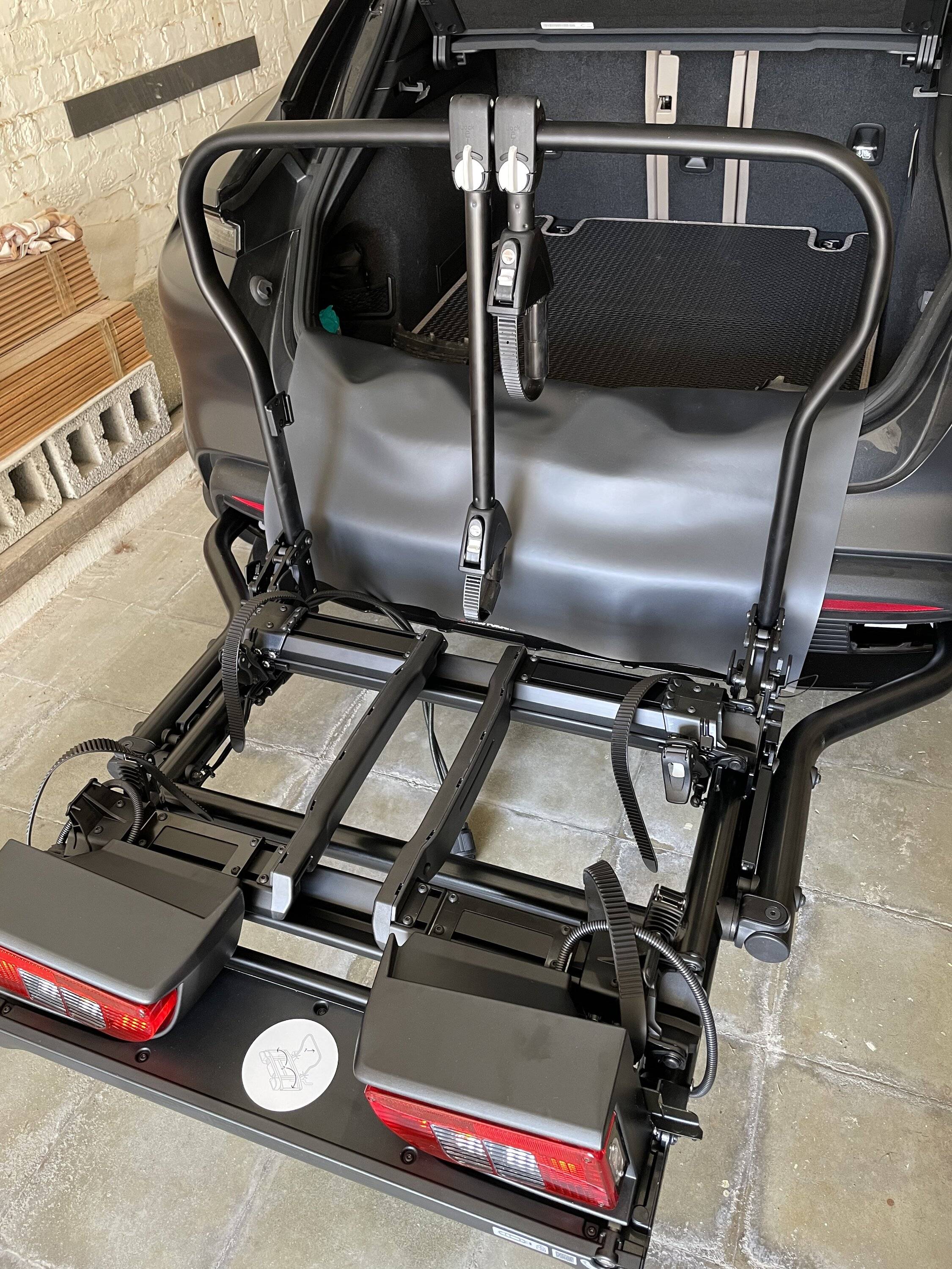

it’s really planned to have heavy electric bikes on it. There are small jacks to help you lifting the rack
Porsche Taycan Porsche Bike Rack (step by step picture of the installation) 2BBE79F7-6698-4247-9FCF-1A8769487003
Porsche Taycan Porsche Bike Rack (step by step picture of the installation) FA6A0FCA-6A74-400D-9505-978B2D2C868B

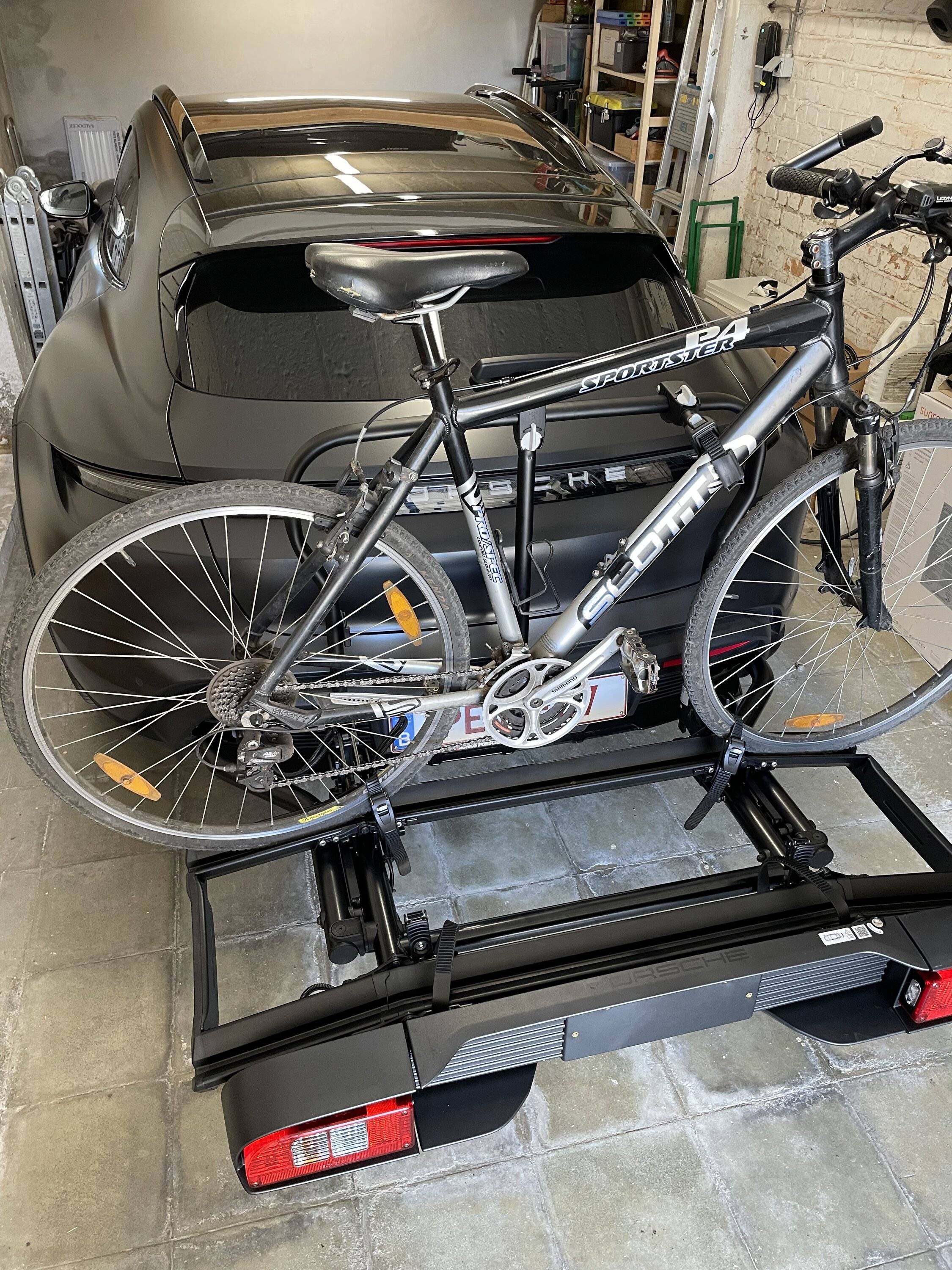

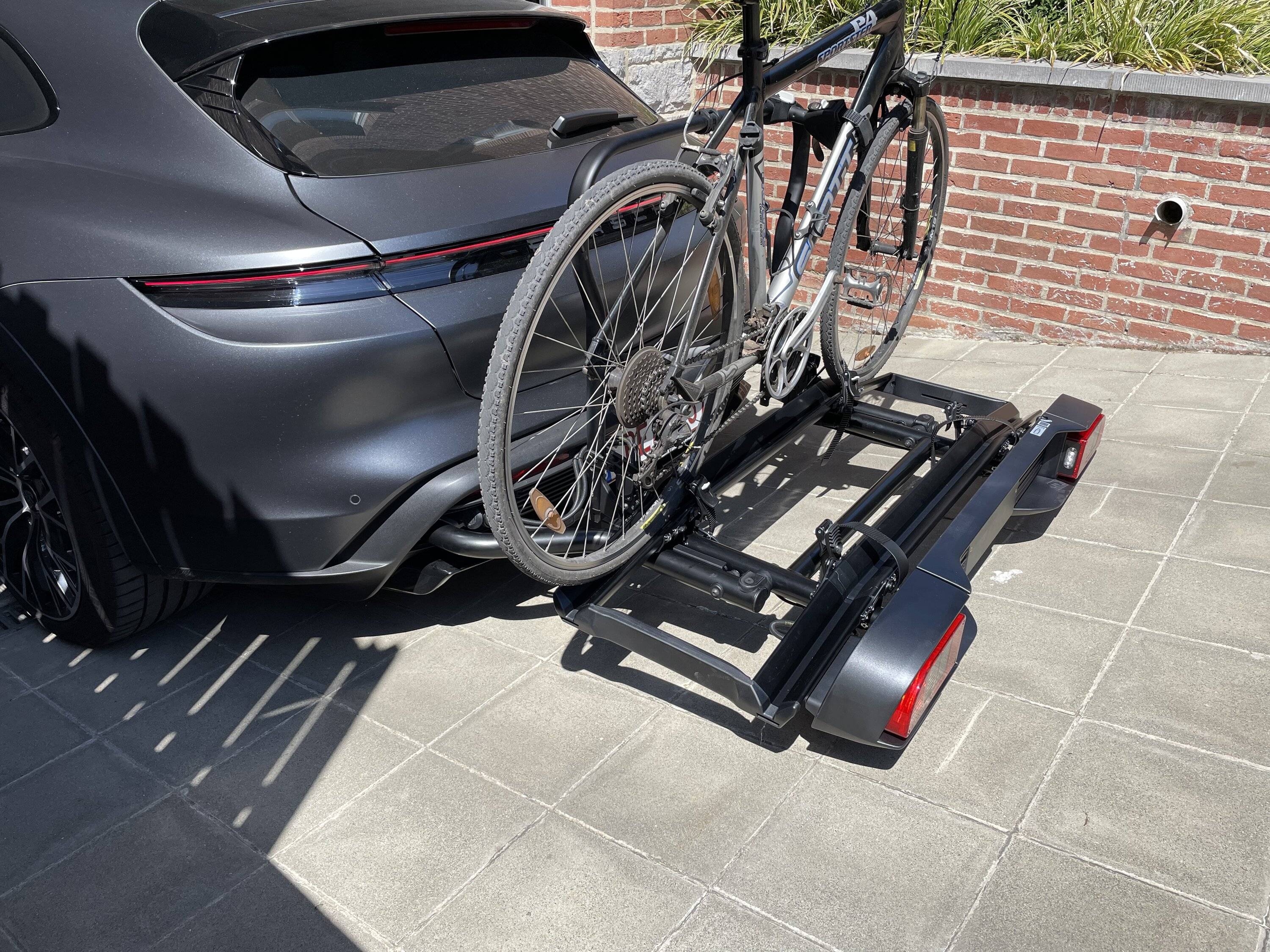

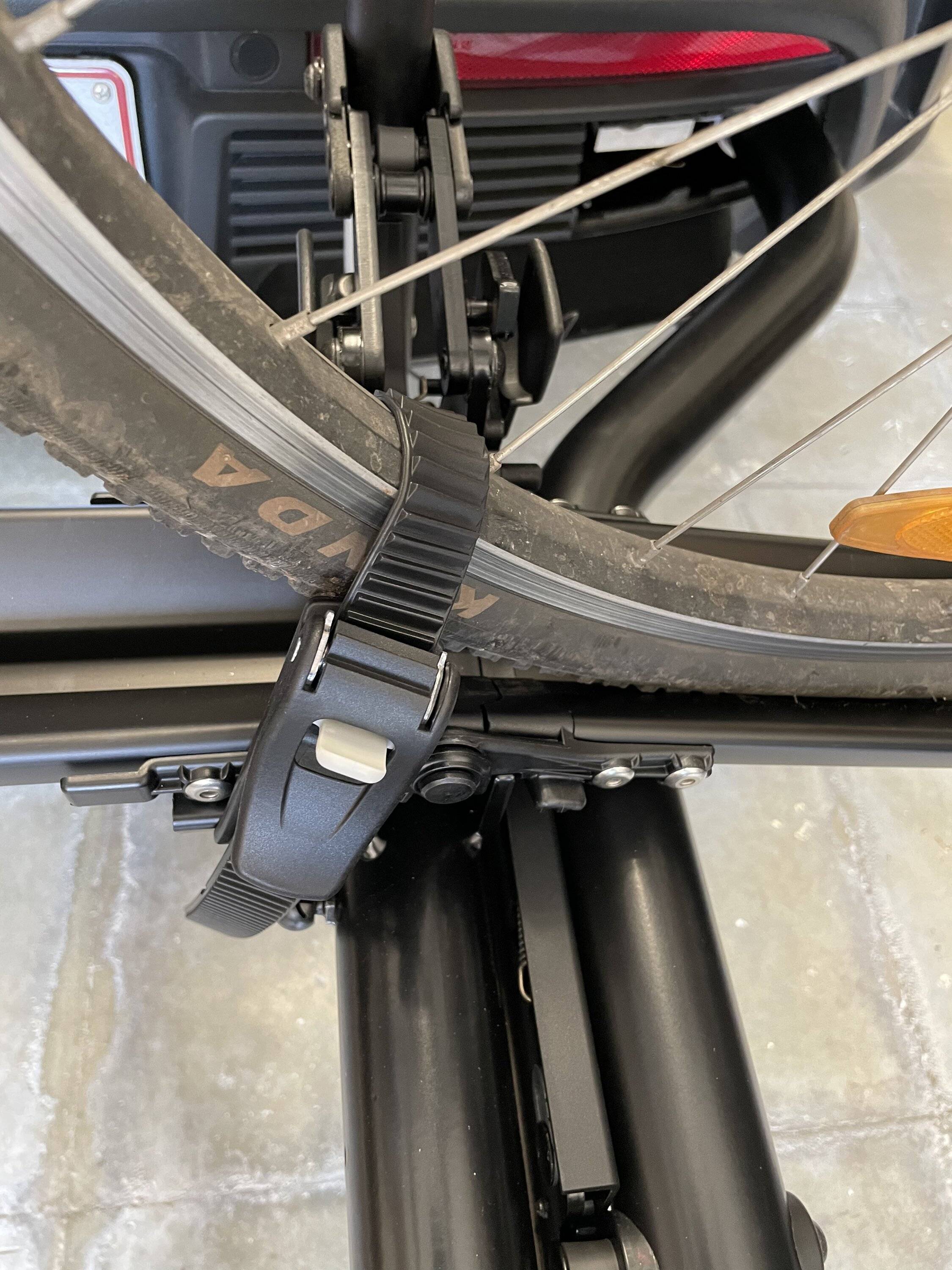

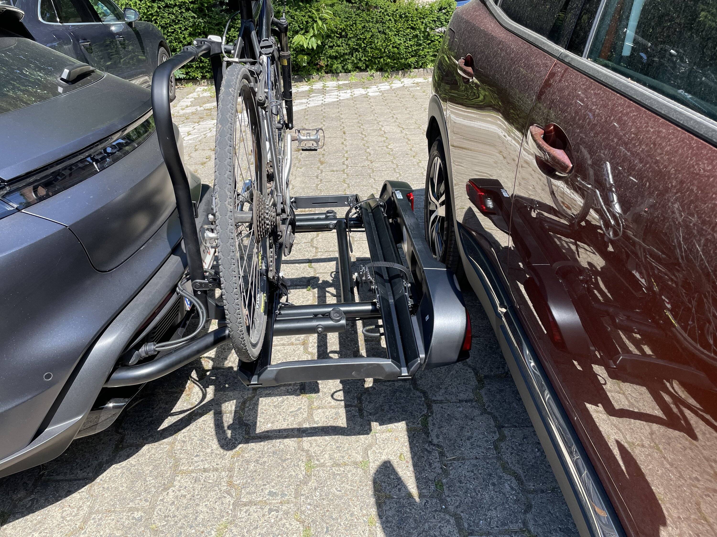

I had to try it with an old bike first
It’s as easy as it was with the Thule
Porsche Taycan Porsche Bike Rack (step by step picture of the installation) 69FC0A38-D3C1-4B52-A44A-21FF1FD83B7C
Porsche Taycan Porsche Bike Rack (step by step picture of the installation) 29764E93-2E76-4F0B-9D6D-52AC7295B040
Porsche Taycan Porsche Bike Rack (step by step picture of the installation) A39EF981-423F-4FDE-B640-BE70BF671F76
The boot is easily rechargeable as i’m used to with the previous racks
Porsche Taycan Porsche Bike Rack (step by step picture of the installation) F0F49E62-60B9-4E9A-8C9A-CF392B9C222A

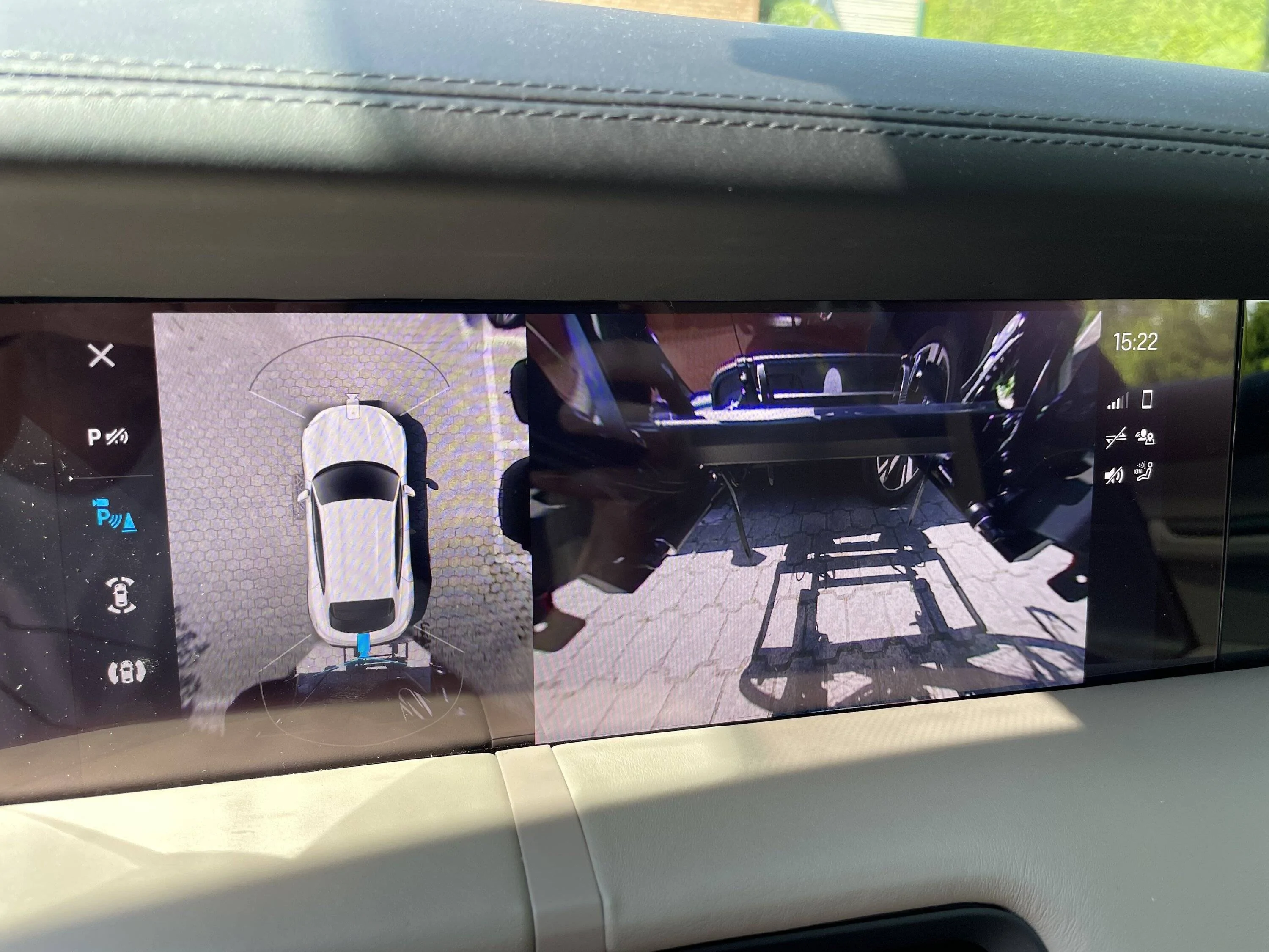

My driveway is quite steep so I had to try
Porsche Taycan Porsche Bike Rack (step by step picture of the installation) 5D5A6DA7-E20E-4181-BB9C-063FB3F59F20
I don’t know the angle but the Macan with the Thule bike rack was slightly touching here.
I’m on lift mode and it passes easily
Porsche Taycan Porsche Bike Rack (step by step picture of the installation) 43B75C55-1D5D-4431-BD13-1FCAB8138B10
The reverse camera is still working but not the sensors and it doesn’t beep all the time which is good.
The view is difficult but you can approach a car without touching it
Porsche Taycan Porsche Bike Rack (step by step picture of the installation) 5AEC66FA-30CE-4517-AA6A-EE9C747E37F4
I knew I was close
Porsche Taycan Porsche Bike Rack (step by step picture of the installation) 9C3F552A-AA0F-453D-9EAF-FF57E1700C9A
Like others said in the forum, once you get used to it, it can be placed and removed 5 min and is not taking much place and is around the same weight as the Thule.
Porsche Taycan Porsche Bike Rack (step by step picture of the installation) EED3640A-6639-4F30-89B3-287C166F01E6
Very happy I got it.

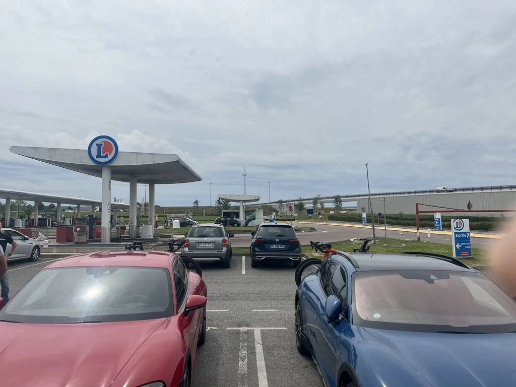

I will test next month how much range we’ll loose driving very fast to south of France as I just did the trip so I have a reference.

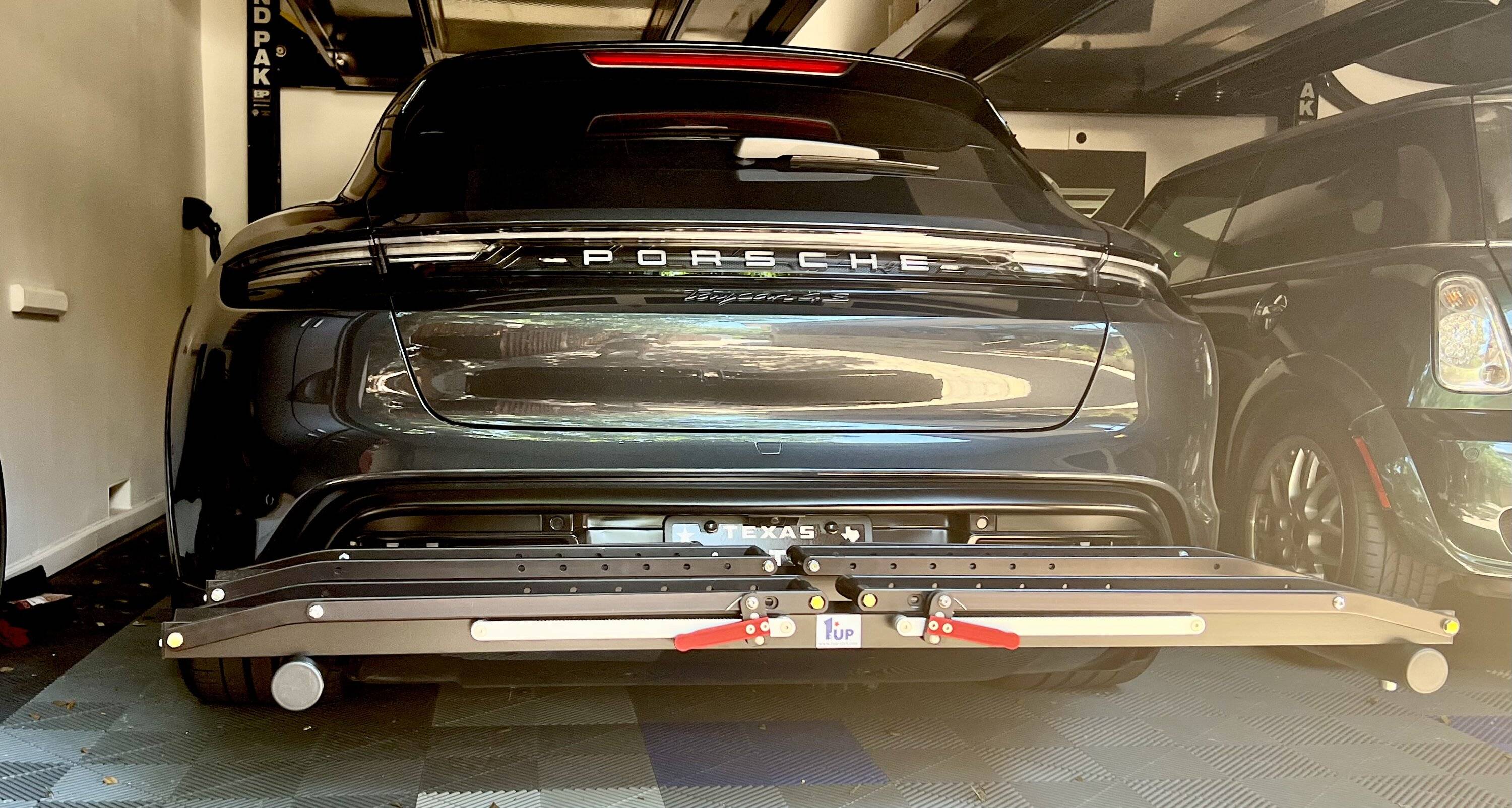

Great post - thx for sharing.

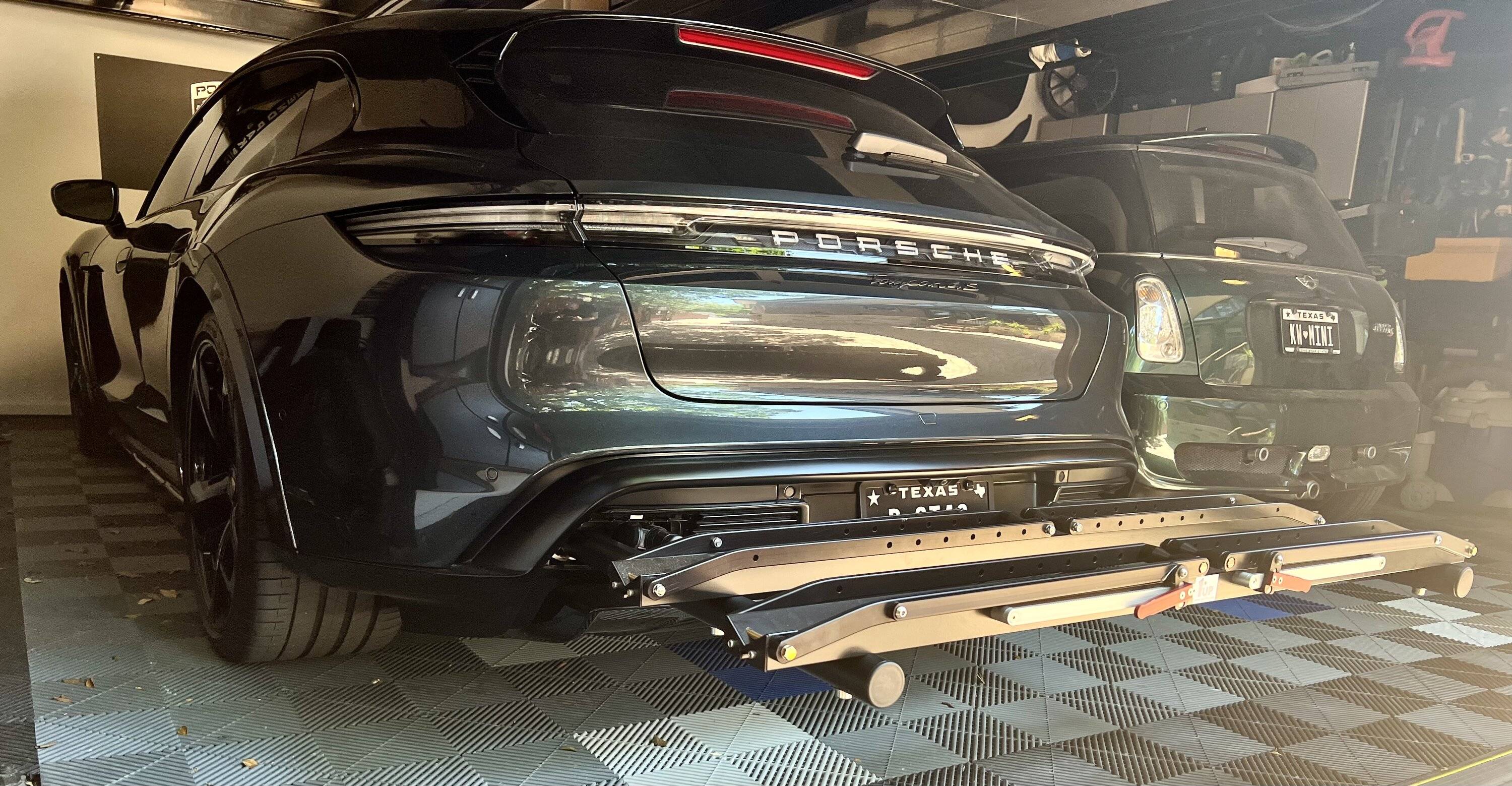

I actually still have my OEM rack on order from June 2021 and still no sign!!
That said I have to say I like my custom bike rack made by forum member Will so much (arrived and installed it today) that I might just cancel my OEM order - apples and oranges in respect certain functions but Will's minimalist yet extremely sturdy and utilitarian design I think is a winner for me (will install my custom lighting solution and plate holder later today).

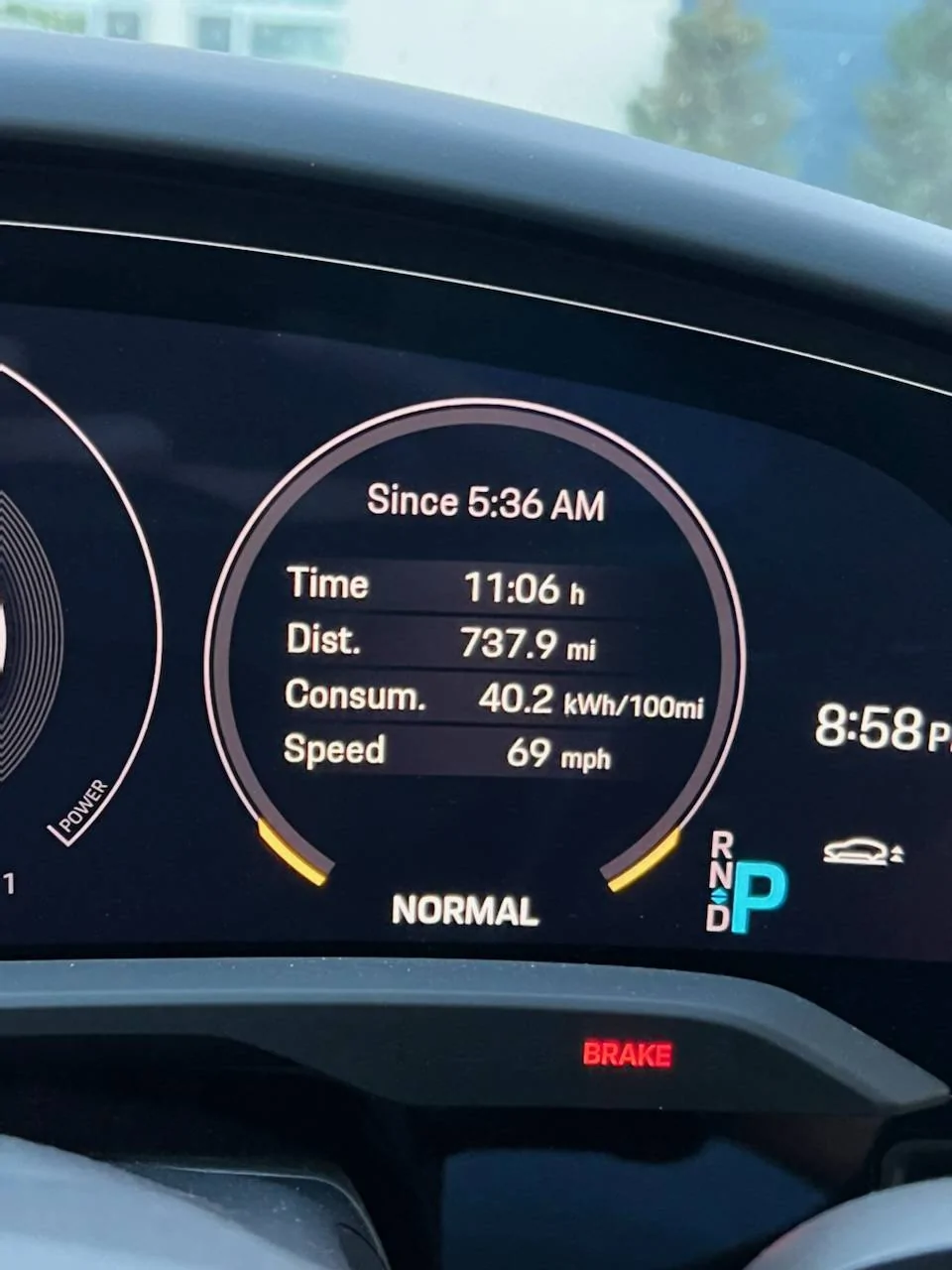

Here are real world efficiency stats when I used Will's custom bike carrier that many of us from this forum have purchased. His bike carrier system is lighter, and less bulky than the Porsche one, but it still has an affect on aerodynamics, and efficiency.
Earlier in August, I went almost 1,200 kilometers from Denver to Idaho Falls, ID in one day in sunny and warm conditions. There was plenty of altitude gain, and I was also not shy with the speeds. I have 20 inch wheels, so that helped lessen the range impact, but regardless, people should be aware that transporting a bike on a CT - either on top or on the back - will have at least a minimum 15% impact on range while causing at highway speeds.

Would you know how to fit the license plate? I see you are from the same country :)
I have a typical black plastic license plate holder, but if I put that on, you can't rotate it into horizontal position anymore. How did you solve this?
I saw your other post.
I don't have the bike rack close to me as we left it in our secondary home so I can't verify.
But I don't have your issue.
I don't recall but when I look at my pictures where I have the plate and the bikes I don't see a plastic holder for the plate.
I assume I used heavy duty 3M tape to stick it.
Driving at more than 200km/h on the autobahn the plate didn't move and if it falls it's a copy and not the original plate so no issue.
I knew I was close

Did a drive to the Alps last week with the bike carrier and 2 bikes and at French limits, 130kmh I was getting 1.8mi kwh! Met another Taycan at IONITY who was finding the same thing. His theory was that deep section wheels were like a parachute.
On Winter tyres at Easter and 15-20c cooler i was getting 2.4 without the rack and had been running 2.8-3.2 recently on Summers. The roofbox and rack is significantly more efficient, 2.4-2.6 so the roofbox must deflect air around the bikes somehow.
Porsche Taycan Porsche Bike Rack (step by step picture of the installation) 1689586261203

I am thinking of getting a cross tourismo. Is it even possible to fit a mountain bike or road bike inside of the car?
FredC057
FredC057
Fred
Feb 7, 2021
178
185
Brussels
Taycan Cross Turismo 4S (2022), Fiat 500Ce
Yes, no problem to fit the bike inside the car if you remove the front wheel.
I think I even placed 2 bikes one on top of the other once with some padding in between but I can't find any photo.

Is the removal from the cache difficult with the tool? I'm little bit scared I would break some plastic part.
