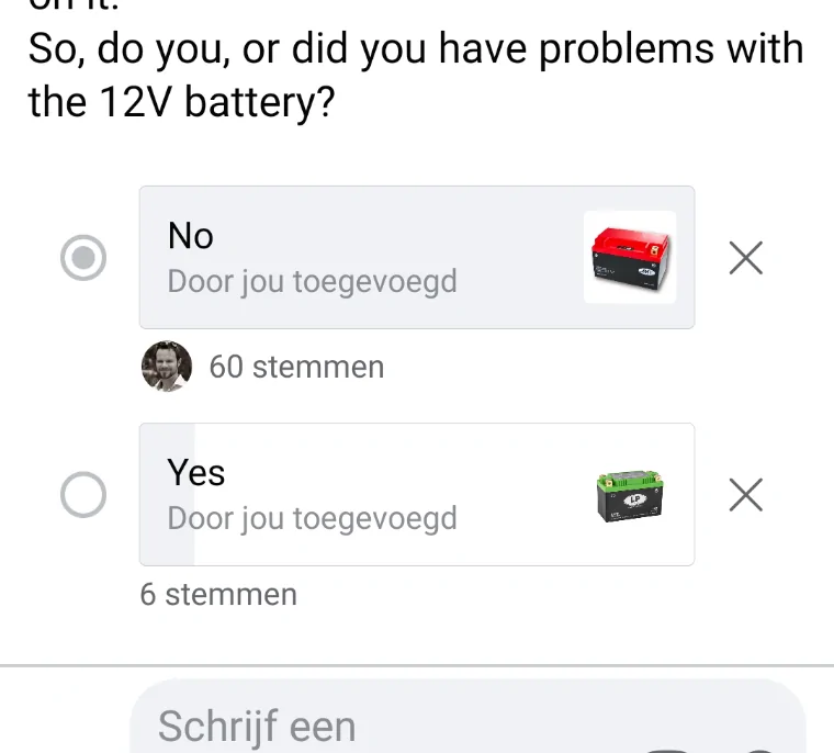

A lot
Ok, latest score from the Facebook group.
About 91% is ok.
Porsche Taycan 12V battery problem issue with your Taycan? Screenshot_20200726-210752
I want to add a few remarks about these numbers:
1. Not every owner is on Facebook.
2. Not every owner is member of this Taycan group.
3. There are over 5000 Taycans delivered and there are only 66 votes.
It's an indication but it's defenately not an absolute number.
In fact, it may well be much less or much more.
I think the last one isn't obvious cuz MOST problems pop up on internet, also this forum so I think there are much less issues than we see here and/or Facebook.
About 91% is ok.
It's an indication but it's definitely not an absolute number.
66 is statistically significant if the the sample is not biased. Do Facebook users represent Taycan buyers? Unknown. I am not a Facebook user,

Nope.
Emphasis was on "if the sample is not biased".
It is, like I said before, namely by my three points... :)
