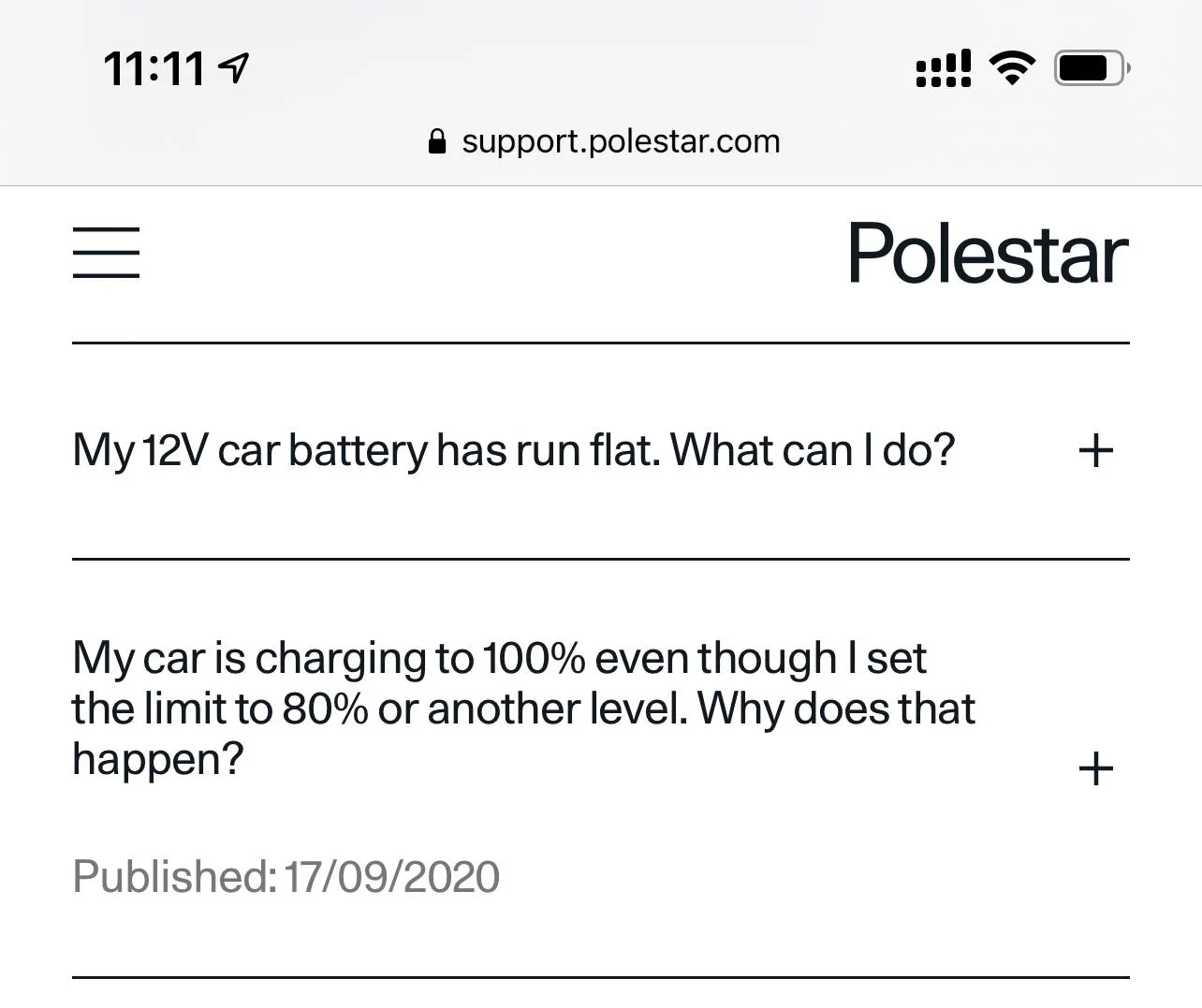

Just so you don’t feel like the Taycan is the only vehicle with teething problems.
Polestar has recently recalled thousands of vehicles to fix their 12v issue
https://tekdeeps.com/second-recall-of-polestar-2-in-a-month/
I hope Porsche comes with a solution too. I also hope their future cars have an old fashioned pull lever to pop the front hood so you don’t need to jump from the driver panel first. That would at least allow any roadside assistance service to jump the Taycan without special knowledge.
3,049
2,640
Polestar also has been very upfront about this and written to all owners etc.
Communication from Porsche?
Head in the Sand!
