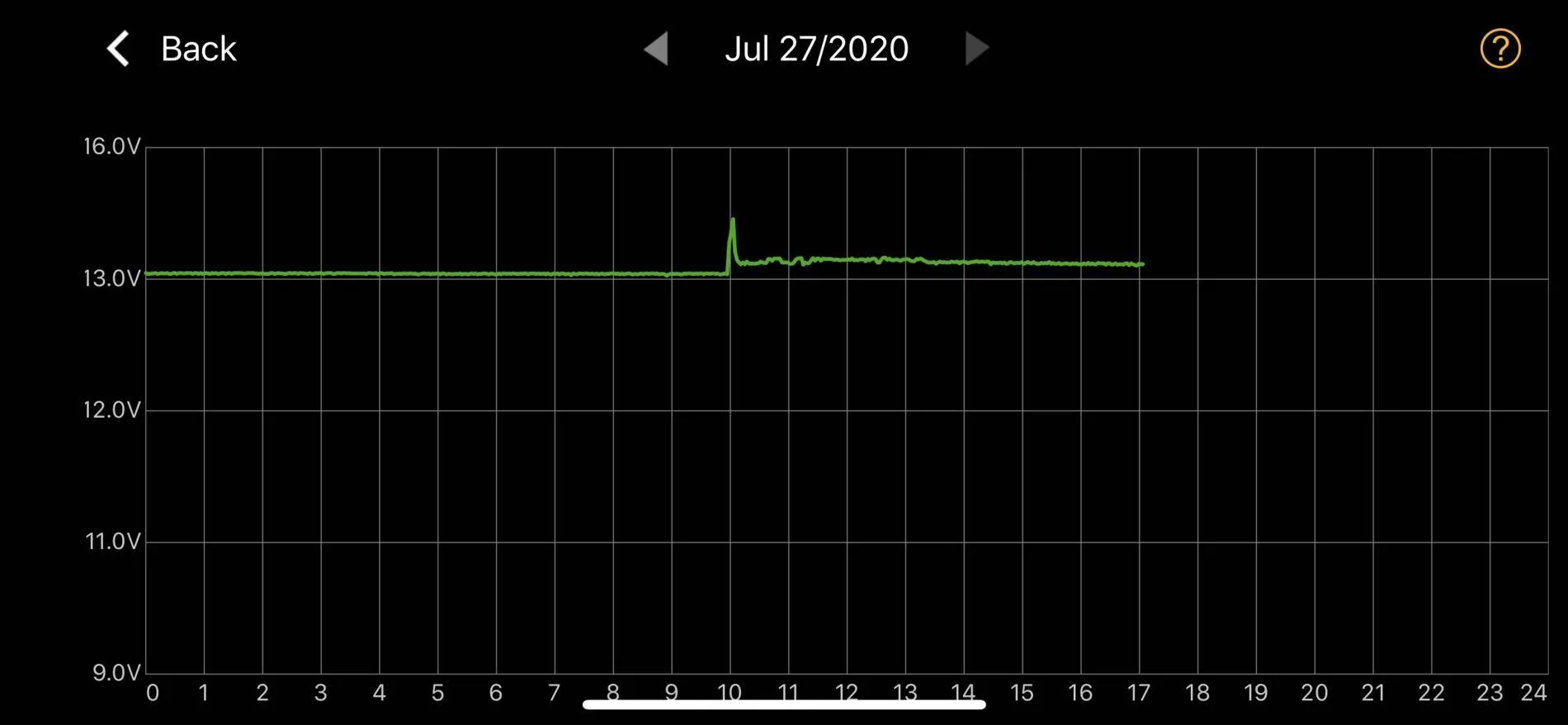

Are folks actively monitoring the 12V battery status in the car? I have my rightmost “tube” set to Information view, with one line set to the 12V battery level. I took delivery on 7/15 and have charged at home, at an EA station, used the app, and used the Connect web UI and haven’t seen my battery drop below 13.2. Are non-affected owners seeing the same readings?
This is what my battery looks like today.
I went for a long drive (110 miles?) starting at 10am.

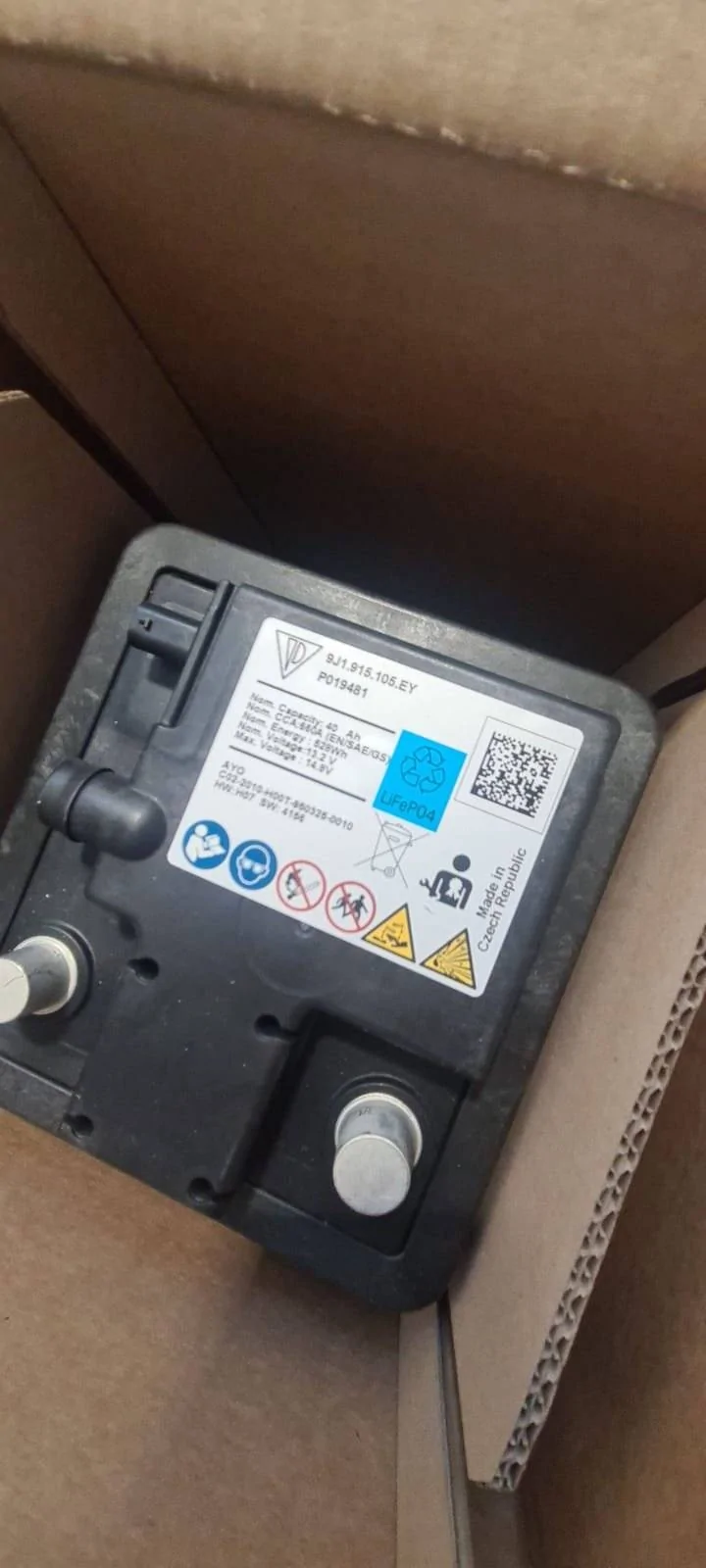

Taycan, at least in Spain, comes with a 40Ah battery (12v).
I think it is ridiculous...Taycan has a lot of electronic components (navigation, music, lights, etc).
I read in this forum about a 60 Ah battery (12v) in USA's Taycan....someone could confirm this point?
Thanks in advance!
