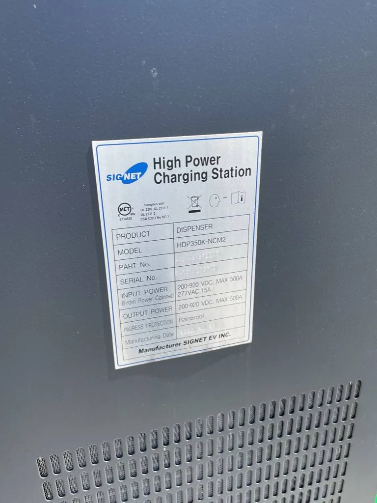

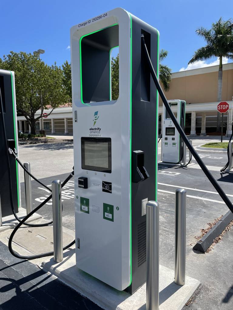

My car got updated yesterday, and I've tested charging at SIGNET charger. IT WORKS! The SIGNET charger that I went to is a brand new installation, so we may start seeing more of them.
My experience with the dealer was a little different than has been reported here. My service advisor had a complete package that he had to review with me both before and after the update. He couldn't give me the package, but he was very patient reviewing the process with me. All the details were covered, no surprises:
  1. I was warned that the PCM would be reset, and he needed to confirm that I was aware and I would be ok with it. The reset did occur, and most things came back as expected. It was good to run through the car setup now (instead of day #1 of ownership when I was unsure what all the settings meant).
  2. He had to confirm that I had problems with SIGNET chargers. He had a picture of exactly what a SIGNET charger looks like to confirm.
  3. When I returned to pick up the car, he let me know PnC was now available.
  4. I was told PnC could take 1-2 weeks to work, as they had to push my new certificate to the network. So this confirms that we are getting a new certificate and that it does take some time to get out on the network.
  5. I can try the PnC immediately, but if I get a failure at the charger, I am to disable PnC in the PCM then try the charging session via the Connect App on the iPhone. If I leave PnC enabled, it could mess up communication and make charging fail. Once the cert is out on the network, this issue should go away.
All in all, I am pleased with this experience. Porsche seems to have their stuff together on this one. It's not completely ready for prime time as there are some caveats about the distribution of certificates that the average owner might not be able to follow. But for those of us that care to get in the weeds a bit, this is a great solution.
I can't wait until PnC works as a final close to this event.
Apparently, all SIGNET chargers look the same. Here are a couple of pictures that I snapped today from my demon charging unit that started my problems:
