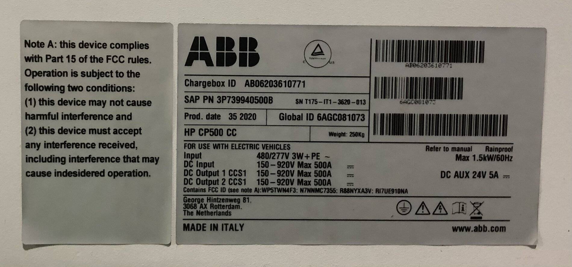

[Some of] the newest EA stations are made by ABB - white fascia with green neon accents, gray sides. Sticker example below. I've had 100% success rate (not plug and charge - I have an MY2020) with these stations, both 150 kW and 350 kW (see 240 - 264 kW, once peaked at 272 kW).
Porsche Taycan 19.2kW charger fix for EA charging and Plug & Charge IMG_2370
I've had 20% success rate with older Signet stations (no green neon accents).

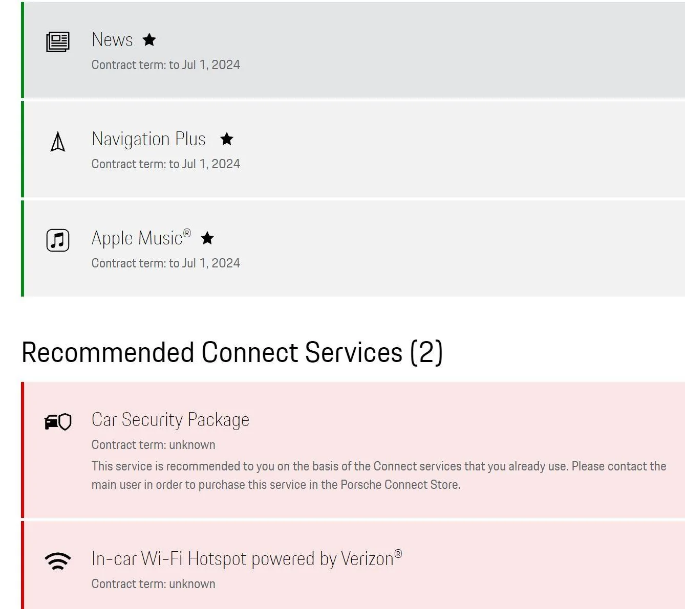

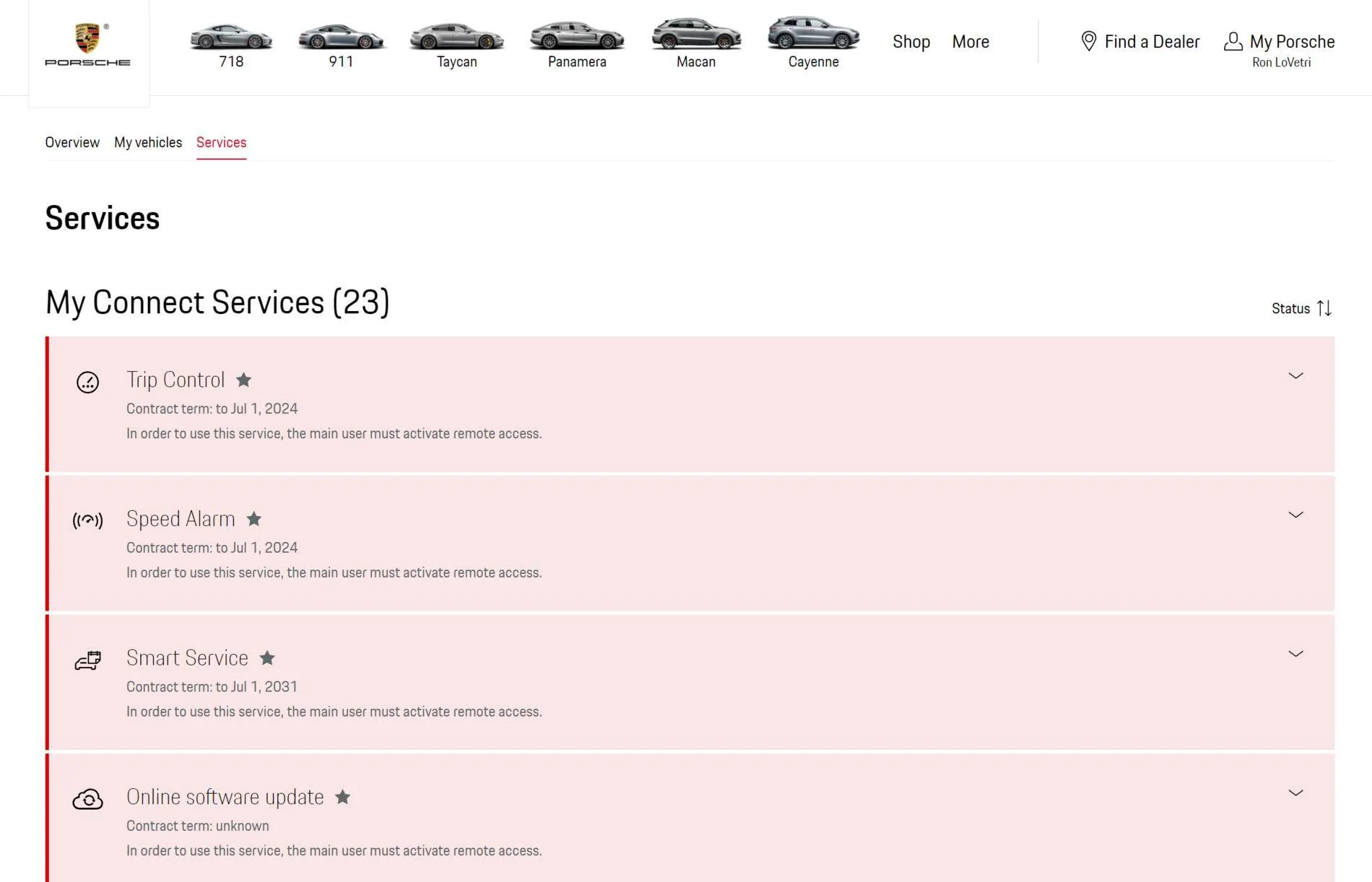

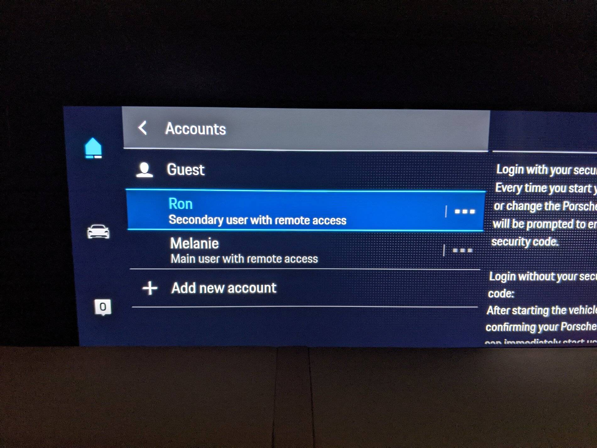

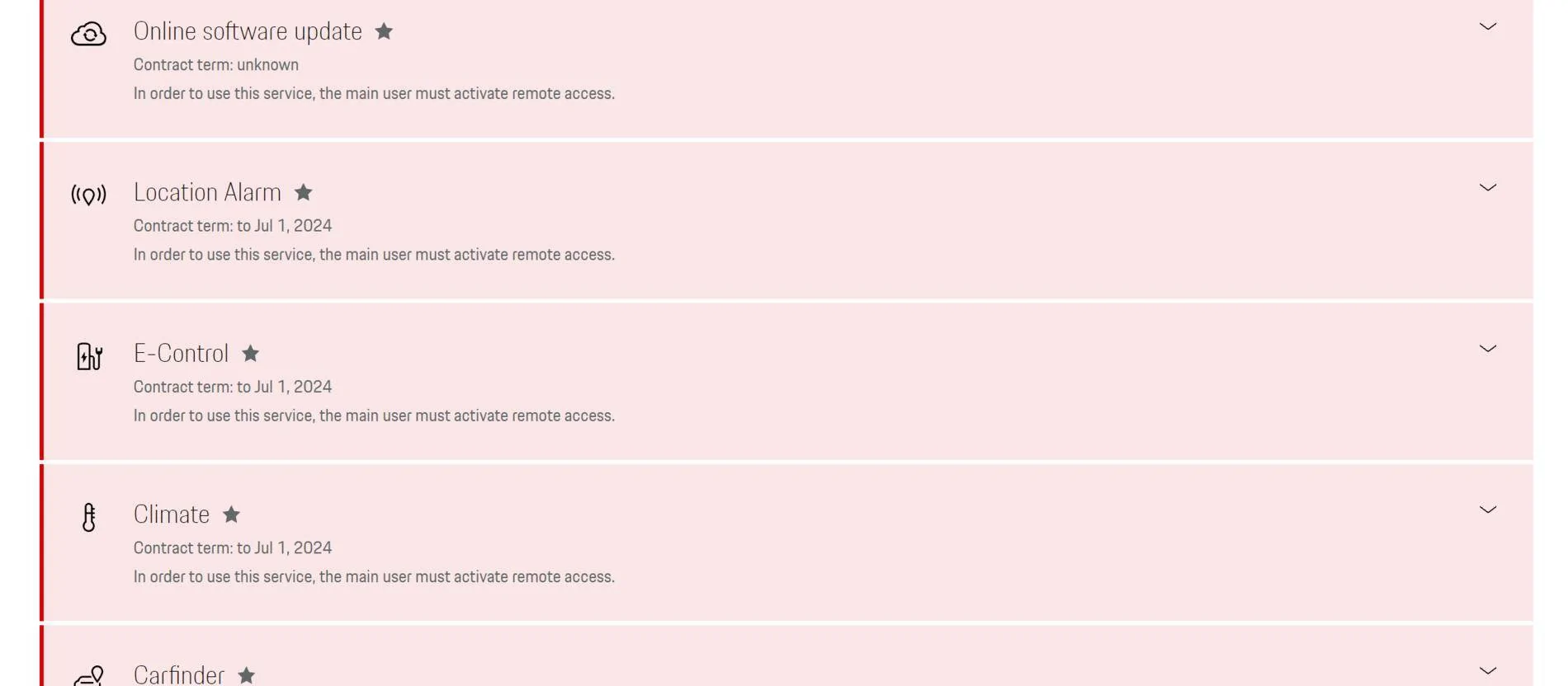

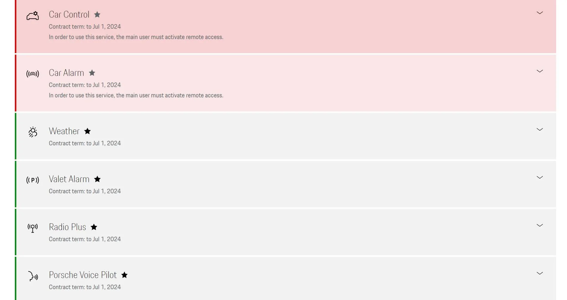

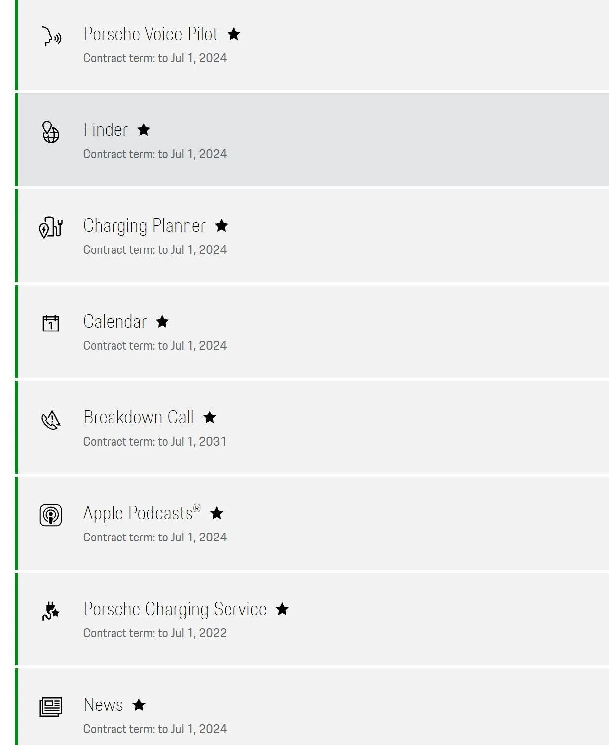

Hello-
Don't know if I should start a new thread so please let me know. Based on the information in this thread we had the Plug and Charge update done. The good news, it works and the dealer did a wonderful job! It was the first update 19.2 update that was done at the dealership. The bad news is that features on the Porsche Connect App are not enabled after the PCM reset because it thinks remote access is not enabled. This is true for both the main user (Mel) and the secondary user (Ron).
General Information - Screenshots
  • remote access is enabled for both users (see attached Account with...)
  • The Connect App thinks remote access needs to be enabled (see attached myPorsche 1-5)
The connect app on my Android phone and iMac desktop have functions disabled with the error message, "In order to use this service the main user must activate remote access." As you can see from the Account screenshot the main user (Melanie) and secondary users (Ron) both have remote access enabled.​
I have spent hours on the phone with Customer support. One day I used over 20 miles of charge sitting in my garage on the phone with Customer Support. I have:
  • Had the main user (my wife Mel) delete me and re-add me to the account
  • Delete all my apps and reloaded
  • Delete and re-added my account from the PCM
These are the steps I tried:
  1. Deleted Ron account from the Taycan
  2. Deleted Ron secondary user account from Mel's (main user) Porsche desktop account. This was strange because I needed to delete myself twice. The first time I deleted the secondary user [email protected], it appeared again. This may have been the source of the entire issue
  3. Uninstalled and reinstalled the Porsche Connect App on my phone
  4. Added Ron as a secondary user (normal process)
  5. Added Ron as an account on the Taycan
Any thoughts are greatly appreciated.
