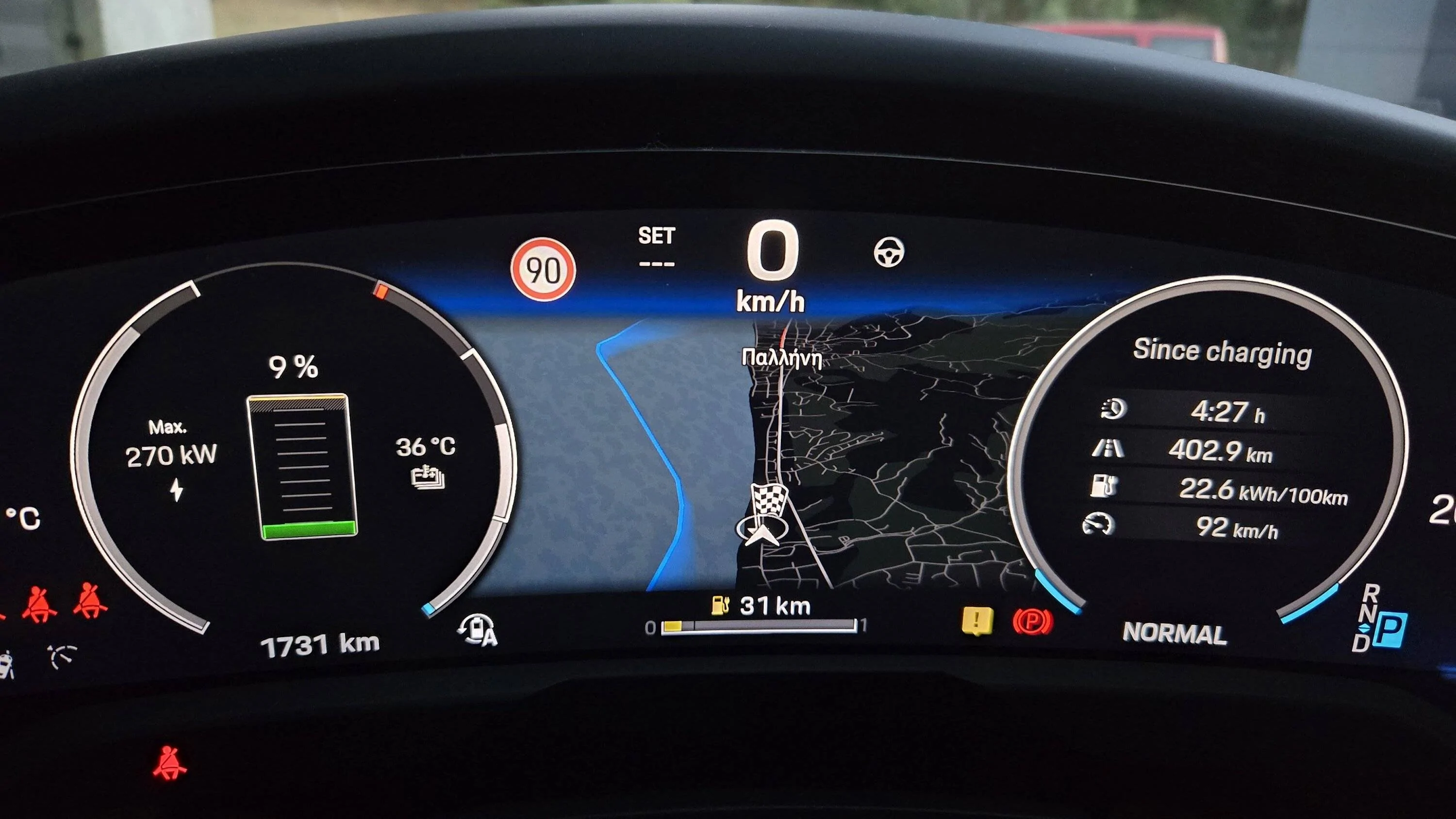

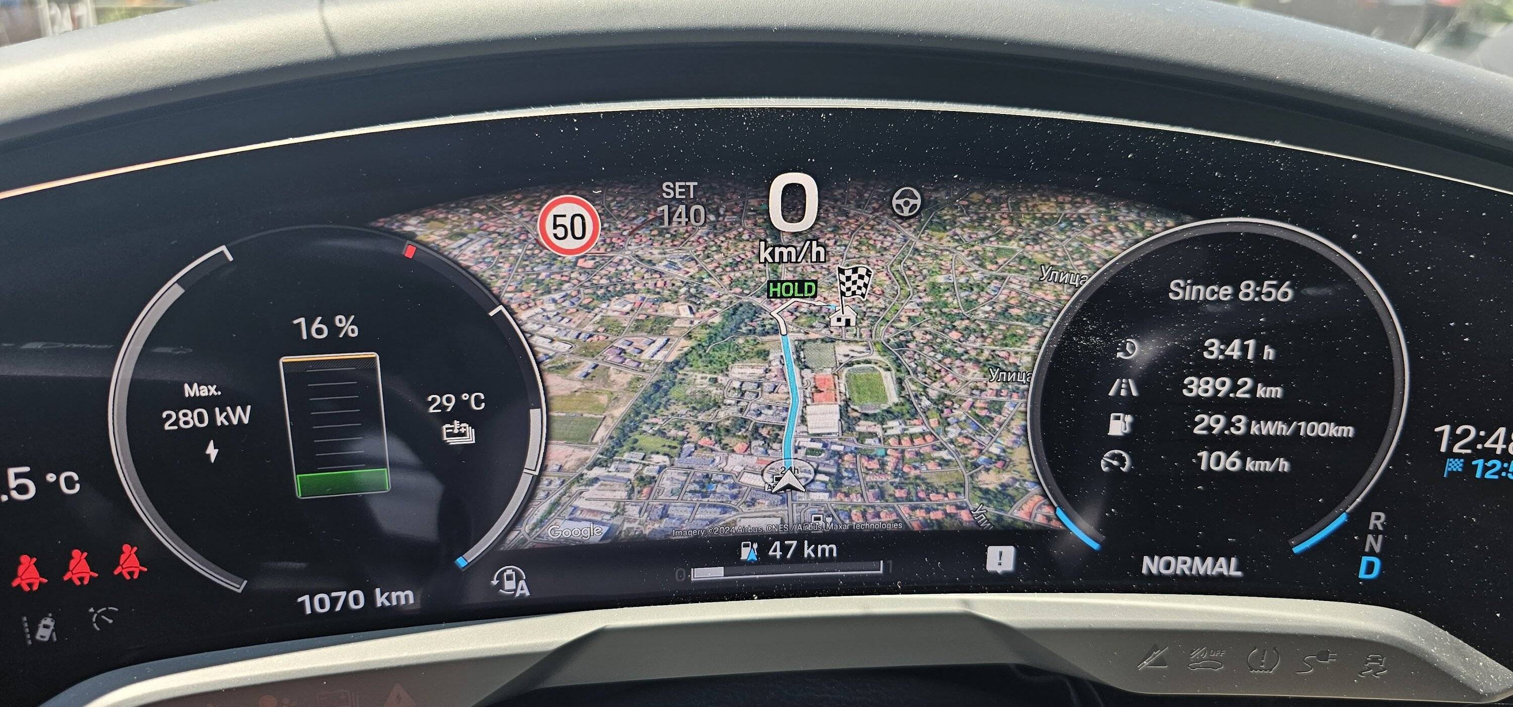

Hello guys,
I upgraded my CT4 2023 (battery+) to CT4 2025 a month ago. I have 3000 km now and want to share some information about improving my mileage.
Usually in the summer I have a 400km journey to my holiday home:
70% highway where I drive 150 - 160 km/h and the rest is 90 - 130 km/h. Only 50 km speed limit, and I drive about 60 km/h. Ambient temperatures are 35 - 39 degrees, inside is set at 22 degrees.
CT4 2023 I had to reload, otherwise I have -10 to - 15% to the destination.
CT4 2025 I can reach my destination with 8 - 11% battery. According to my calculations, the maximum mileage is about 440 km. The best I've achieved is 16% battery when driving on the highway at 140 km/h and not so much traffic the rest of the way.

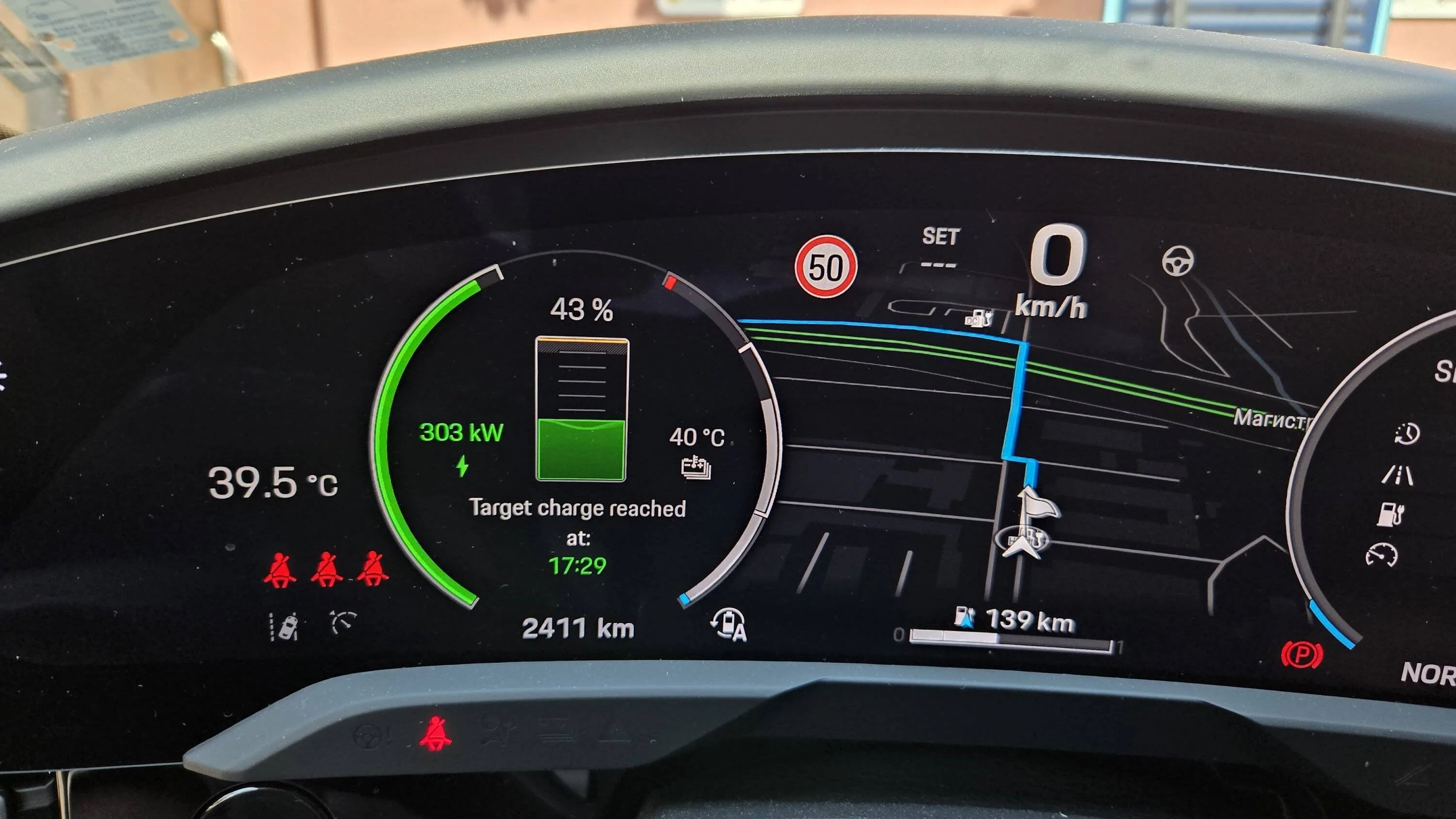

Regarding charging speed 2025 are much faster, with 300kW charger I have 40 - 71% in just 7 minutes.
Range mode doesn't give much advantage maybe only 3-4% more over Normal at these speeds.
If I drive at night and the ambient temperature is 28 degrees with 120 km, the mileage is close to 480-500 km and the consumption is about 19kW/100km.
The car is faster and very responsive compared to the 2023 model.

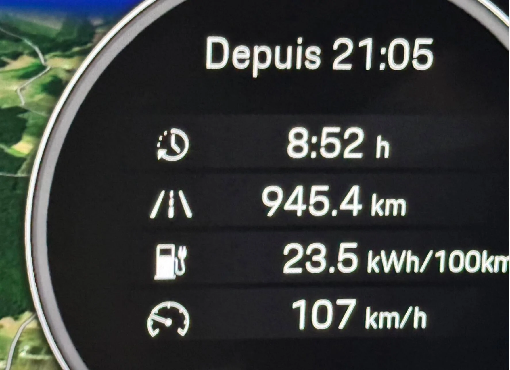

It's crazy how low you get driving at 150-160km/h . I did the drive to my holiday home ( 950km ) at authorized speed + 5%. So 136km/h & 114Km/h. I couldn't get better than 23,5km. Temperature was 28° . I'm used to drive EV since 8 years. It's a ST so I'm supposing not a lof of difference with CT. will try to push to 150Km steady when coming back and see if better :)
