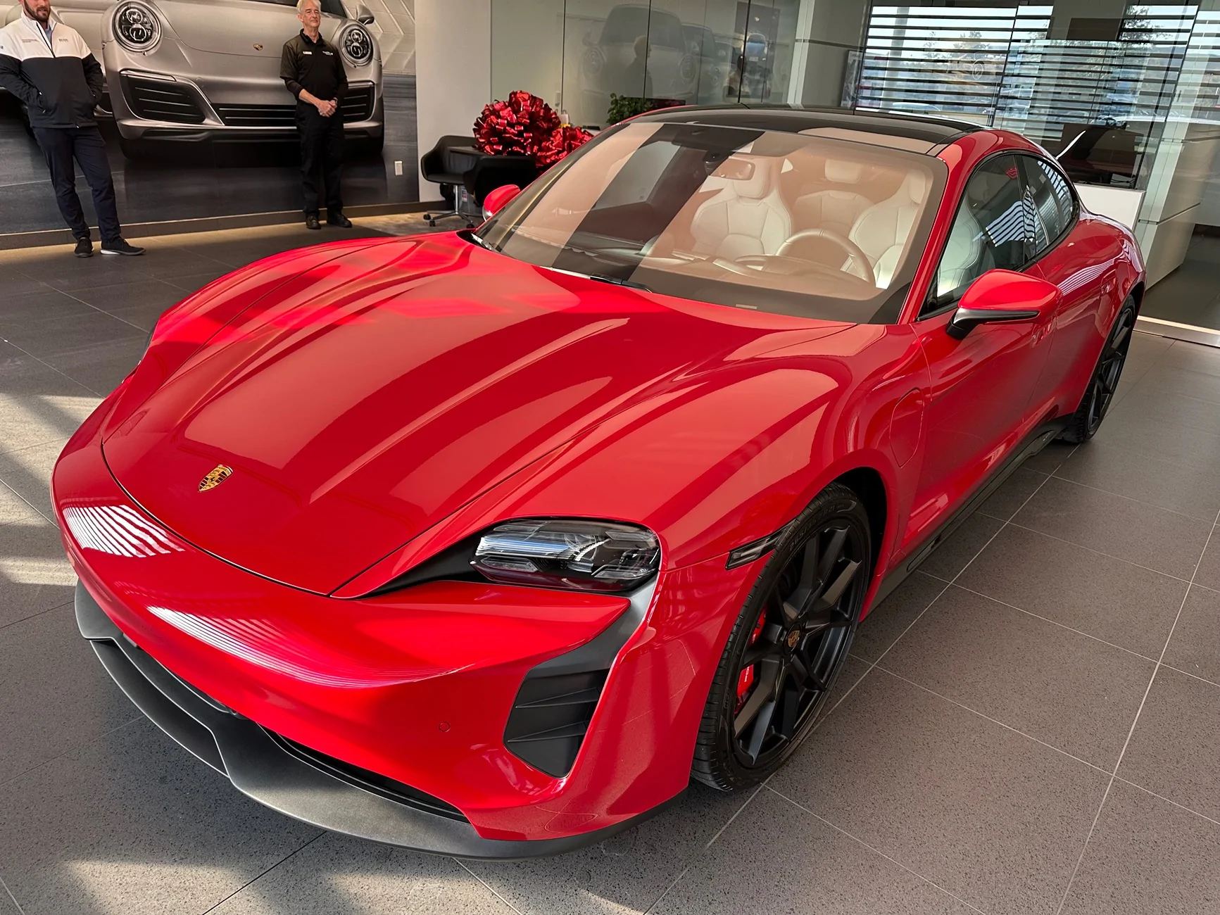

I recently sold my 2023 GTS and acquired a new 2025 GTS.
I flew to Ontario (California, not Canada) and drove it back home to Los Gatos.
I was very impressed with the range improvements. Shockingly so.
First, the trip report:
Porsche Taycan Tayberius III First Voyage - Comparing J1 and J1.2 Image 12-5-25 at 6.24 PM

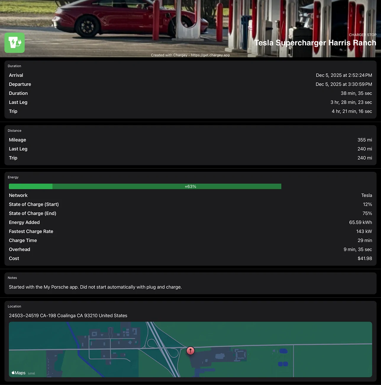

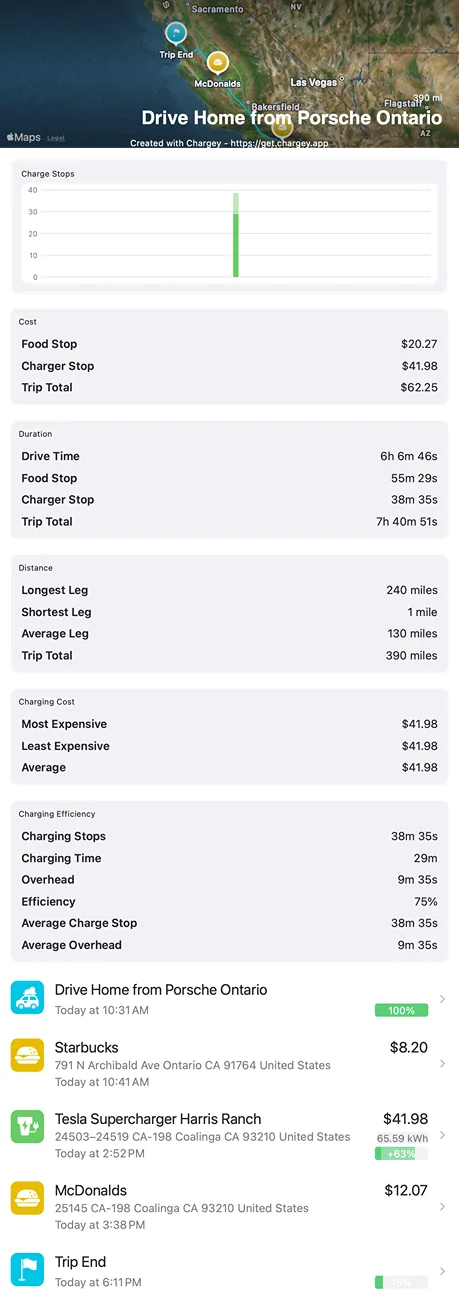

Fueled up with caffeine I started the drive home and was surprised to see the PCM routed me through…a Tesla Supercharger! Electrocute America was next door, but I decided to tough out the Supercharger out of curiosity.
This is how that charge session went:
Porsche Taycan Tayberius III First Voyage - Comparing J1 and J1.2 1765000622919-z5
Of note:
- The charge was initiated with the My Porsche app
- Speeds were comparable to the J1 with 150kW/400V option
- I tried to see if Plug and Charge worked, maybe I didn’t wait long enough but it didn’t look like it was getting past “initializing.”
- This session was not free, so the free Porsche Charging Service does not extend to partners.
But that was it! This was my only charge of the trip.

- Charging information. There is much more info about what rate you should be getting, battery temp, etc. When a charger is throttling you, it tells you.
- Fast charging deeper into the curve. I tested an EA station after dinner tonight and went from 11% -> 85%. I was quite shocked at how long it held 260kw+ (which was station-limited). It held that rate all the way to 70%.

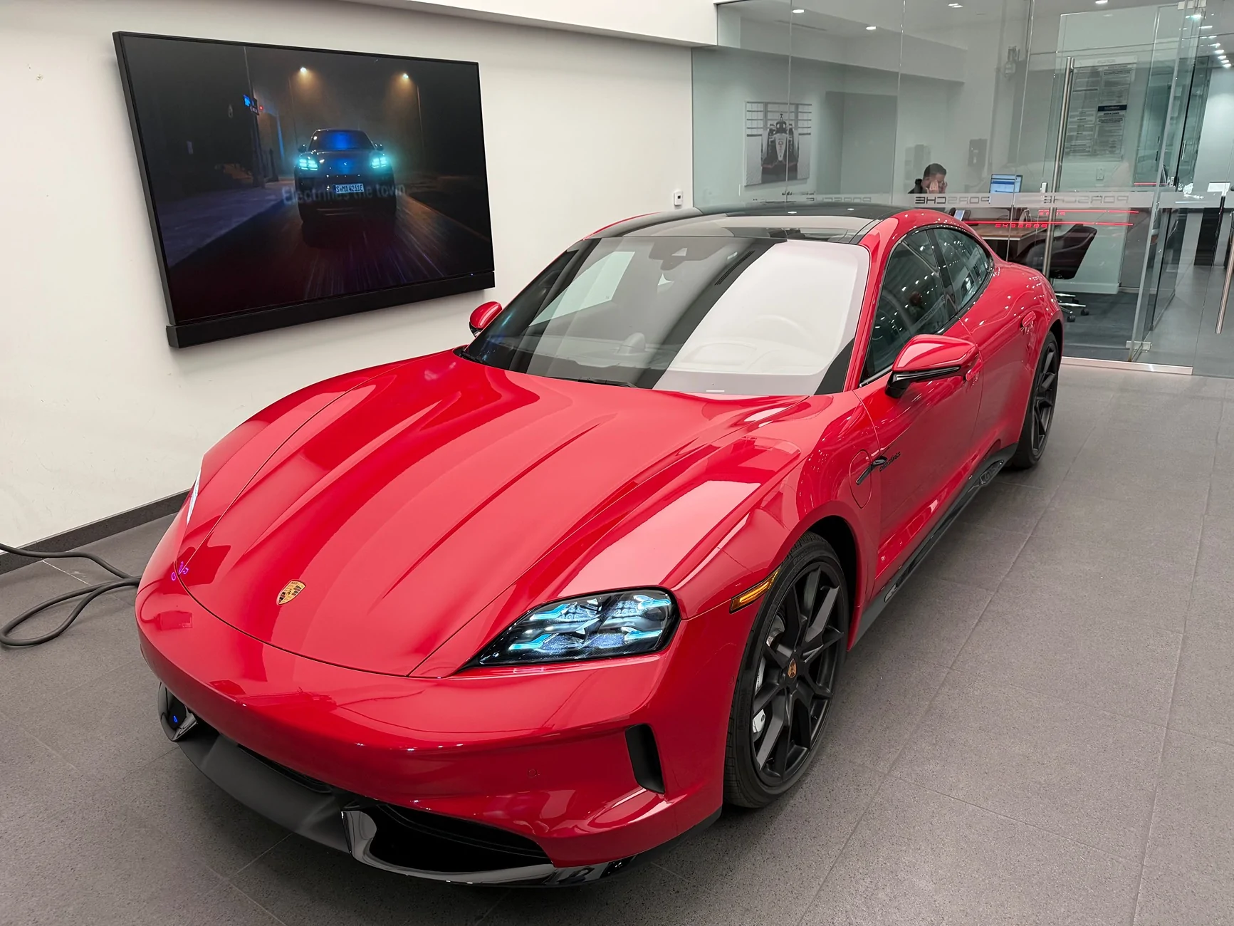

Here some side-by-side pics of the two cars.
Porsche Taycan Tayberius III First Voyage - Comparing J1 and J1.2 IMG_0808
Porsche Taycan Tayberius III First Voyage - Comparing J1 and J1.2 IMG_5644
