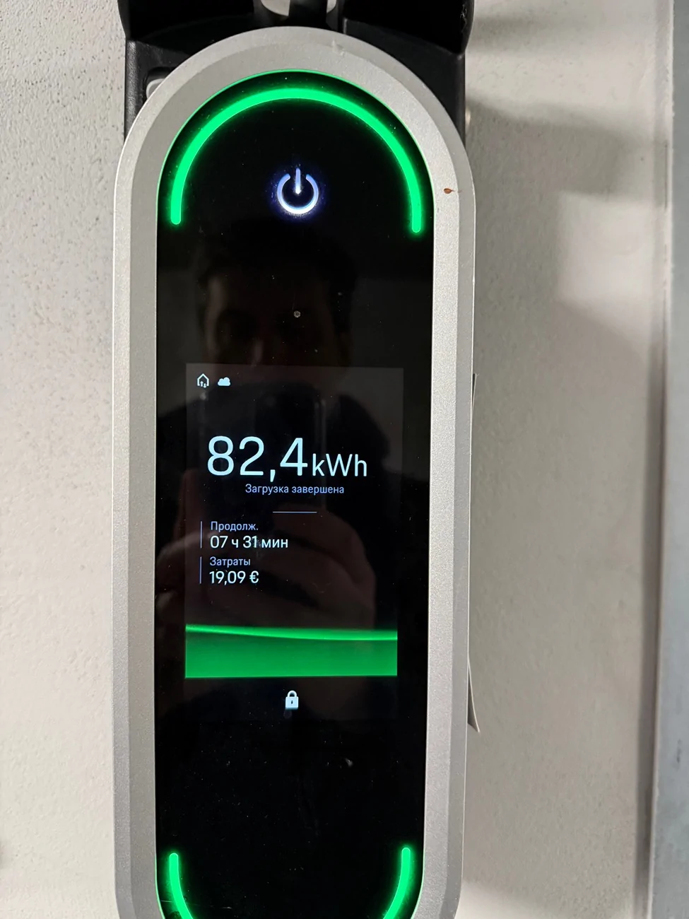

Yesterday I have reached a 100,000 km milage with my J1.1 2021 CT Turbo. I decided to check the max charging capacity of HV battery. After draining the battery till 1% and charging to 100% I have noticed 82,4 kWh charged what equals to 99,4% SoH assuming 83,7 kWh of total net capacity. Can it be true or I do the wrong calculation?
Porsche Taycan 99.4% SoH after 100,000 km on my 2021 J1.1 -- Can it be true? IMG_3438

Impressive mileage but that is not how you measure SoH and your battery capacity, since what you are showing will include losses.
The way we measure it here with high accuracy is using an OBD reader and CarScanner app. Get those and come back and let us know what you have.
This is the energy delivered by the EVSE, which includes energy that go to losses. Subtract 10-15%
This^^
The OP is measuring the volume of a cup by measuring the amount of water to fill it using a leaky hose.
Gotta account for the waste energy.
Did you start charging directly after driving?
If the battery is showing 1% SoC it'll climb to 4-5% cuz the battery will settle and cool down after a while.

No it isn't.
That 82,4 kWh is exactly what amount is used.
Said another way, that screen is showing the integral with respect to time of current x voltage, with the current and voltage sensors both residing within the EVSE. Interpret as you wish accordingly.

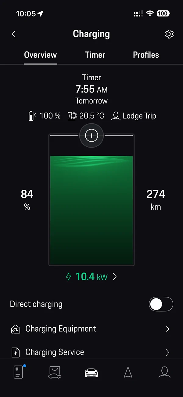

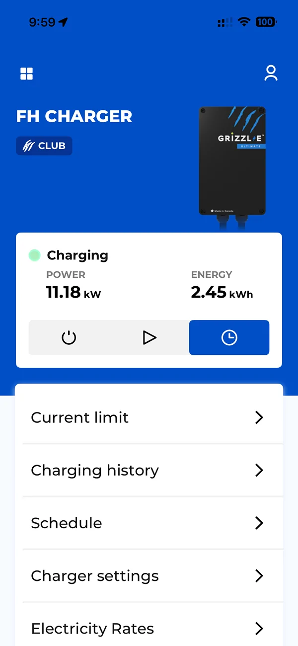

I posted this last night in another thread. Here’s my 60amp circuit fed 48amp grizzly charger feeding my car, note the difference between what the charger is putting out and the car is taking in. The car was very cold (sat undriven in a Toronto garage so around 32f/0c for 12 hours) Im guessing the difference is the battery getting heated and cable losses.
