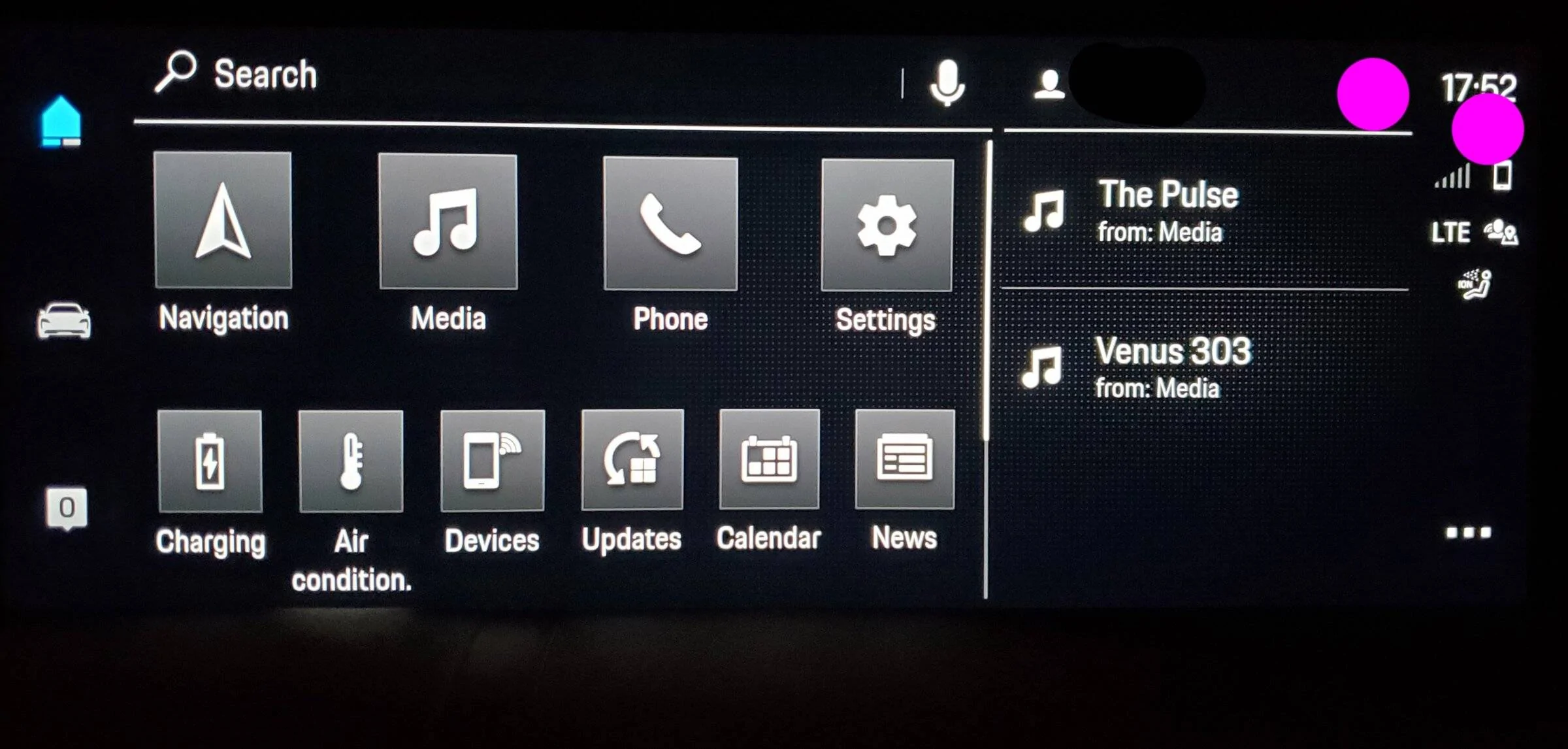

With regard to PCM rebooting - I never had that (had tons of other glitches though). The opposite problem also exists - the "Shut down PCM" doesn't do *anything* beside turning off the screen. To reboot it, I've learned the two-finger trick to enter/leave Engineering mode, which takes 2-3 minutes to do.
could you share the 2-finger trick to enter/leave engineering mode? i'd love to reboot it sometimes an yeah - that power button certainly isn't doing the trick. Thanks
Press where the pink dots are, and screen will go dark after a second. Then, choose the last option, and confirm. It will reboot, starting with the PORSCHE logo.
