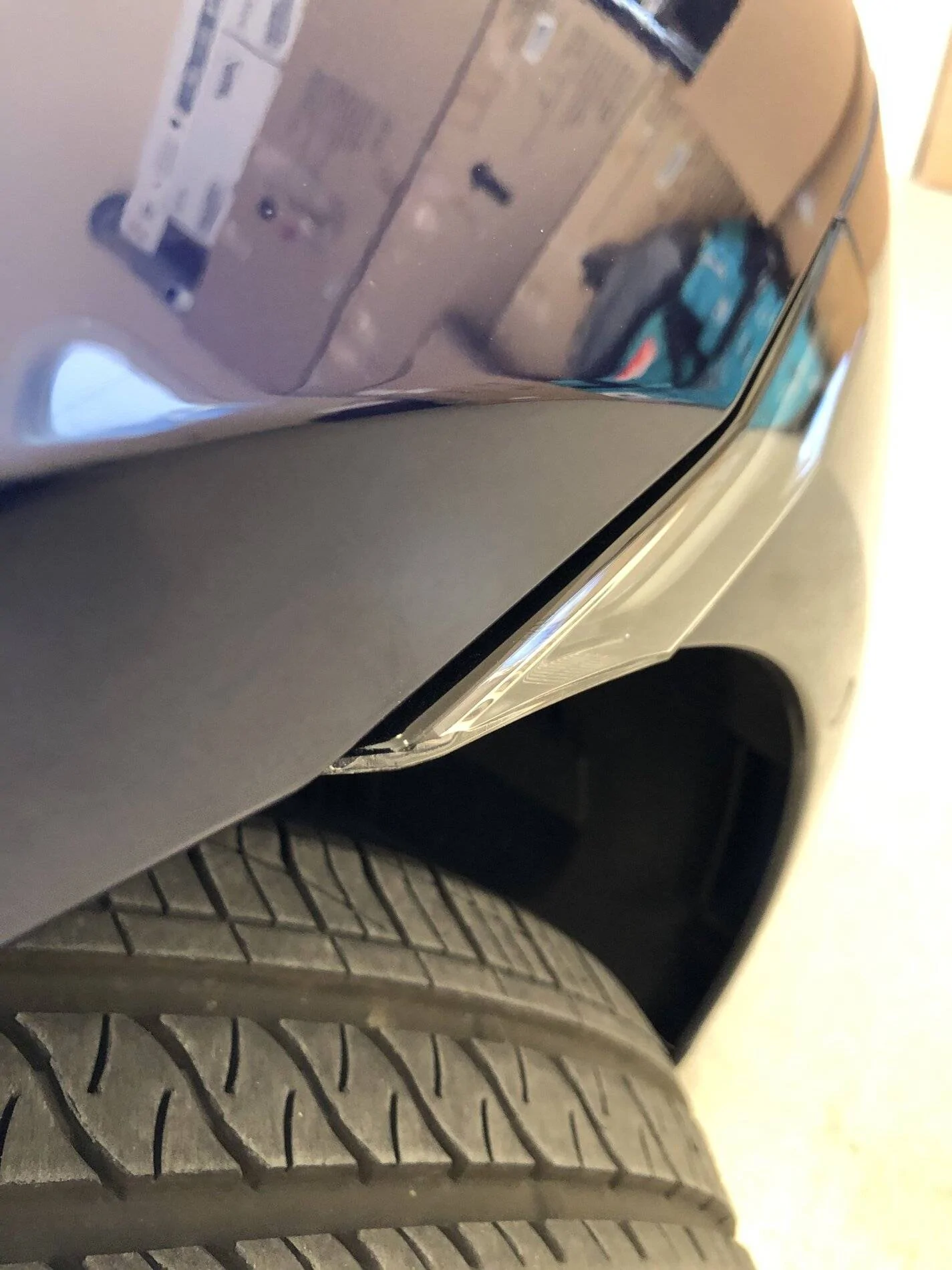

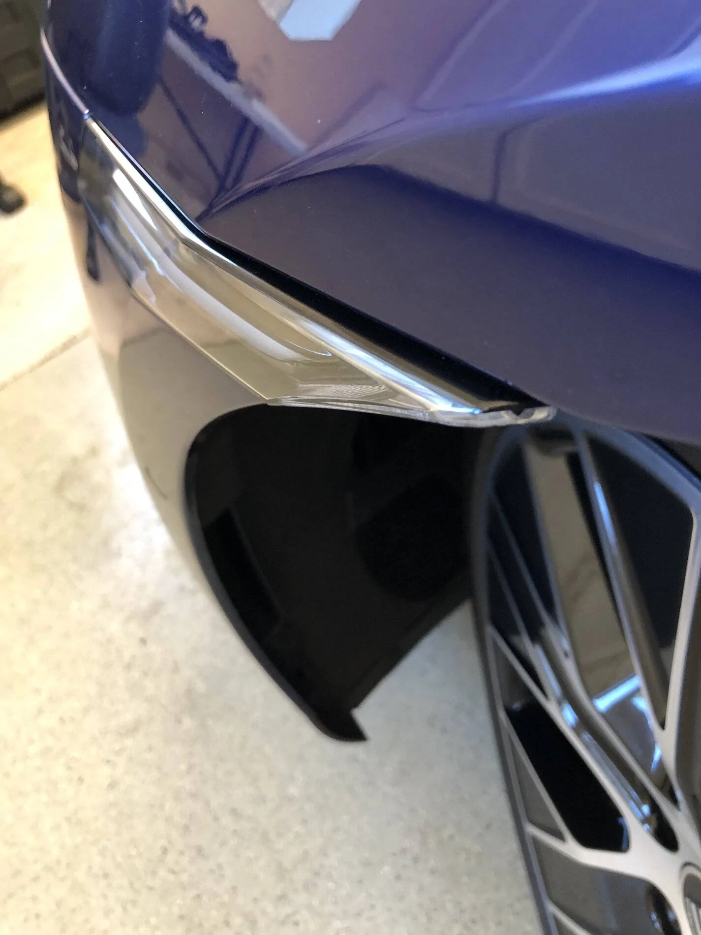

Mine aren’t flush either...how to fix?

I'd assume it's the little spacer causing the problem there. You could take off the marker, pry off the spacer with a knife and reglue it. See if that helps. They might have rushed it and if the glue wasn't set maybe the spacer slipped.

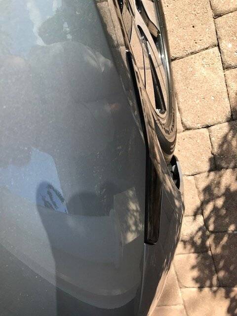

Thanks Frank. The aft end of the side marker sticks out more than the right side. Here is a crappy photo.

If installed correctly, the clear markers are quite tight (no wiggles) even without the spacers. The spacers look like they help to maintain the gap between the bottom of the marker and the body panel (vertical), not as much with controlling how flush the marker is with the body panel (horizontal). I did remove the spacers from the old markers and reglued them onto the new markers. It has been a while since I installed mine, but two key points I remember. It is better to pre tread the screw into the new marker before reinstalling it. I wonder if the screw is going in a bit sideways preventing the marker from being pulled in enough. When installed correctly, the replacement marker slides back in and the screw secures it very well and flush to the body panel without much manipulation.

What Suncoast sells is the genuine Porsche European version. It is the exact same as the amber marker, it's just the reinstall requires a little finesse. The spacer or, as @wemct mentions, the screw can cause a slight alignment issue if not installed ideally.

OK I will do an R&R on the LHS light assembly.
Follow up: I did the R&R on the LHS light assembly with no real improvement
