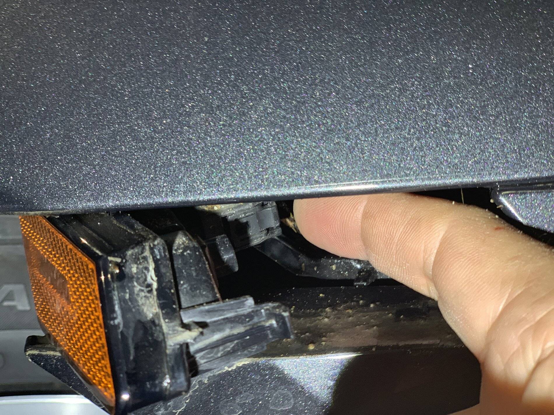

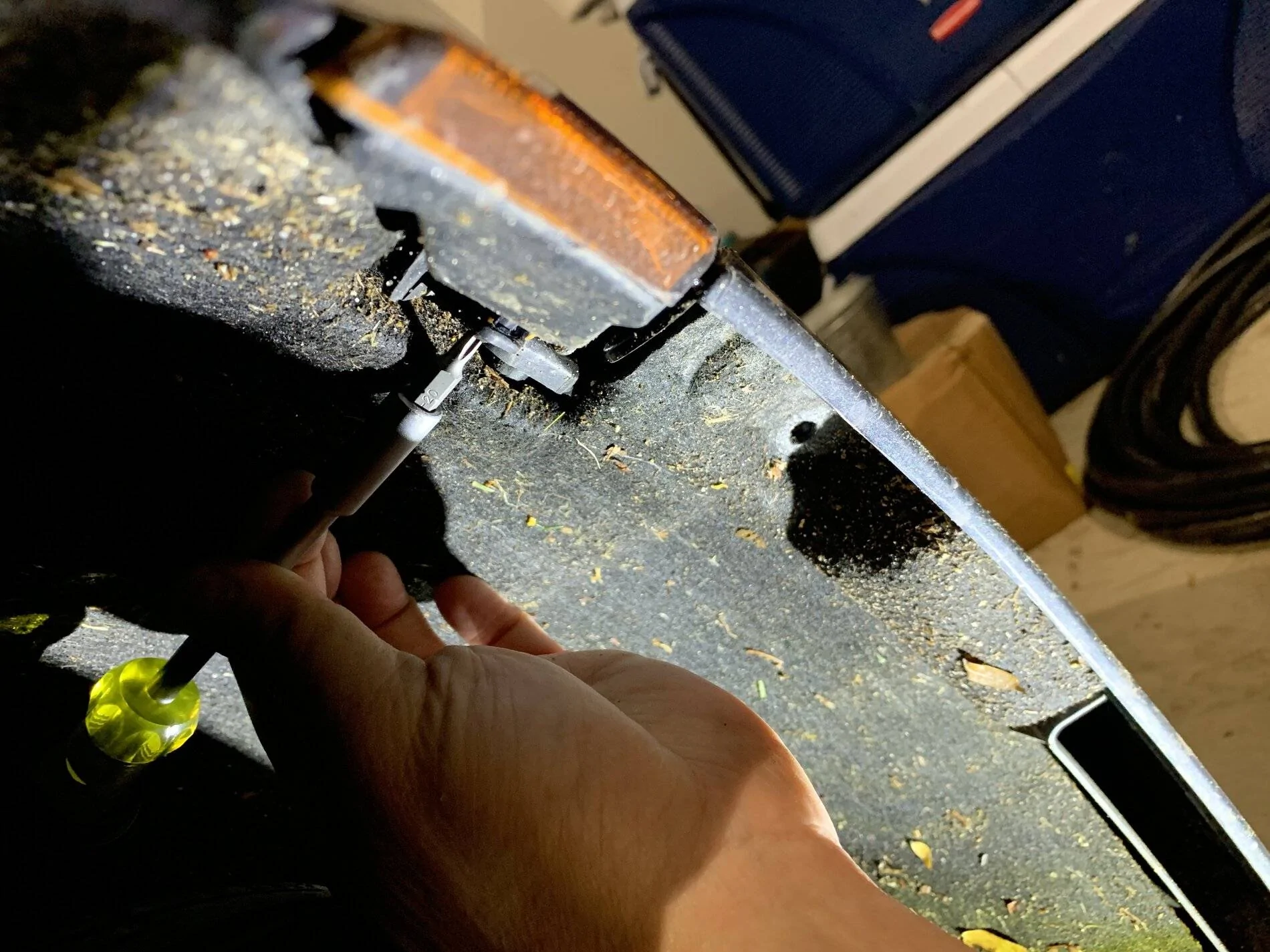

Ridiculously easy to do this. Literally one screw.
My originals did not have the clip (that needs to be removed and crazy glued back on) so I didn't need to do anything to the new lights. There was some stuck on foam on the top edge on both sides. I peeled that off and stuck on the new ones but i am sure they are not needed.

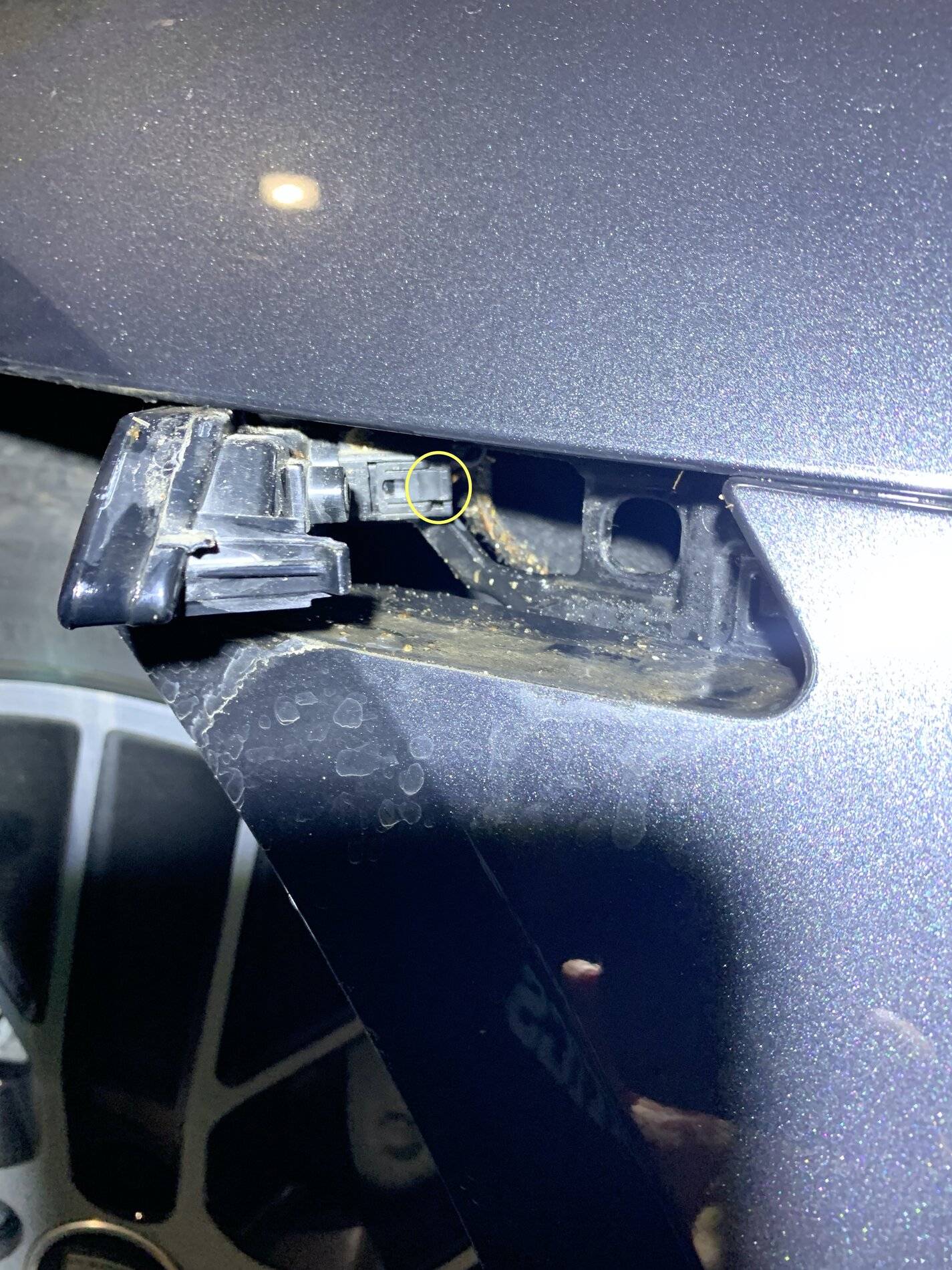

A few items from the nice step by step from the other page to make it more obvious. To pull out look at the new one and see how there is a latch at the front end, by tilting out the light it makes it easier to disengage this latch.
The tab is easier if you then tilt lens in the other direction. It is circled in yellow and just needs to be pushed in and the light comes out easily. If you have taken the one screw out of the tire well, then you can use your other finger to hold other side as you press on it and pull gently out. A good idea is to mentally note how far the plug is in the original light before pulling since I was not sure how far the new light needed to go in.
Pre-scewing is key to make it easier to mount the new light when it is placed back in place. Be sure to re-engage the front tab as this may be why some people do not have flush light.. Literally 5 minutes per side, done. And it looks amazing...And yes it has been raining a lot and mud on the road on the way to my house. Will be cleaning the car next week!

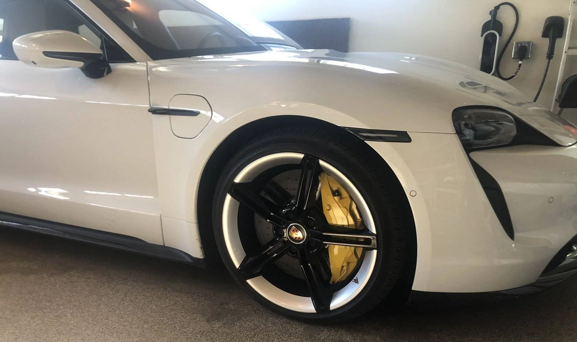

Not sure if we need more validation that this is an easy mod...but happy to have swapped mine out. Took me about 15 min.
Porsche Taycan Clear Side Markers 6531AB58-B49A-406B-840C-086F8F4BB8B4
