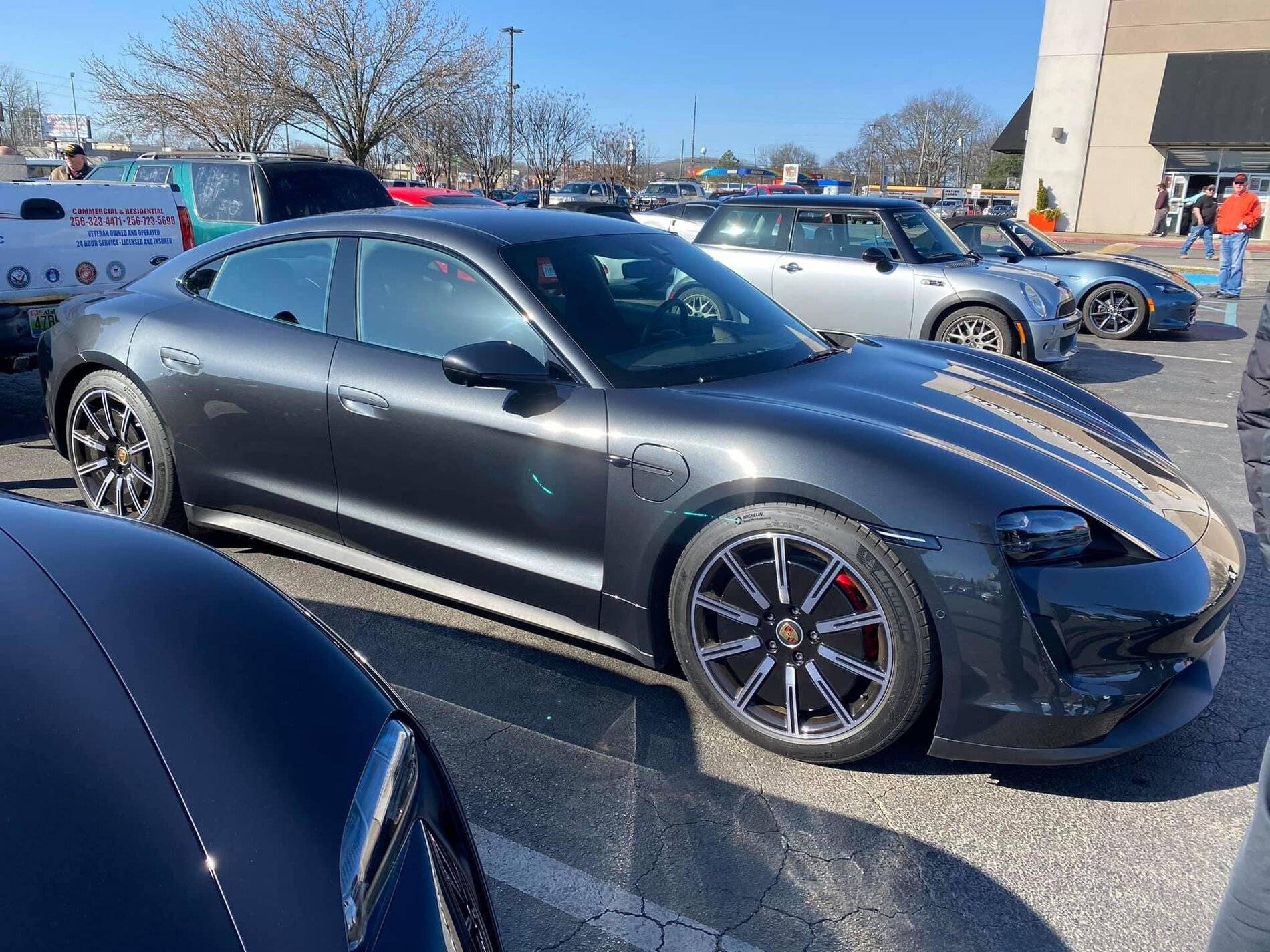

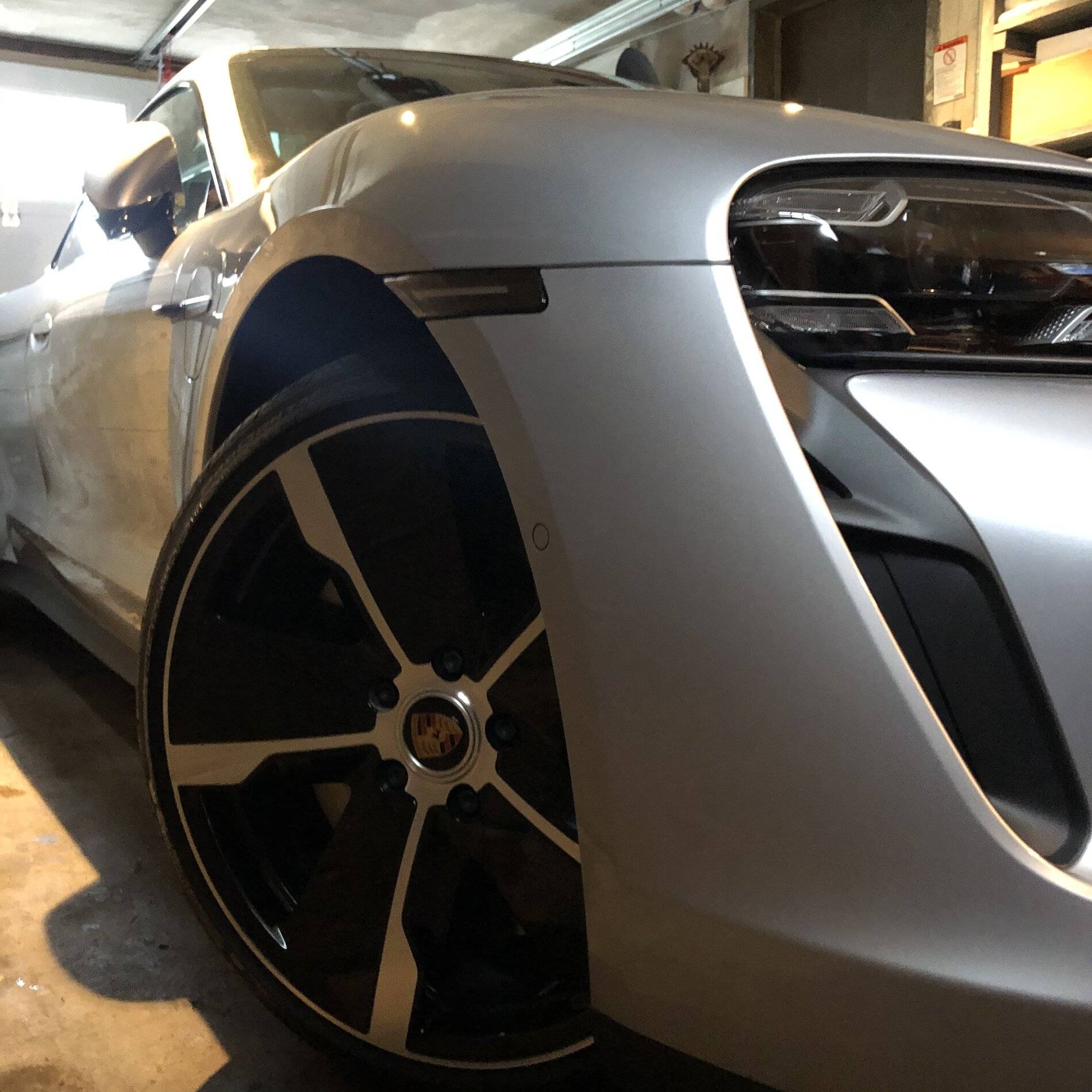

US models come standard with amber side markers. Any source for clear in US as in Europe? Or in London, UK area?
Porsche Taycan Clear Side Markers 8006C75E-8657-4ABF-BA53-1DE36B2F36D4

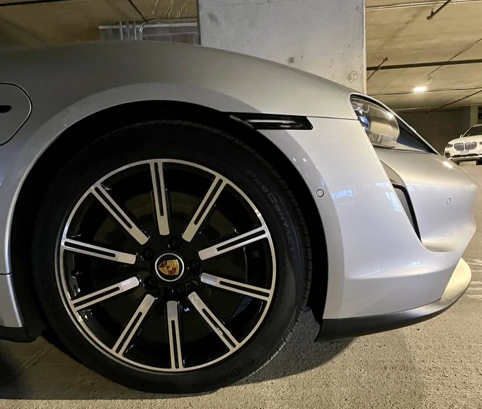

Finally!
Had the time and rainy weather to install the clear side markers. Thanks to all for the great instructions found in this thread, the job was quick and easy. A major improvement over the US stock.
The only color on the car, other than silver or black, now resides with the Porsche crest!

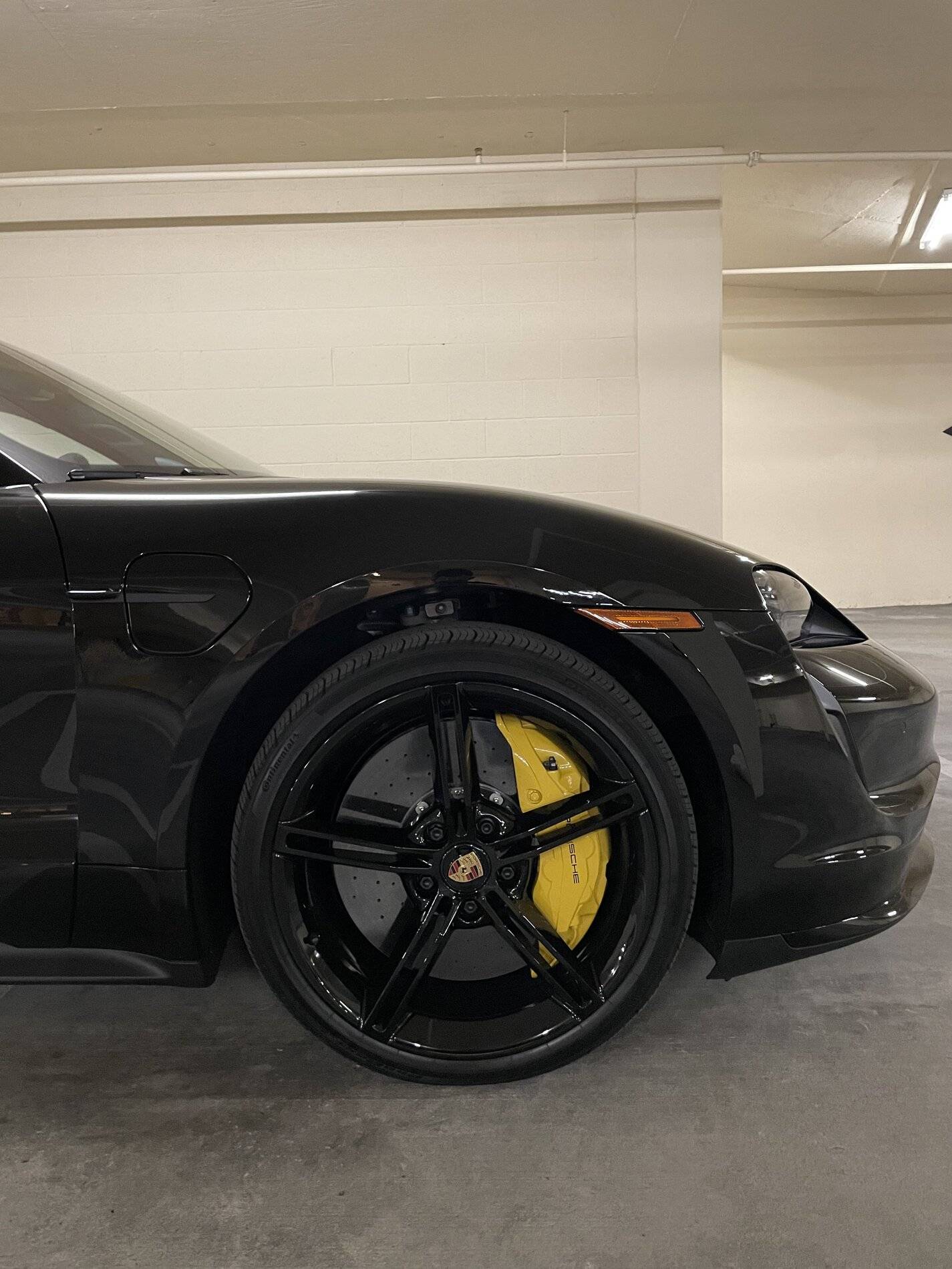

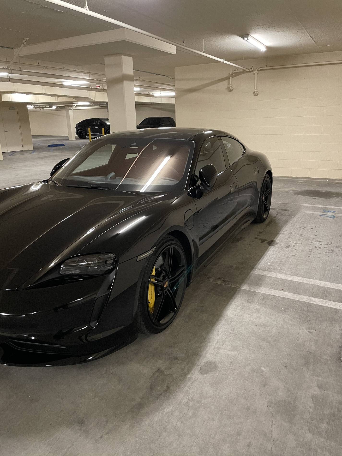

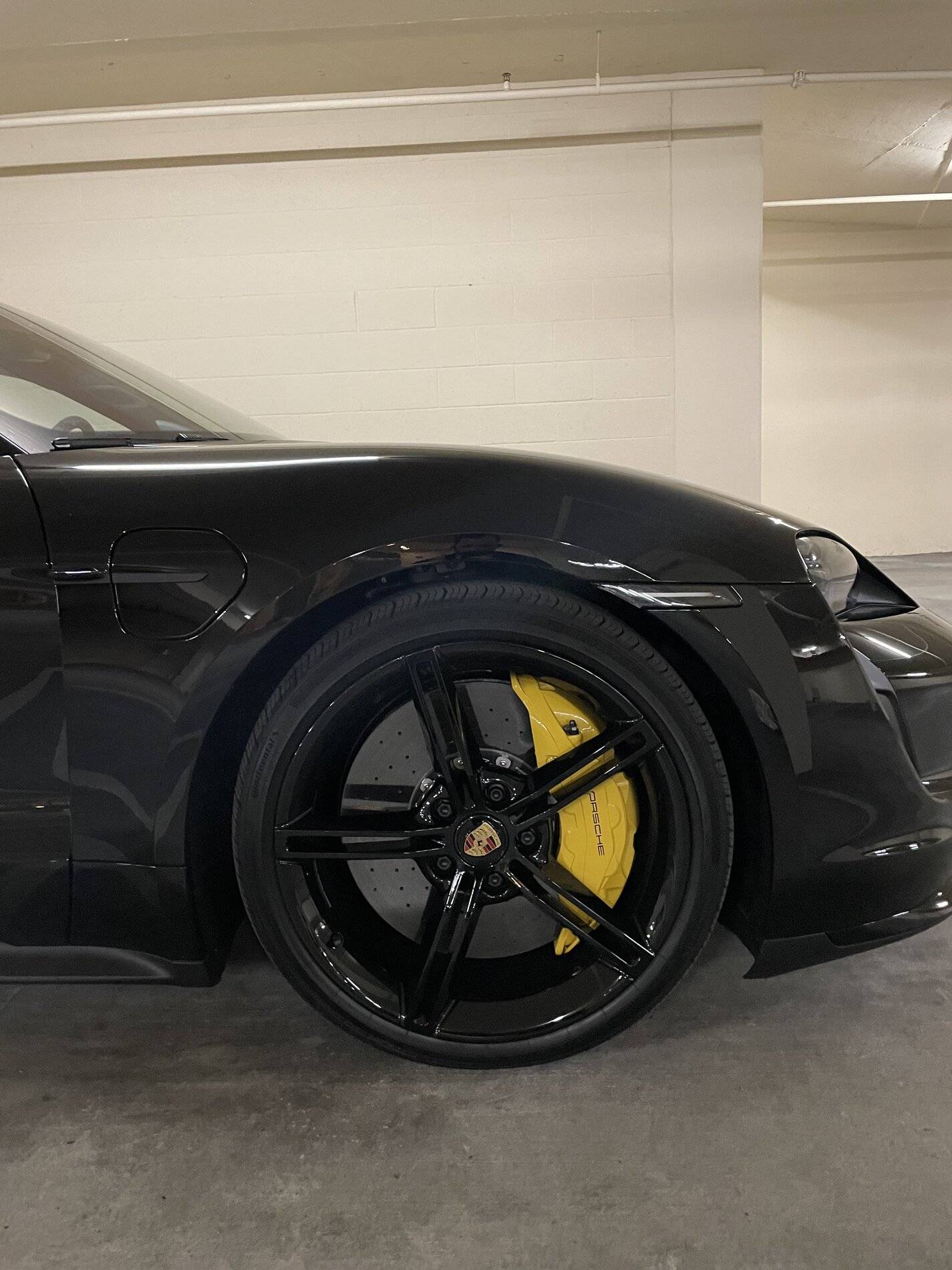

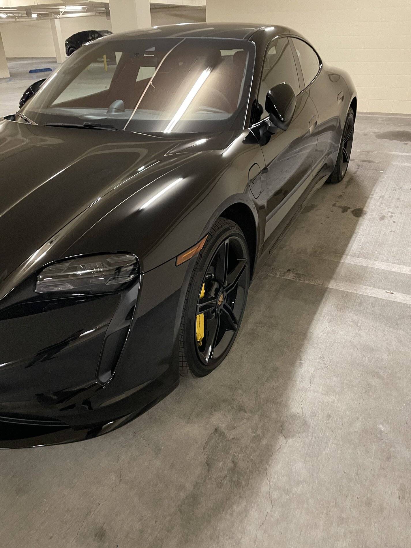

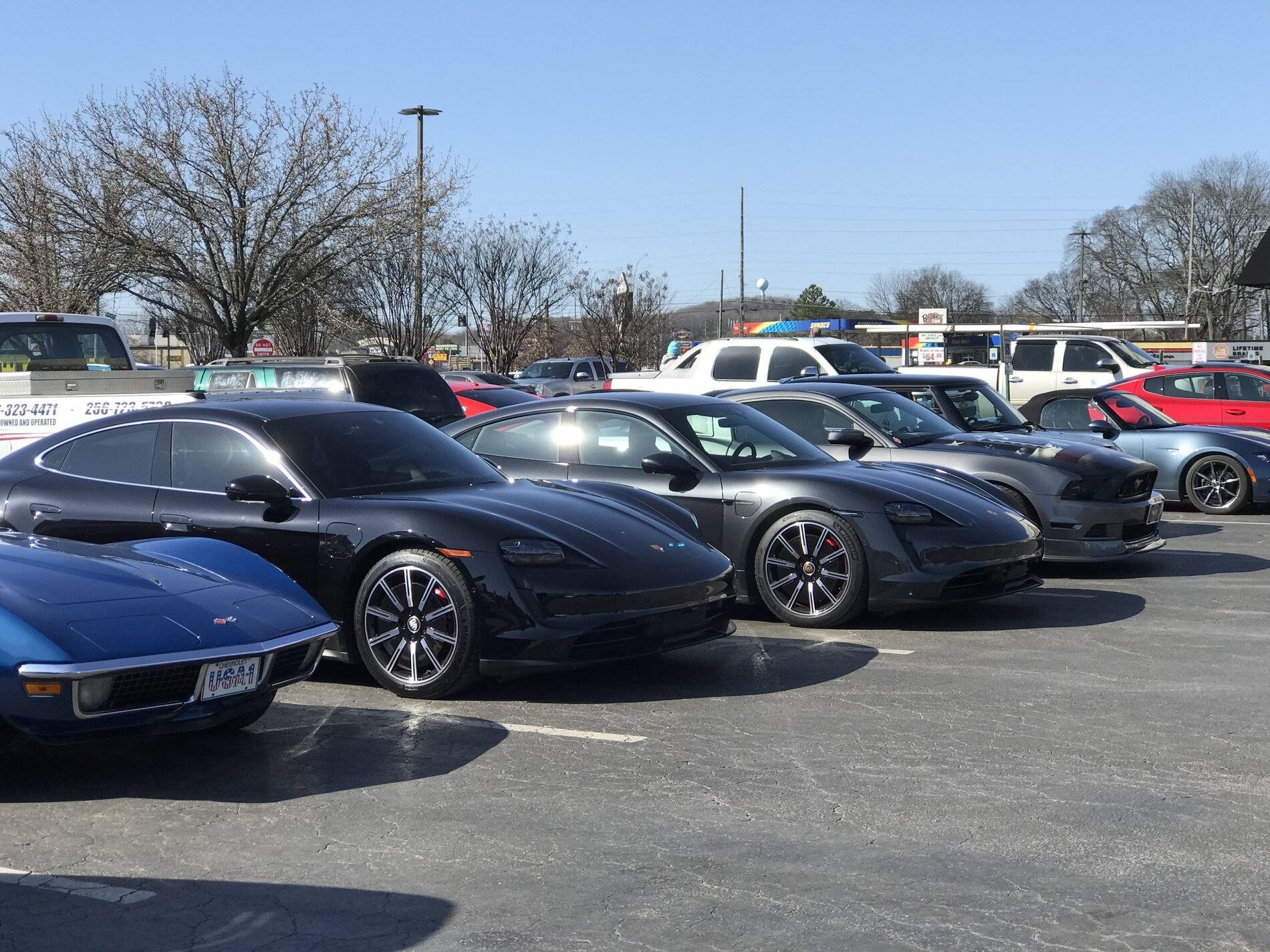

Just installed the clear side markers on my Black 2021 Taycan Turbo.
before & after photos below:
I could not find the bushing that everyone describes in their install. I completed it today on a 2021 4S and couldn't find the clip that everyone refers to. Did you see the clip and use it in your install? I wonder if it was removed from the markers for 2021. I looked everywhere. They seem tight and are just a bit larger than the old markers. Thoughts from anyone?

This is an absolute must IMO, but a minor correction - the side/rear reflectors are still red!!:oops:
There is a thread for replacing these as well, and I thought about it, but probably not - it's somewhat of a safety issue...
