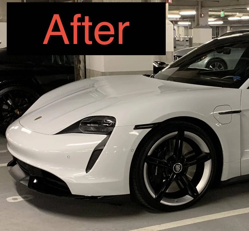

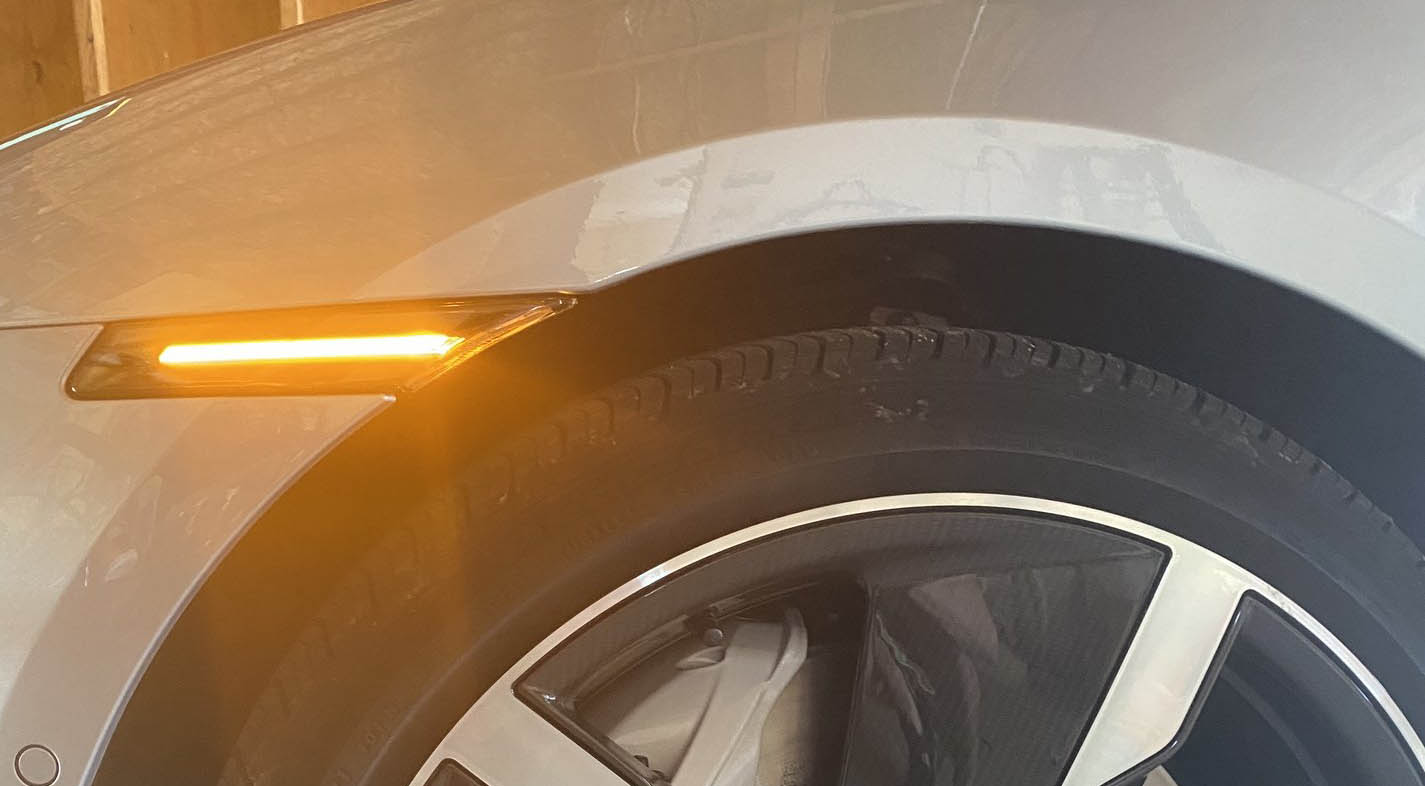

I had the dealer do the install on the clear markers. One question, on the upper trailing edge of each marker they stick out past the fender 1/8" to 3/16". I would have expected flush and have not been able to compare to original installed markers. What are other's experience?
Update: had the dealer take a re-look. They adjusted them and now nearly flush. Much improved.

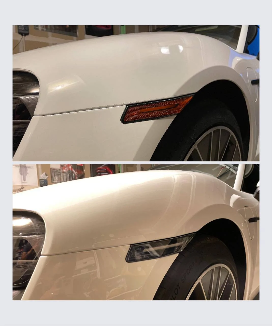

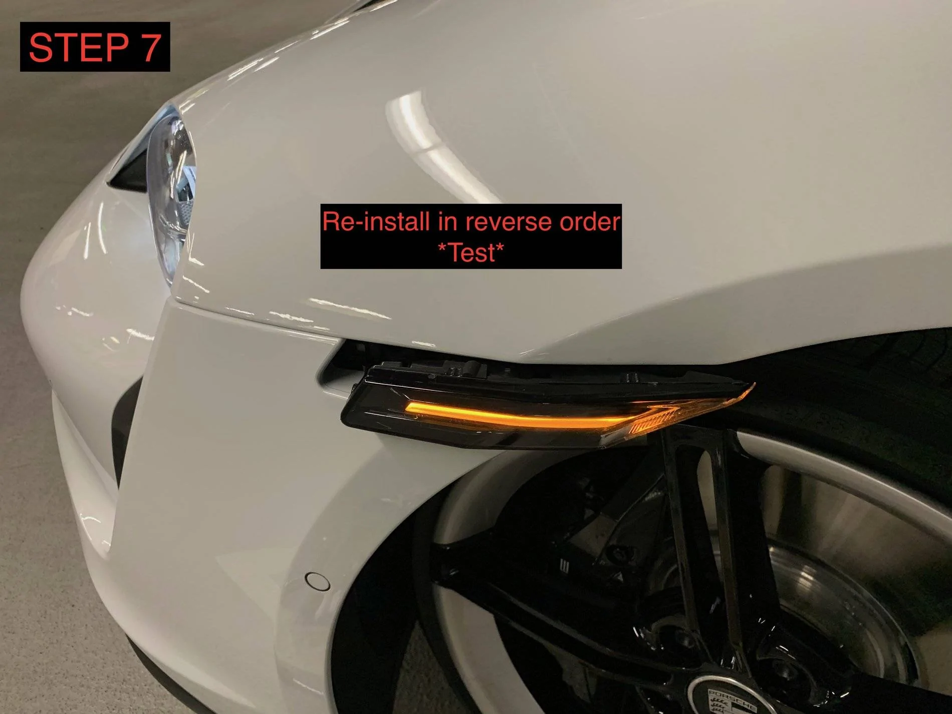

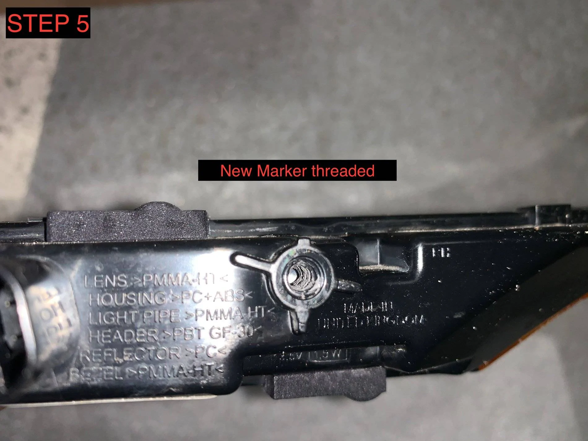

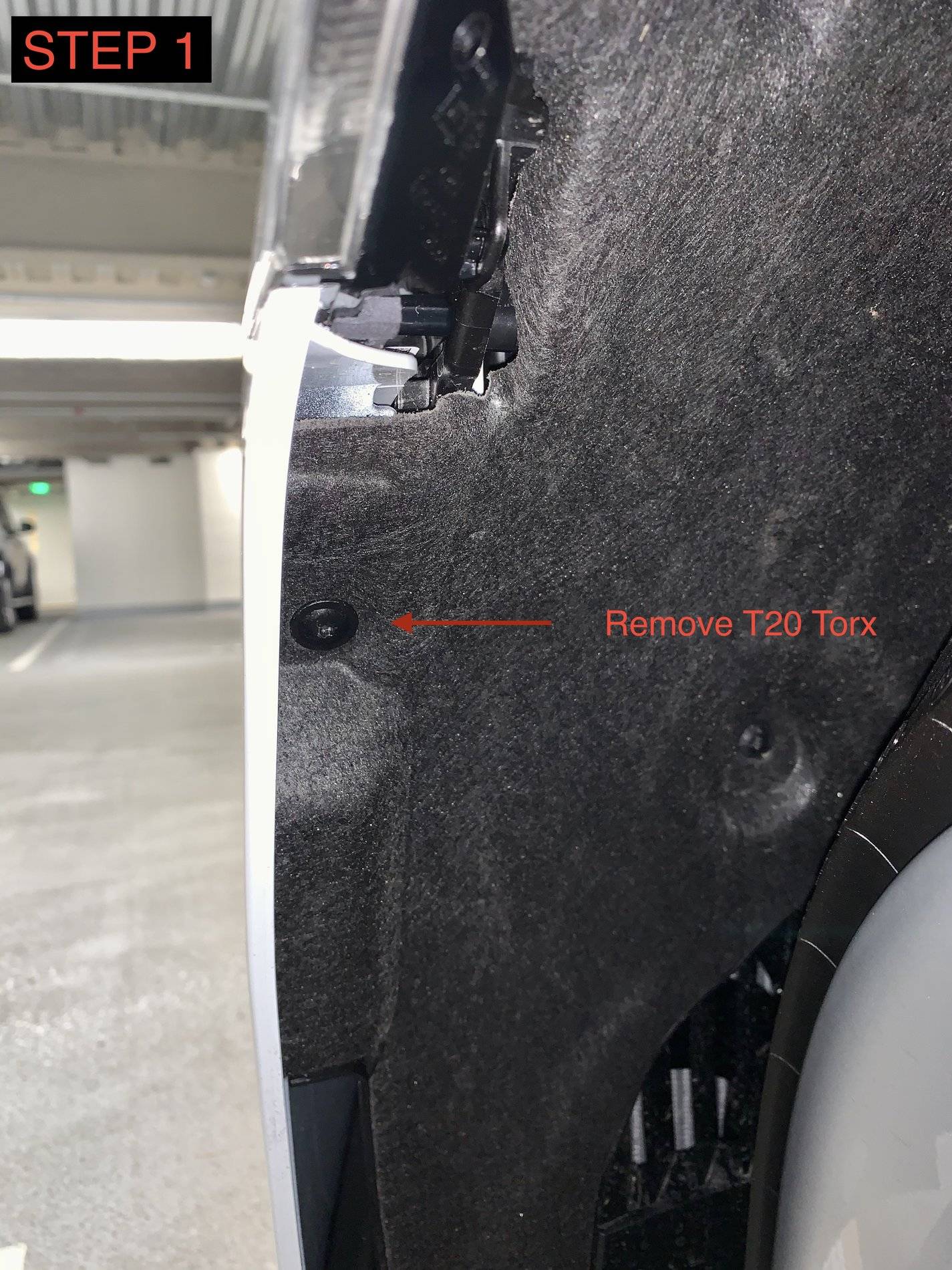

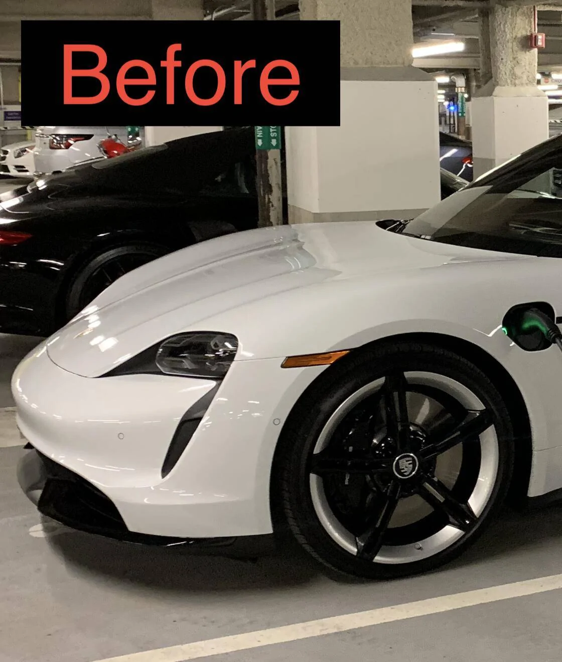

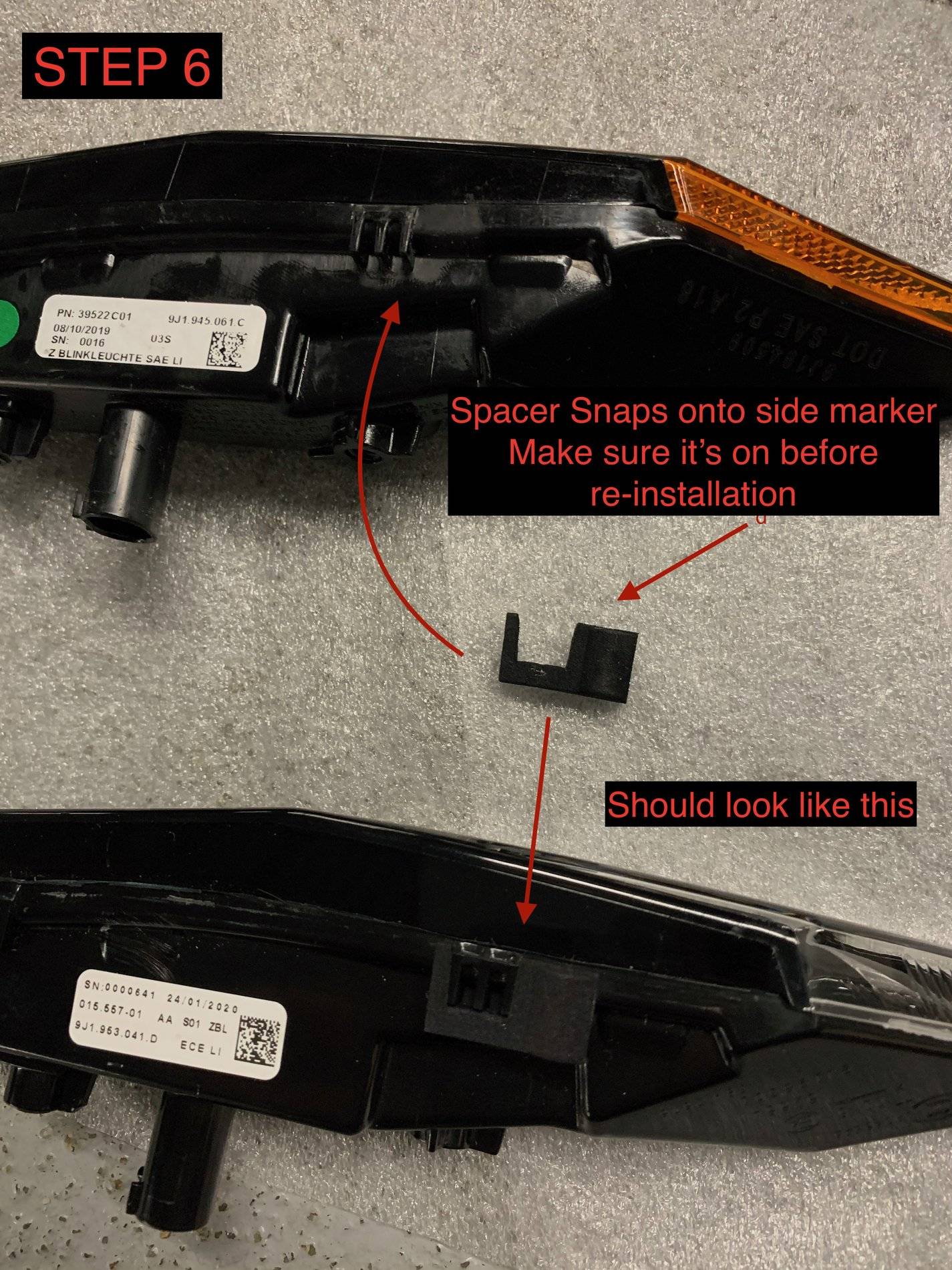

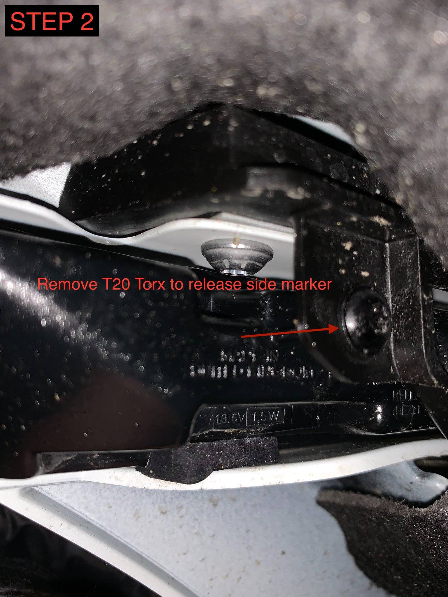

DIY: Replace Amber US DOT Side Marker with Clear LED Euro Side Marker.
Required Parts:
1) OEM Porsche Part: 9J1-953-042-D
2) OEM Porsche Part: 9J1-953-041-D
Required Tools:
1) Torx T20
Procedure: 5-10 minutes
Step 1:
1) Turn Wheel for more space.
2) Remove (1x) One Inner Fender screw for access.
Step 2:
1) Remove Screw holding Side Marker with Torx T20 driver.

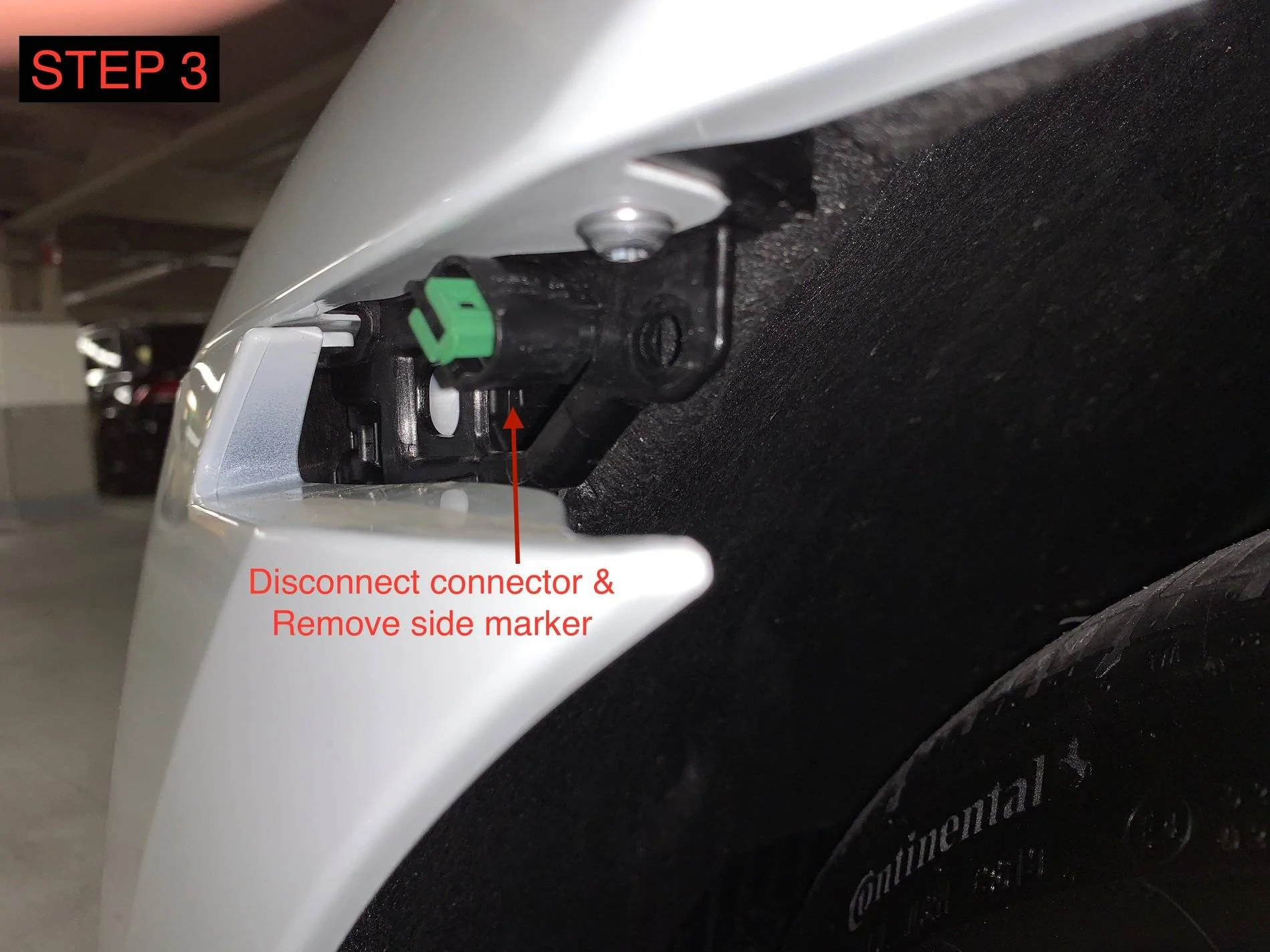

Step 3:
1) Disconnect power cable by pinching connector with your hand.

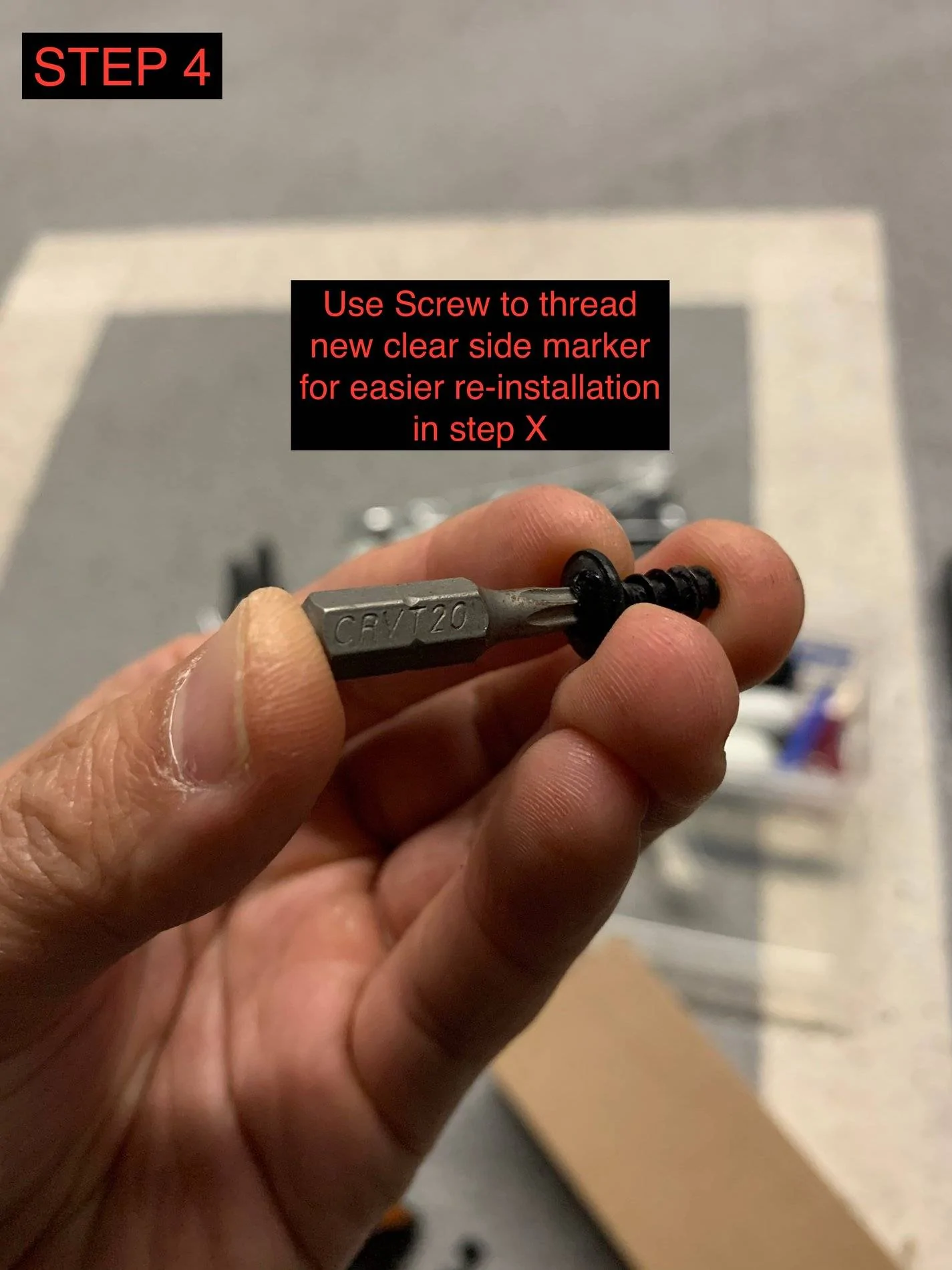

Step 4:
1) Using screw, thread new side marker with T20 driver.
Step 6:
1) Check all rubber bushings are attached and fixed on side marker; the bushings clip onto the side marker.
Step 7:
1) Re-Install in reverse order.
*Test connections before tightening screws.
DONE!
*Enjoy!

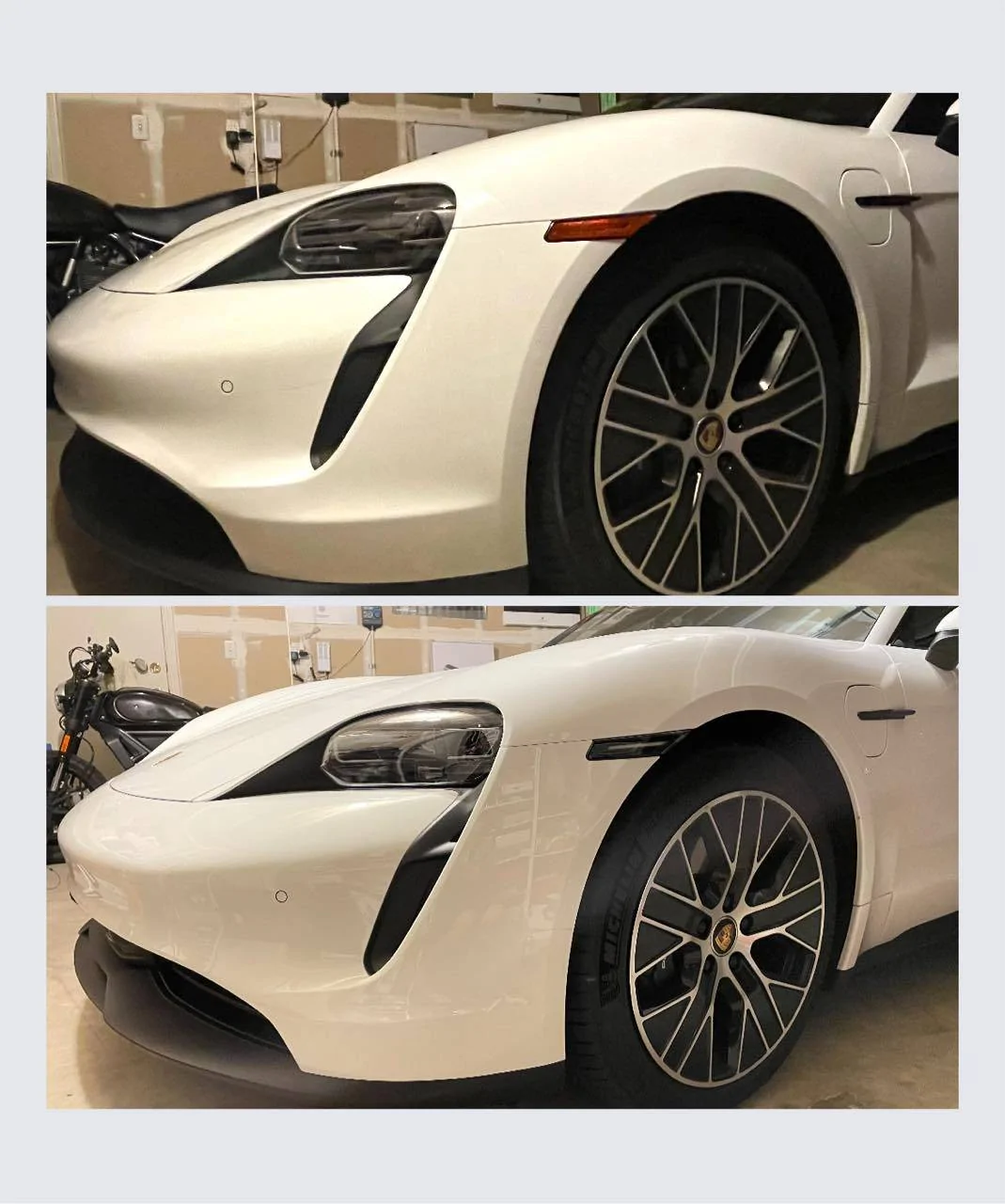

I just did mine, super easy! It's literally one screw and I didn't need to mess with the spacers either. DOT sure has the supreme ability to make everything it touches f-ugly and now we have to spend the extra $150 to switch it back. Thanks, DOT.

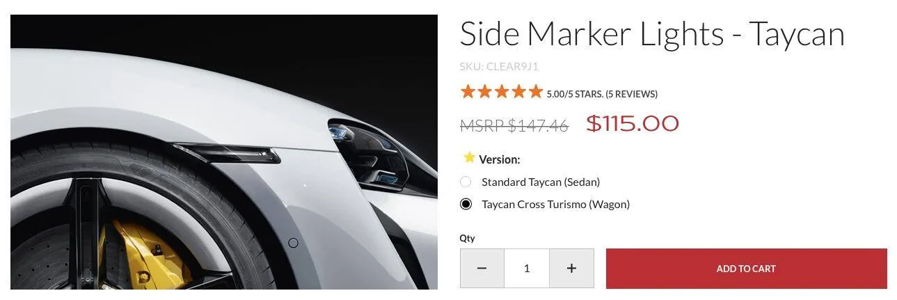

Not sure where you are ordering these from but they are $115 at Suncoast right now and you select the toggle for the Sedan or Cross Turismo (triple checked with Charles at Suncoast that they have the correct part): same no. but -B for CT.

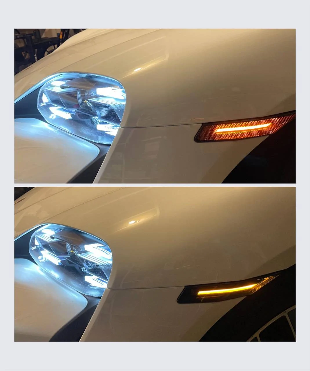

Do these still have an amber reflector? Anyone have a pic with light shining on them?
XLR82XS
LXA
Mar 31, 2021
1,984
1,372
SW FL | Vegas
Reactions: CxM
XLR82XS
LXA
Mar 31, 2021
1,984
1,372
SW FL | Vegas
Both. EU spec do not have a reflector housing.

I've been trying to follow the instructions here, but the screws holding the side markers in are SUPER tightly screwed in on my car. It's to the point where I feel like i'm stripping the screw. I'm starting to wonder whether I'm looking at the wrong screw, but comparing the location with where it goes on the replacement part it seems right.
Did anybody else experience this?
I might have to take it to the dealer after all... did anybody have a dealer do it and could give me an indication of what I'm likely to expect in terms of duration and cost? Is this something they just fit into their schedule quickly?

To confirm, are you using the Torx wrench? And, are you using the correct size? To my memory, both bolts were T20.
fullmetalbaal
May 23, 2021
421
505
Seattle
T20. I was using it on a screwdriver style handle, making it hard to keep a straight angle. Will try a ratchet later today
