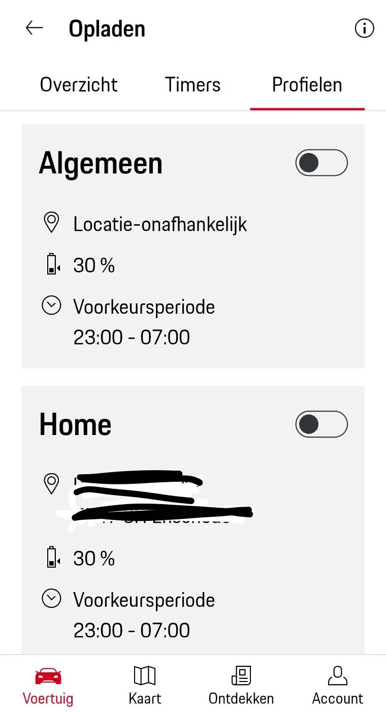

A lot
(note that you can't edit profiles but most of the other functions are available and have been added to).
You can.
Only not in the app.
You have to do it in the MyPorsche web portal.
You can (de)activate them in the app though.
