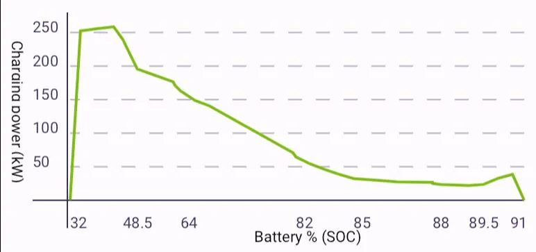

Just discovered a neat way to get a record of the charge curve mapped...
The Kempower chargers at Osprey, produce a QR code on screen for your session. Once the session is complete take a photo of the screen on your phone or directly open the QR code - this takes you to the kempower.io website with the basic stats of your charge session with a large battery graphic.
If you click on the battery icon on that page it will open up another page with the charge curve for the entire session mapped against the SoC. You can place your finger anywhere along the curve to get the power output and SoC numbers at any point along the curve.
Very neat!

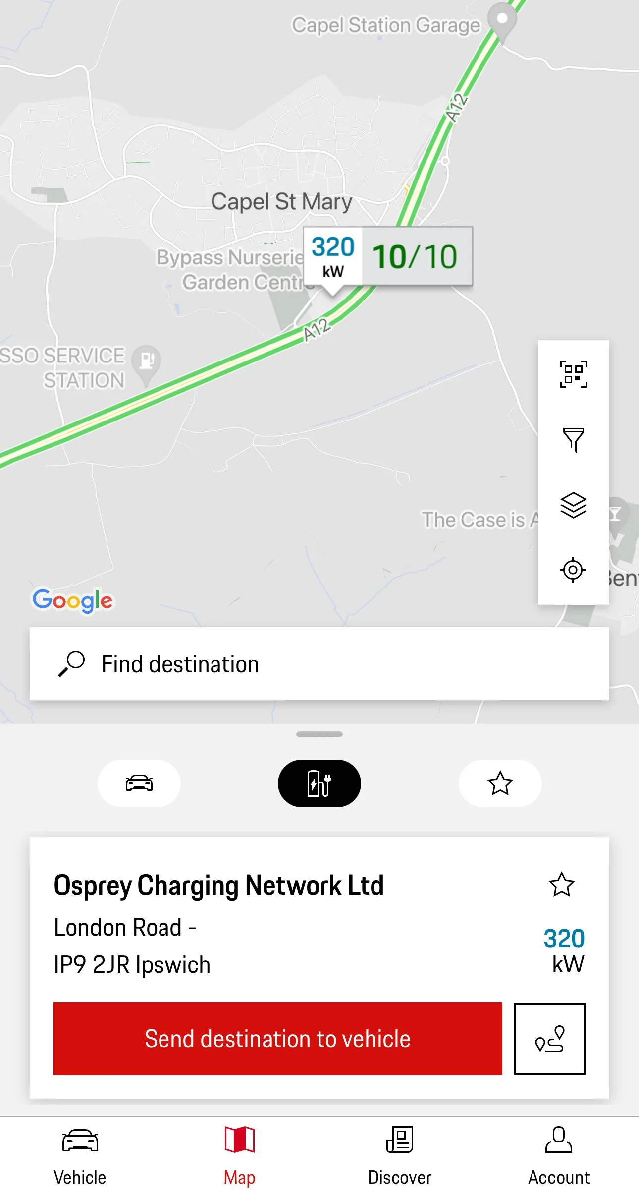

Now just to find a suitable way to discern the 400V Kempower sites from the better 800V Kempower sites that Osprey install. Unfortunately a lot of them are mis-represented in the Porsche App (and even in Opsrey's own app).....like the one below which is actually a 6 bay 400v / 150 kW site and not a 10 bay 320 kW site!! ?

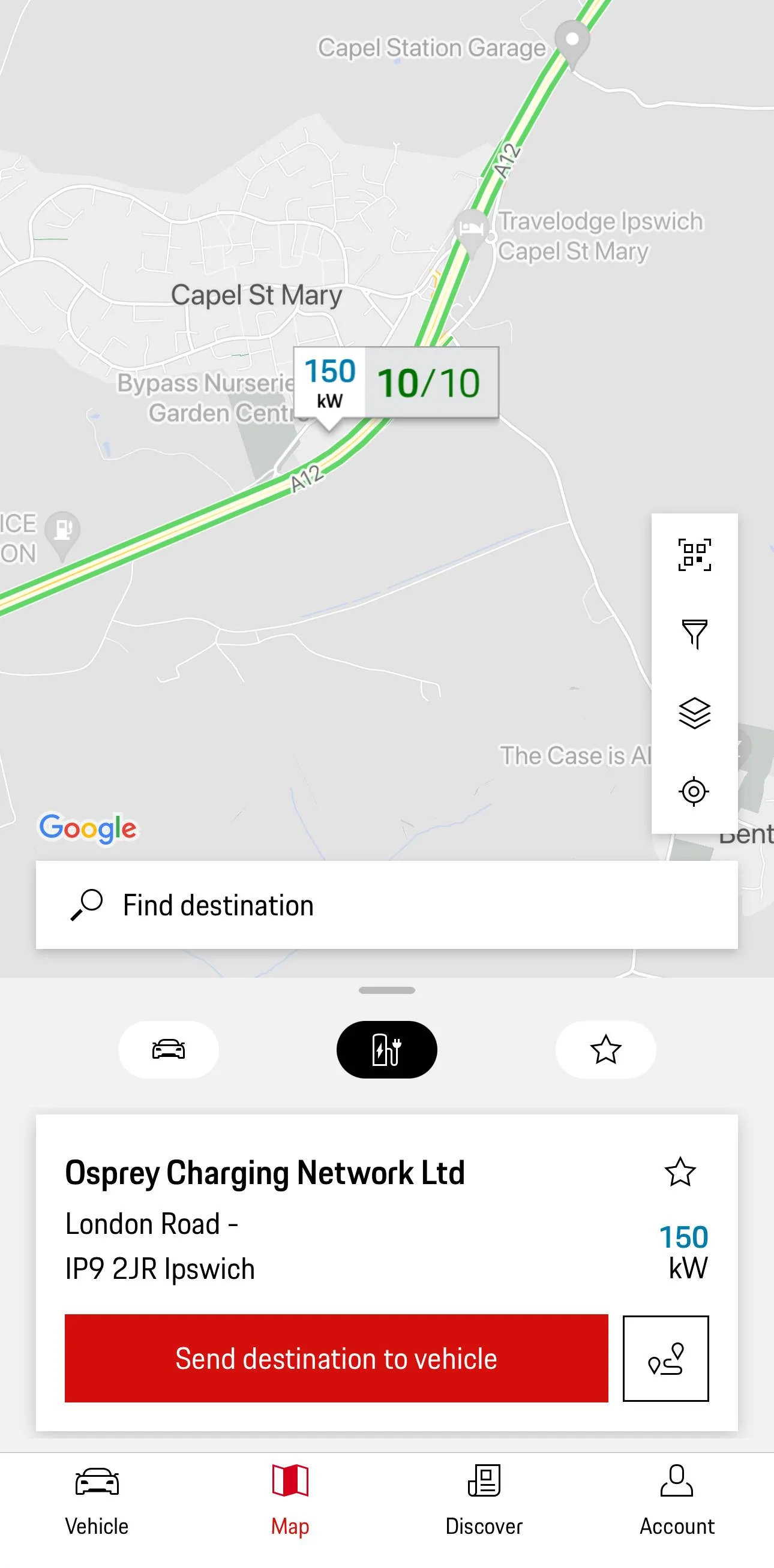

Weird so I just noticed that the Osprey site near Capel St Mary has changed its description on the Porsche app to accurately reflect its true CCS2 power output - 150 kW.
As I charged there on Sunday, I'm wondering if something got feed back through the Porsche network? Who knows anyway at least its now listing the right power, but still the wrong number of bays - its only 6.

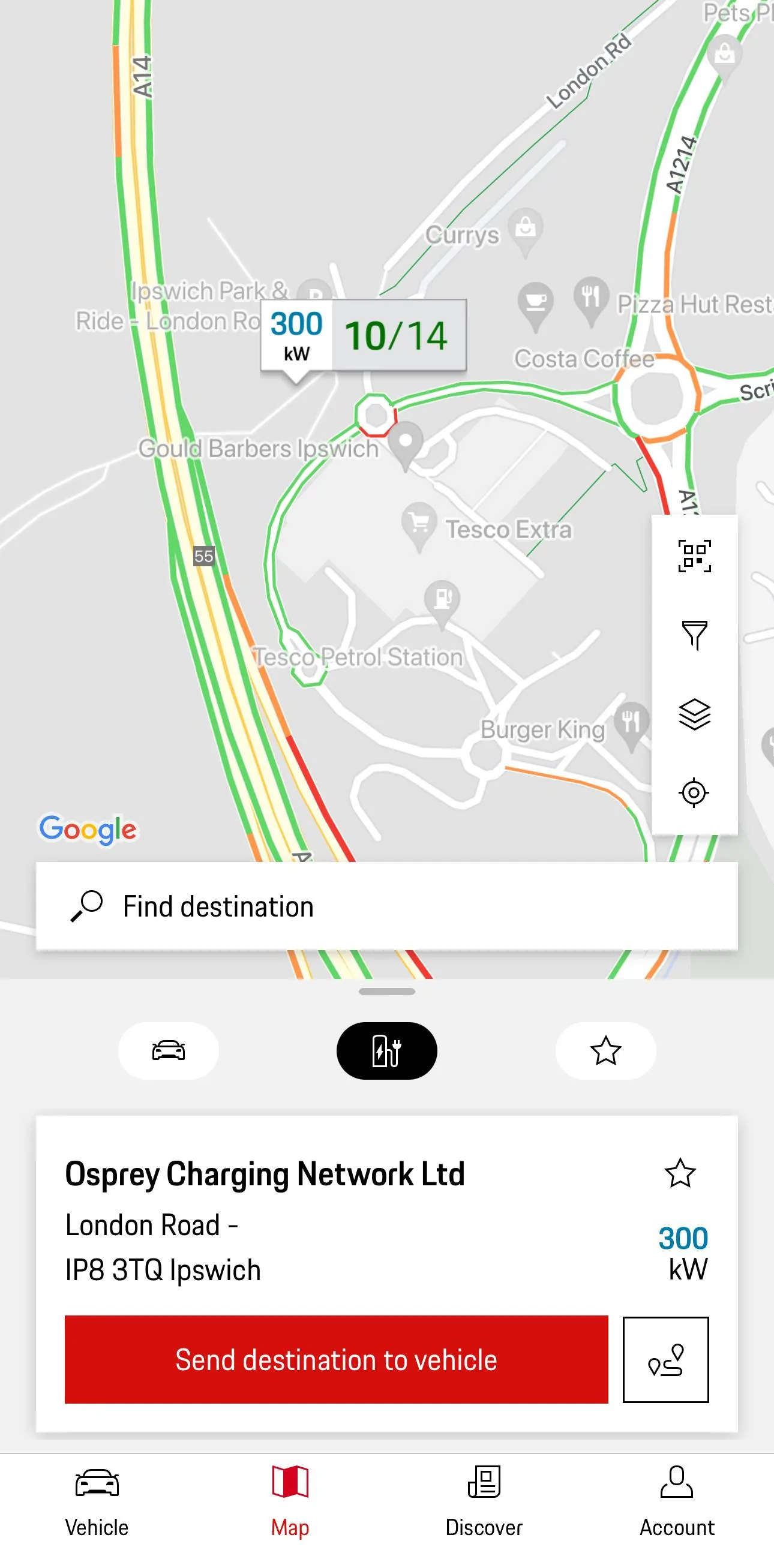

Meanwhile the site barely 4 miles upon the road at the Ipswich P&R is still showing 300 kW. It's definitely a 150 kW only site. Maybe I need to take the Taycan there to charge and correct it!! ?
[It also doesn't have 14 bays there before you all get too excited. More like 6]
