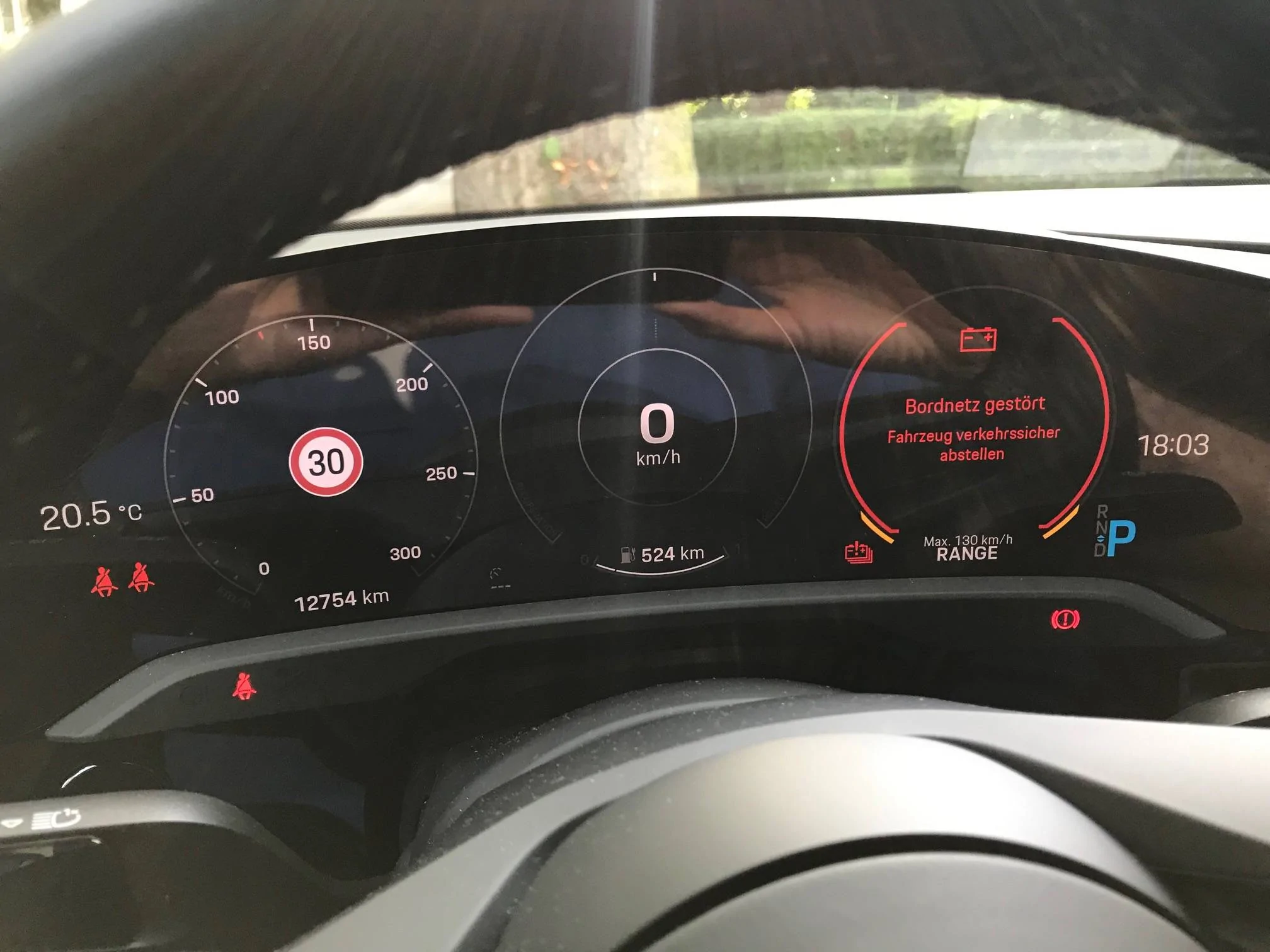

Taycan dead since 1st August. After driving the Taycan on Sunday I received on Monday the message "Bordnetzstoerung" (red). Taycan could not be moved; On/off, waiting etc. did not work. Taycan was lifted out of small parking lot and moved on the 3rd August to Porsche Service. Porsche headquarter advised to replace three cells. Will take a while, not repaired yet. Taycan 4s of 02/2020 was driven carefully; very few high power charges; always 70-80% charging state when not used. Average energy consumption since delivery: 17.7 kWh / 100 Km.
Over the last two and half years the "Taycan and I" spent about two weeks at dealers for software and hardware issues that occurred while driving (electric motor stopped), after moving out of parking garage or because of updates.
Taycan is still at Porsche service since 3rd August, today: 26th August...
