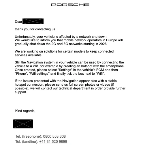

I now have experienced this navigation issue, so I mailed Porsche connect Switzerland.
Here is their reply.
There is also a web page on this issue:
https://ask.porsche.com/ch/en-CH/2g-3g-network-shutdown/
I did not yet try the proposed phone hotspot fix, although that's a poor solution.
I hope they can get a software fix or a SIM swap made asap, as I'm paying for Porsche Connect, and I would like to use navigation and charge planning occasionally....
It’s not related to the lack of 2g/3g 🤣
I am getting it while having full LTE connection, with music playing just fine.
This issue is 8 months old at this point; and they still pretend
They will probably waste your time 2-3 more months before going: “ah, you are one of 2 people in the whole world with this issue, but rest assured we are working on it”
Btw, navigation is supposed to work while offline as per porsche manual 🤣

Puzzling given the reply from Porsche and the advisory webpage.
Swisscom, SALT, Sunrise, Yallo, Galaxus Mobile etc all discontinued 3G as of end 2025.
Which Swiss service are you using in your 2020 Taycan with its installed 3G connection? 😂
There may be some 3G cellular connections remaining but not for much longer.
BTW, it seems in my car that the charge planner and traffic advisory are live functions not offline, the turn by turn HUD map also seems live.....
Pleased to hear any rational alternative solutions, in short I'd just like my navigation back
LTE is a 4G technology. Taycans use LTE in switzerland, and always have.
The reply from porsche is standard deflecting, and the advisory webpage, while true, it's unrelated and with close to 0 impact for taycans, as they are capable of LTE/4G connections, and have used that since 2019.
Unless your taycan is a old Cayenne cosplaying, which does not have 4g support , it would have close to 0 impact for you, especially within switzerland, which has close to 100% coverge - with Swisscom claiming 99% 5g coverage in switzerland, and others claiming 99% 4g and above 90% of 5g.
The issue is completely unrelated to connectivity. The naivgation is capable of planning a route with the already cached info while completely offline; it will of course not account for occupancy at chargers or such while completely offline, but it can create a route no problem.
As a temporary solution, you can put your car in privacy mode, and then reset it to default settings, which will delete all of your settings. Then you can put it back online, and functionality will return to your navigaton for a while.
Or you can turn off charging planner, and your turn by turn navigation should work fine, but you will have to plan your routes in smaller steps by yourself, navigating to each charger one at a time.

I had the 3g issue @Argo. A service visit to your Porsche Center is needed. They fixed mine by reapplying the PCM update. They said this issue is related to the navigation issues. Probably the communication module is corrupted.
