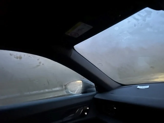

So what are the symptoms?
- random fog ups? Or is this still considered a feature rather than a failure?
- no blower, or just cold blower?
Could I just put my heater on 30c and see if the gets really warm?
For me, no heat but also no air at all out of the vents - it happened gradually and sporadically at first so i thought it was to do with the fact the battery was cold etc but then came the total misting up of all windows to the point i couldn't drive the car. (see photo - that was whilst trying to get it home). Also absolutely freezing. BUT the seat & steering wheel heating was a dream!
