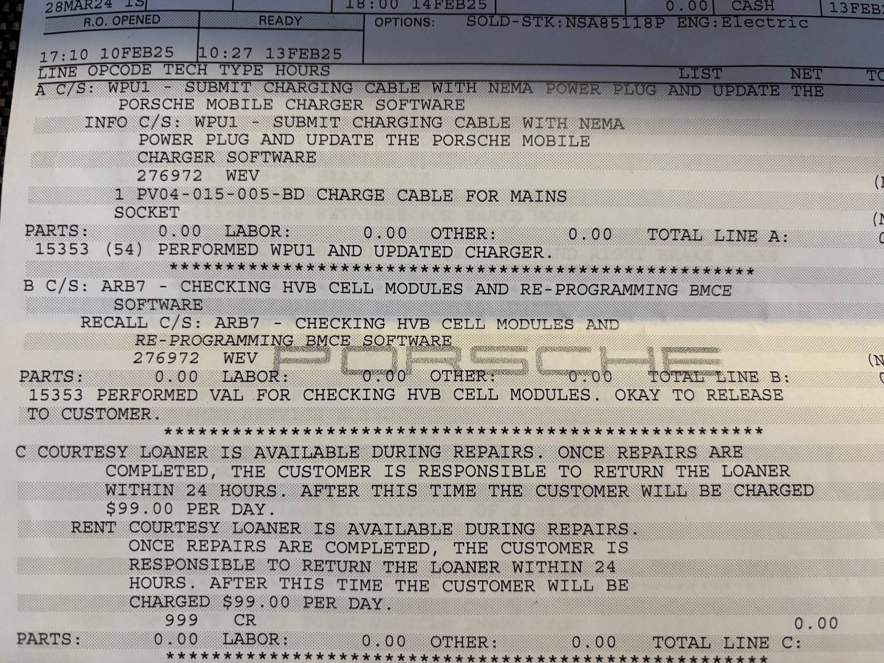

Looks like the dealer was able to do the ARB7 recall on my car, finally completed!!
No issues found but the tech said they send everything to Porsche for final diagnostics.
Mine is in right now for the same thing. So, that means you're able to charge as you please?

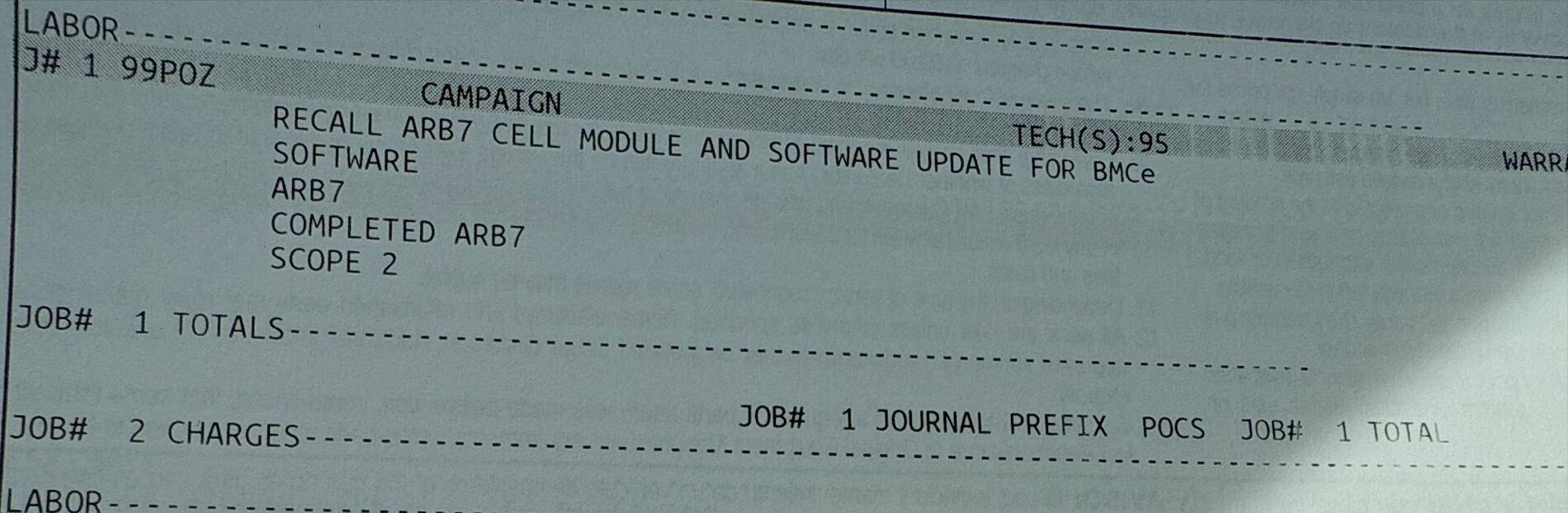

My car also has ARB7 done, and has had it done since December. The key is, they marked ARB7 done, but the actual action item, with a different code, is not done - aka the actual software.

I am not seeing any evidence from the last few posts that BMCe software actually being updated. The expectation is to receive a letter that states that ARB7 recall now has a remedy which is BMCe software update instructing us to schedule BMCe software update. We have not seen this kind of letter yet since the only thing we know that it may be available by the end of Q1 of 2025.

No TSBs from Porsche or Audi describing instructions for installing diagnostic software for ARB6/ARB7 and related Audi campaigns have been posted on NHTSA.
Either TSBs have been issued and not posted, or US service work descriptions indicating BMC software has been installed are incorrect.
